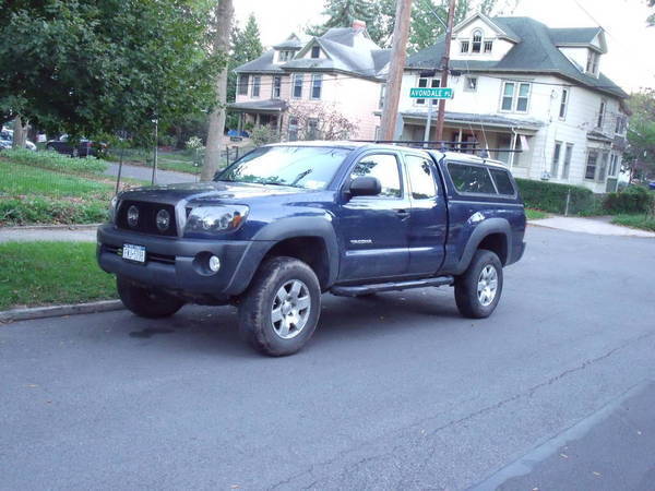

    Bought my 2007 Access Cab SR5 4x4 used with 55k miles in Feb. 2010.
    The idea behind my build is that I am planning to spend at least 8 months on the road in the near future whitewater kayaking across the country and I want a rig that: can move all my gear, I can camp out of and sleep in comfortably, is great for long hauls, is affordable and works for the paddling lifestyle (not too tall and still gets good MPG).
    Most of the stuff I am running I am buying used or on the cheap to keep the project affordable. Also I am trying to stay away from anything flashy or easily removed, where I live at school I am on the other side of a park (1 block) from the ghetto. Last thing I need is someone trying to rip off stuff from my truck.
    This is the first vehicle of my own that I have ever done work on so this has been an adventure to say the least.

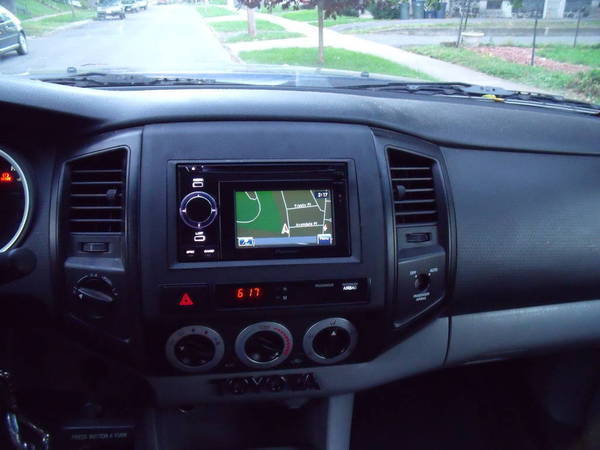

    Blue “Fighter Pilot Lighting” in foot-wells (front and rear) and cup holders- trick to these is to use prewired 12v WIDE ANGLE LEDs available in bundles of 20 for $8 on Ebay.
    Installed Carling Contura switches into the OEM slots with some modifications and illuminated them to run the above and more to come.
    Full LED swap on all the stock LEDs in the cab to a blue/white theme. This includes the gauges, head unit, display by the clock, and the climate controls.
    Map lights on with Dome light- still might go back and make this work better so that this only happens with the “Door” mode instead of all the time.

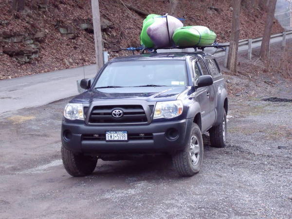

    Cool. I think you need some more canoes on there though.
  5. Mar 24, 2010 at 3:59 PM

    Actually more would have been a disaster. My kayak stackers blew out on the way back from WV, and there was nothing but the straps and friction holding that rig together for 400+ miles of highway driving.
