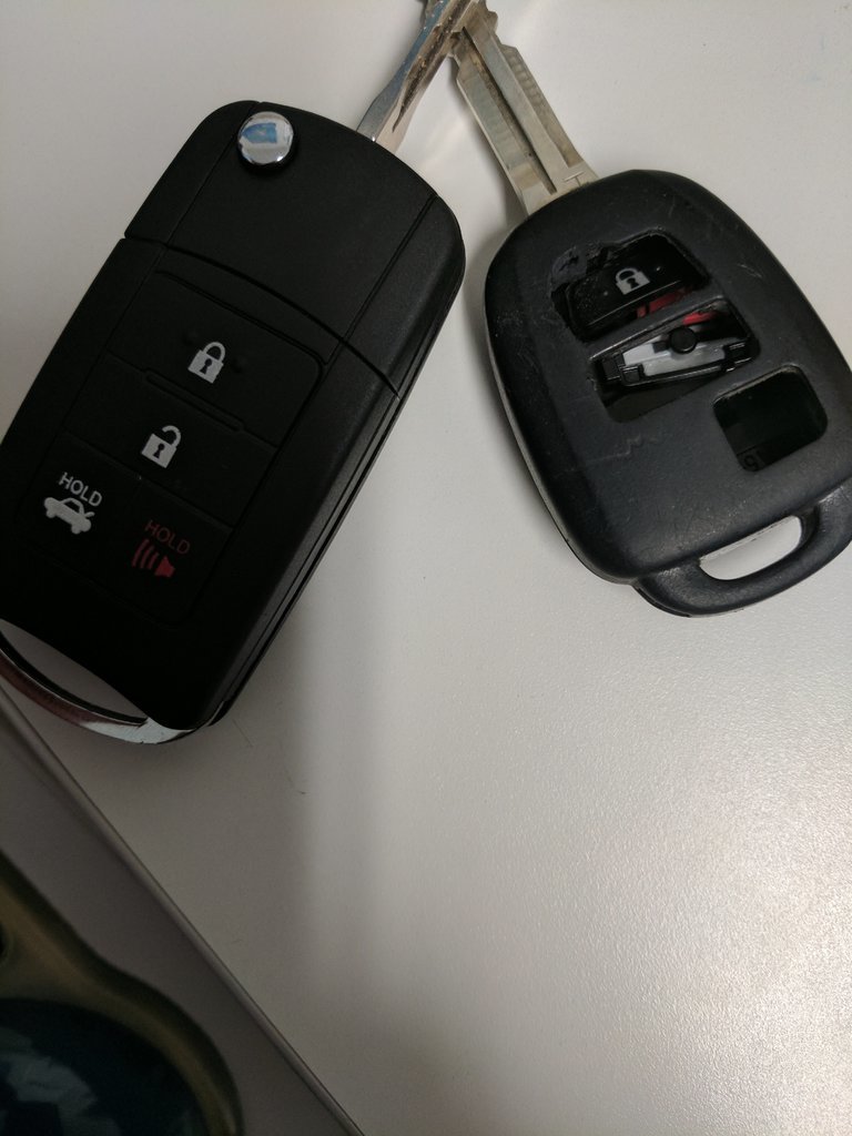

    I just did mine and the transponder is a pita. Take an xacto blade and heat it up. Used a dremel with cone sander. Took about 30 mins. IMG_20170818_124400.jpg

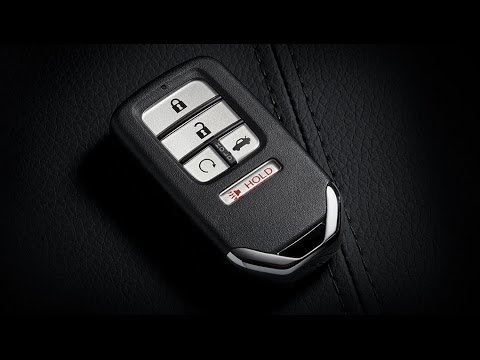

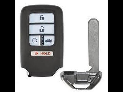

    My new remote. Could not believe the difference in weight between my SR5 remote/key and this.

    Yeah it has a key in it. I take the key out and leave the remote in my V with the engine running then lock my door with the key while I make quick stops in town.

    Yeah I know. I had a SR5, 4 popper till last month. It is still sitting on the lot for sale. I traded for a 2018 Honda CR-V, EX and the above smart key is for it.
