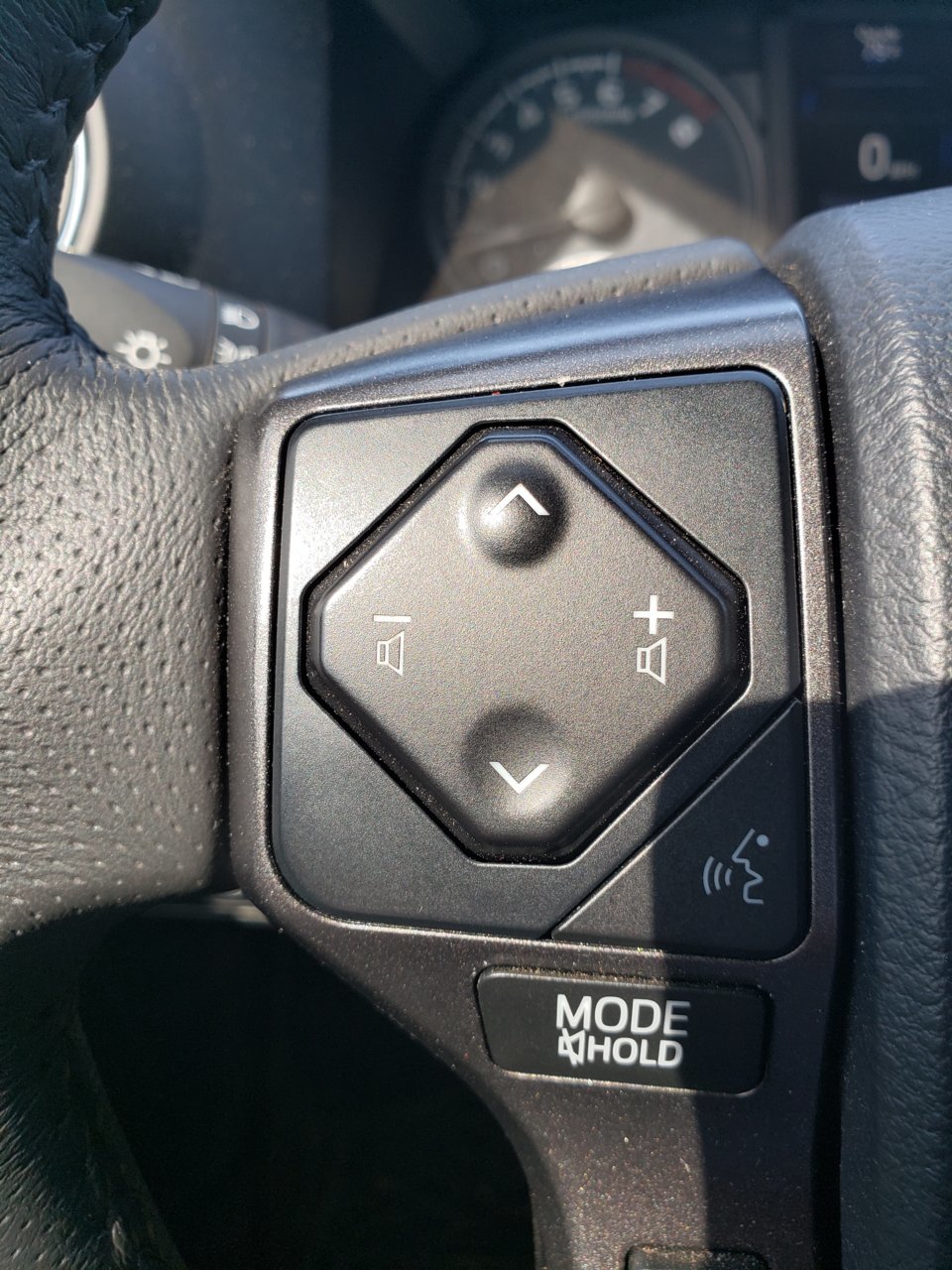

    This toggle drives me nuts! It's counter intuitive. Is there an easy way for me to rotate the toggle so volume is up and down, and track fwd/reverse is left to right? Looks like I might be able to rotate it 90 degrees since the sides are even. Any solutions? Is the steering wheel easy to take apart?

    Up and down will move the track up or down in your list. Right seems natural for me for volume up. Just my two cents

    Walkthrough of controls removal:
    https://www.tacomaworld.com/threads/2014-steering-wheel-control-install.362309/
    Ignore the parts where he takes apart the steering column and removes the wheel. All you need to do is release the airbag like in the DIY, don’t even need to unplug, just set on top of the wheel, obsviously all this on your own risk and after battery has been disconnected.
    You’ll then see like 4 Phillips screws holding controls on. Unscrew then unplug harness and pops off.
    Smaller Phillips are on the steering control casing. You’ll have to fully dissasemble to see if you can flip the individual button.
    Edit; does the volume button not control the vol or something? Flipping 90 degrees doesn’t make sense to me.

    Also it’s imposisble to change the actual input locations. So that volume+ spot will still be volume+ regardless of how you orient the plastic button. The buttons just mash a soldered circuit board underneath. The circuit board has fixed inputs that can’t simply be moved unless you are really good with tiny electronics and soldering circuit boards.

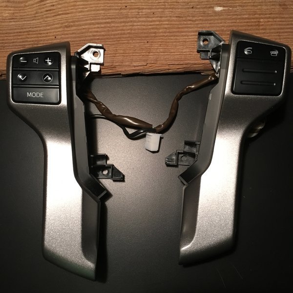

    The 2012-2013 controls were better imo. although I do like the volume button setup on the 4runner and 14-15 Tacoma’s.
    Not my pic.
