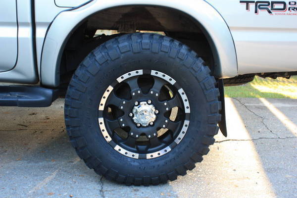

    Does anyone have any experience with flipping the bottom leaf spring to maximize lift? need another inch clearance (already have a 1" block) to create enough room for new 17" wheels with bfg mud-terrain ko 285/70 tires. Would adding a leaf be more practical?
    2001 4x4 dbl cab with snugtop and shot springs....
