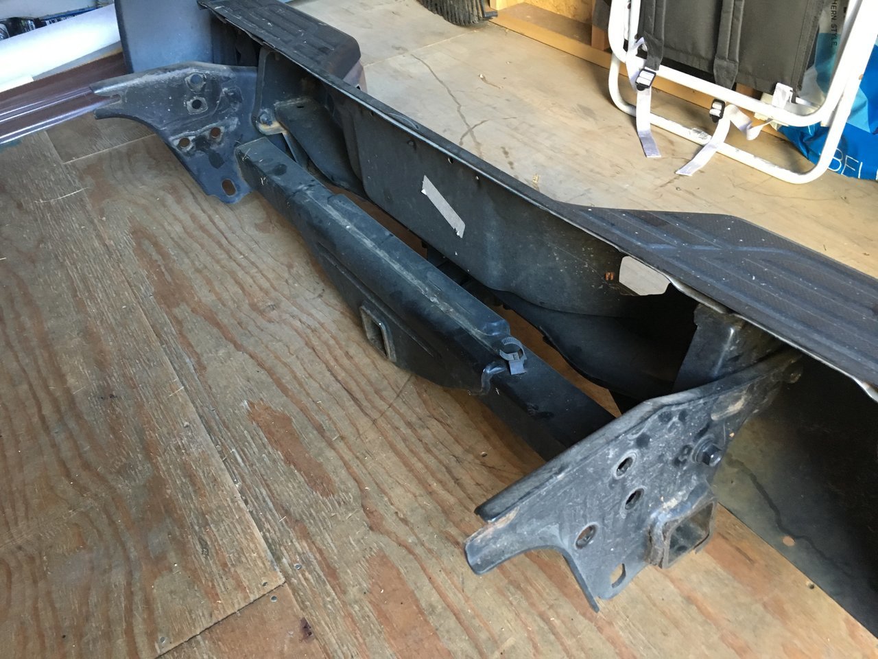

    Was thinking of modifying the OEM rear bumper- adding LED light cut outs, maybe foot steps in the corners of the bumper.
    When I was looking at the bumper I started looking at the trailer hitch- thought it looked too low... started to think of cutting through the square tube on each side- rotate it and flip it- put a sleeve inside and weld it back together so that the receiver now lands behind the license plate (move your wiring plug behind the plate as well)- cut a large hole out behind the license plate (use a flip up license plate bracket) when you flip the license plate you should have access to your receiver and your wiring plug. Would give a cleaner look and more clearance/ departure angle.
    Think it would work? Anyone already done it?

    So I seen this pic and it brought me back to the idea of flipping the trailer hitch.
    I am now thinking the easiest way would be to cut the factory receiver tube and safety chain points off and weld a new receiver tub and safety chin points on the top of the existing square tube that runs side to side.
    Something like this; https://www.etrailer.com/Trailer-Hitch/Curt/9883544.html
    Then use a drop hitch so the ball is at the same height;
    https://www.etrailer.com/Ball-Mounts/Draw-Tite/2793.html
    Licence plate flip bracket;
    https://www.amazon.com/gp/product/B000FQ23JK/ref=ox_sc_sfl_title_68?ie=UTF8&psc=1&smid=ATVPDKIKX0DER
    Reuse the trailer wiring plug mount, weld it beside the new receiver so that it sits behind the plate as well.
    Once the weather is nicer I will do some measuring and see if any of this is even close to being able to work.

    I want to do something similar, only I plan to shift the license plate to the left as well, so the plate doesn't interfere with the receiver. Not sure when I will get to tackle this one, but I am following your thread now...

    The receiver protects that flimsy bumper so I'd recommend just replacing it all
