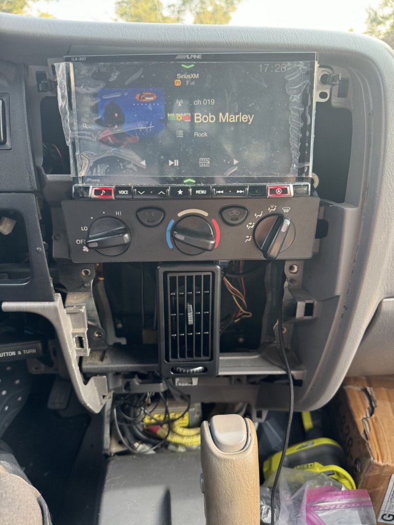

    I am working on a box to put into the vent area of the dash to hold a single din or possible a double din car radio chassis. Some modification will have to be done and possibly a 3D print of the bezel. I will post picture as this project takes off in the next couple of weeks.
    The posibilities are endless, but I am working on the single din first since I already have the radio as a template.

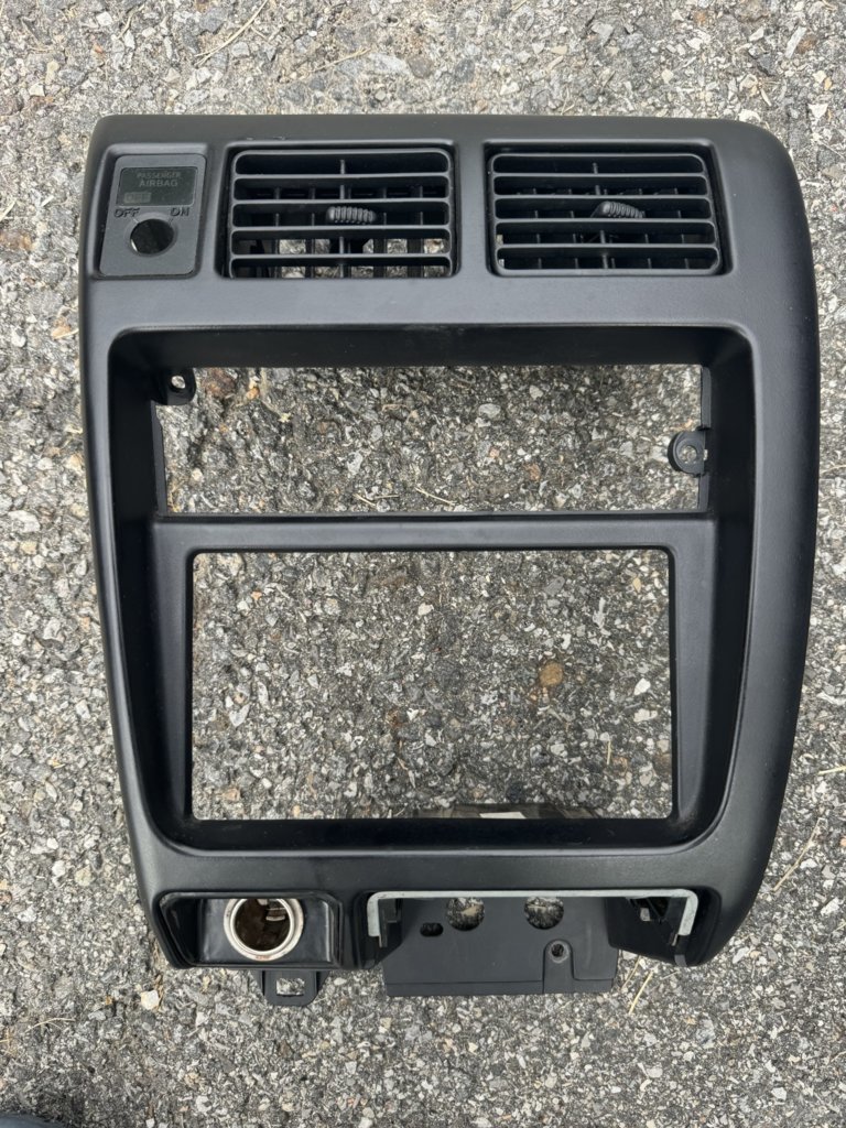

    The entire top section will have to be modified and the bottom where the factory double din was will somehow hold the air ducts and maybe some switches.

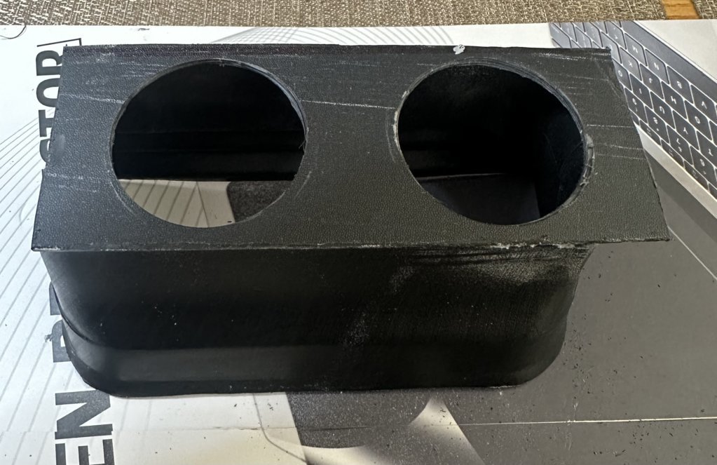

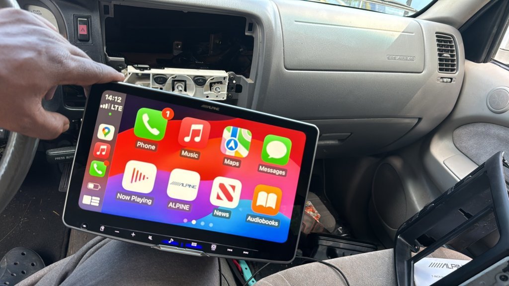

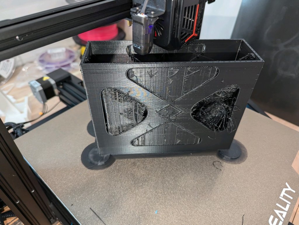

    Here is a 3D print of the single din type for the floating screen, it’s going to be for my Alpine flagship model Alpine Halo11 iLX-F511 Digital multimedia receiver 11" 1-DIN Touchscreen.

    It’s going to look sort of like the newer trucks where the radio is on top with the touch screen slightly higher than the dashboard, giving it a floating screen feel. I got the idea from another 1st gen owner, here take a look at this YouTube video.

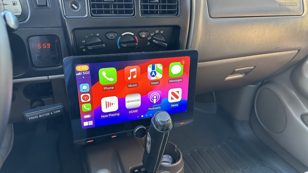

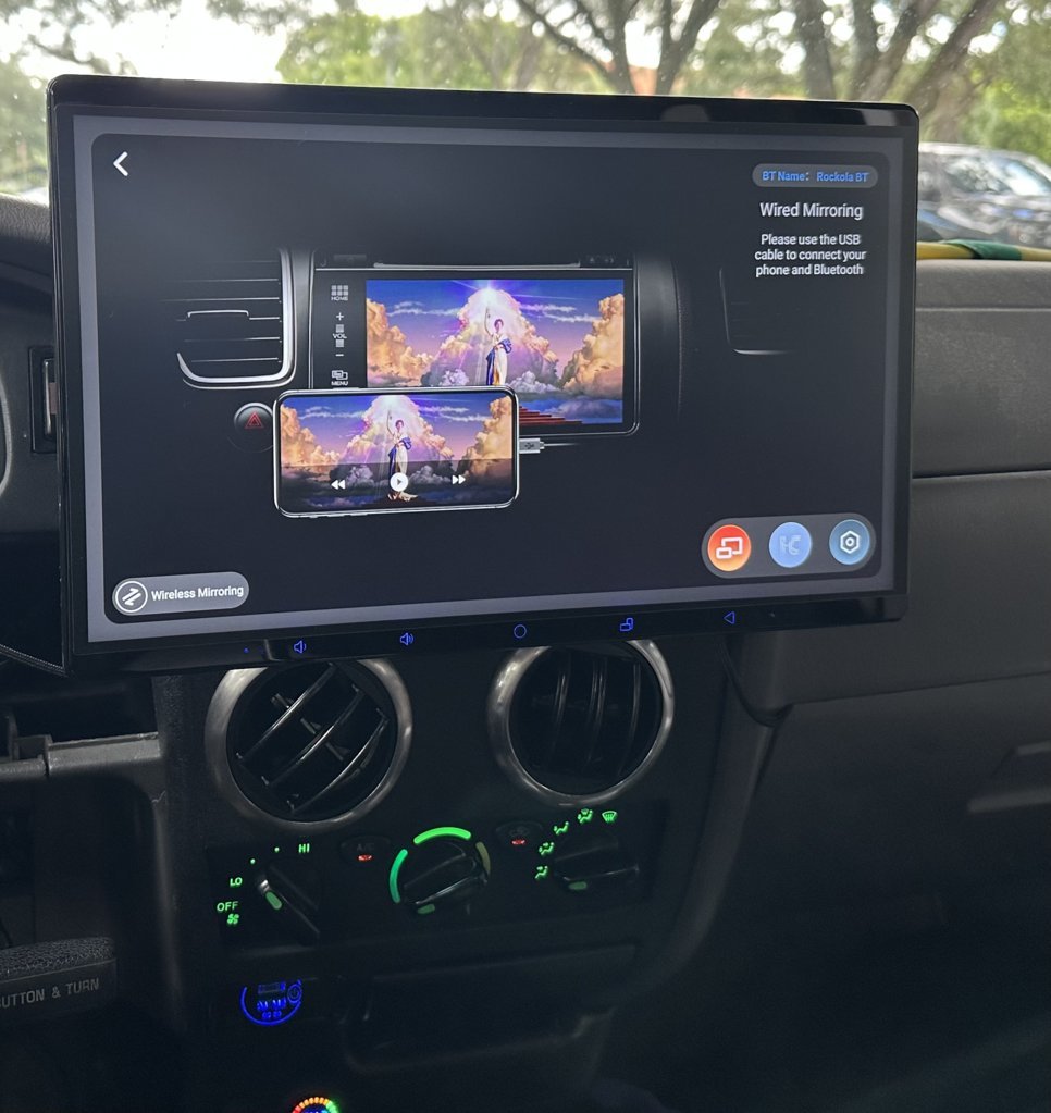

    That’ll be great positioning once complete. I mounted mine in the stock location and 3D printed a new shift knob so it’d fit. It works, but definitely is not an ideal location for a touch screen.
    One question, are you just deleting the center air vents?

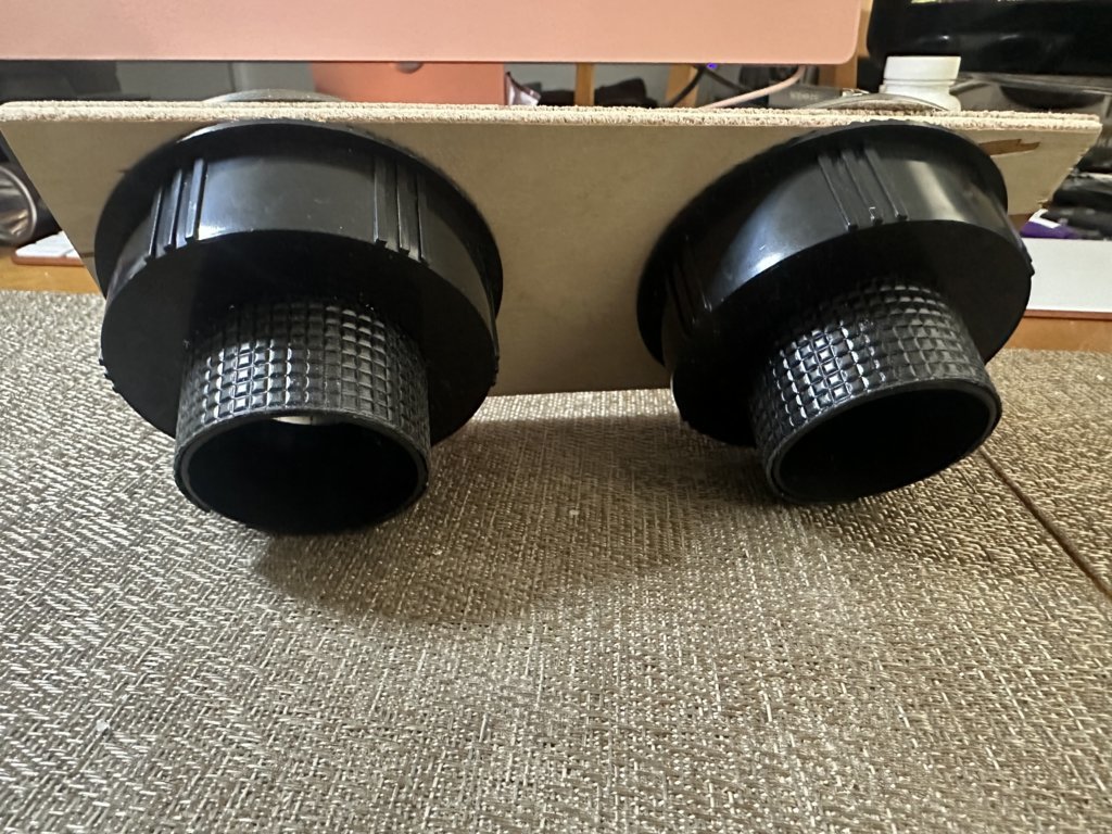

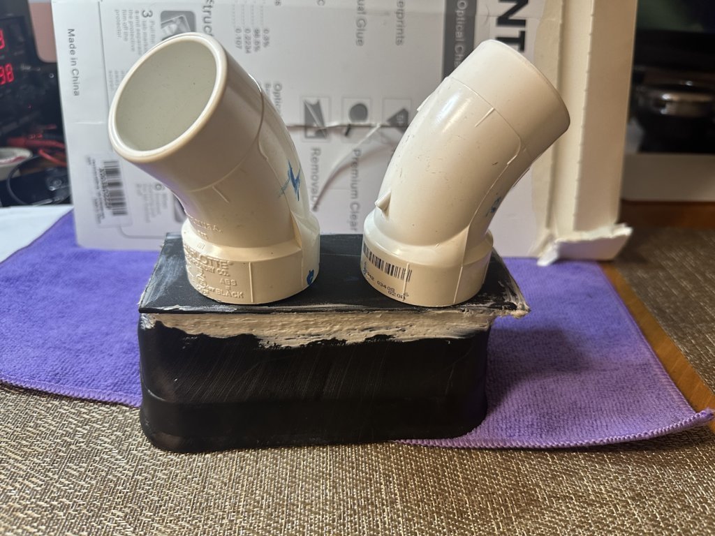

    This is the one I am using for the relocation of the middle vents.

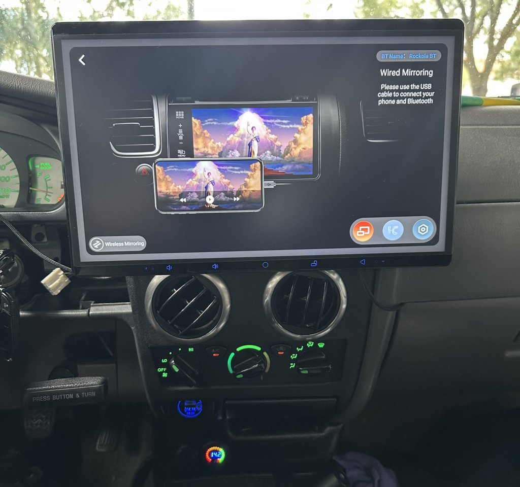

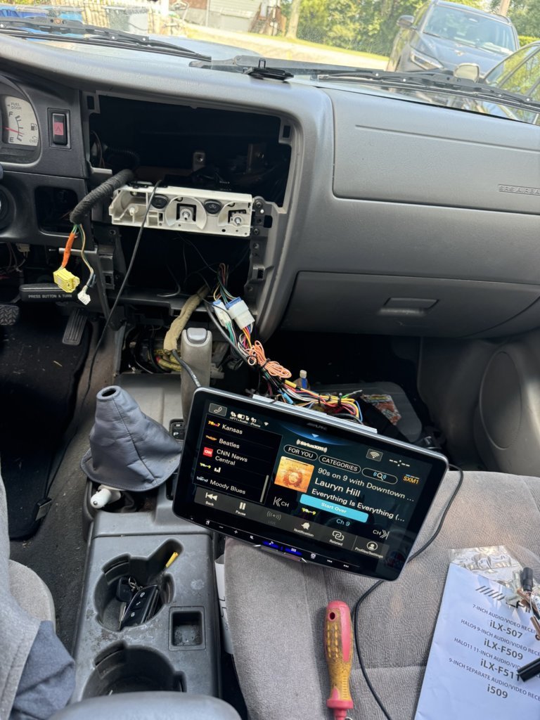

    Did mine a few weeks ago not too hard to pull off there is enough room at the top for a double din

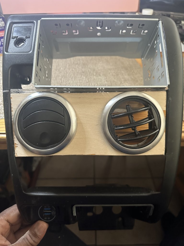

    Here is a rough mock up with the double din frame mounted
    here is the vent outlet that I cut and modified so I could attach flexible hose to come out to the forward vents

    Nice ,,,, I like it , how did you change the color to green? I like that look better, what hose did you use?

    You need the climate control faceplate & knobs out of an 01-02 SR5 4Runner. Those have white tint on the back instead of orange, allowing you to use any color bulb.

    Got it , have to see if I can get one from ebay or a forum member
