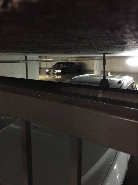

    Those parking garages can be murder.
    Houston likes this.

    Damn! I live in Houston too bro and i'm seriously looking at an airboat mod for my taco. You should read what @freedomriding went through buying a flooded 4runner. Let it go and buy a new 3gen.

    Haha thanks for showing off my old girl! Miss that truck

    Yeah that's was my truck from last years Memorial Day floods. I never parked on that level again lol. But I was with good company all the nice cars in the garage would park down there so no one would ding there doors
