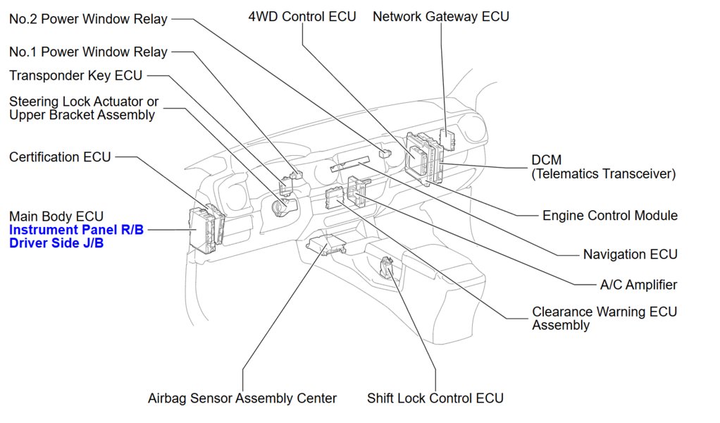

    no comms right now checked all the fuses and relays everything ok except for the central pink 30 amp fuse that is suppoused to power the back sliding window changed it and keeps blowing it, dissasembled the back of the cabin to see if the motor was flooded too but no water on that part everything clean, disconnected all the line in the passenger side also the passenger front and rear doors and keep blowing it. looked at the diagram and there is a relay maybe the relay is making this fuse to blow the thing is already blowed 5 fuses @ 8 dlls each in autozone prefered to order 10 fuses in ebay lol. all the other windows in working condition up and down side mirrors in working condition dome light working horn working all lights working already checked all the ground connectors

    Let's ignore that fuse for now and focus on getting communication going, once we get to that there's much better ways to find the short than to keep popping fuses.
    First we need to determine if the truck has a Network Gateway ECU or not, if it does it will be on the right end of the dash. It has a single 30 pin connector.
