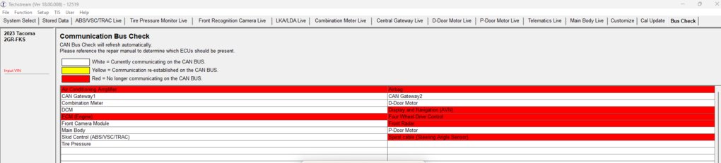

    removed it from its housing and i wouldnt say its fried but at least one part was exposed to water i will try to clean it with a circuit cleaner or should i orden a replacement from ebay? what do you think?
    this also gives a clear idea of how high the waterlever reached

    Great, now we need to check the 4 powers and one ground going to it to see if they are good.

    You can try cleaning it but yea it's probably dead.

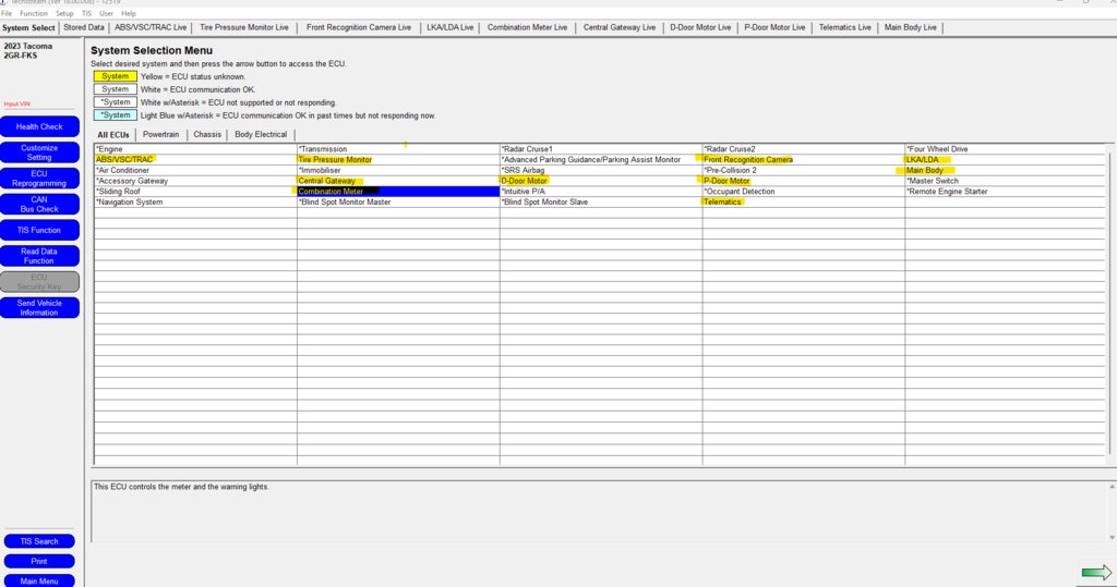

    my fault you are right yes its rearward already disconnected battery and all connector and already let them dry thanks for the suggestion even with that some connectors still have green corrosion problems and we already cleaned them all relay disconected cleaned and ok
    Thanks ill let you know the outcome!!

    already ordered from ebay network gateway ecu waiting it to arrive to continue testing :)
