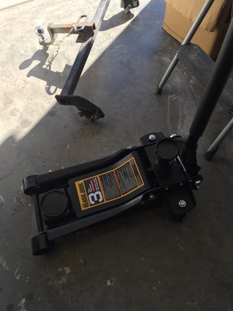

    Costco $100 black jack 3T duel piston. Works very well for me and it low profile so can use it on others smaller cars.
