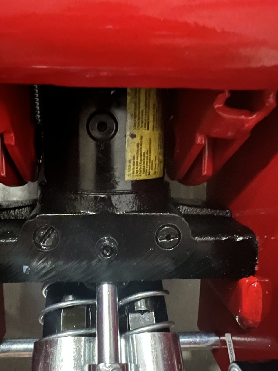

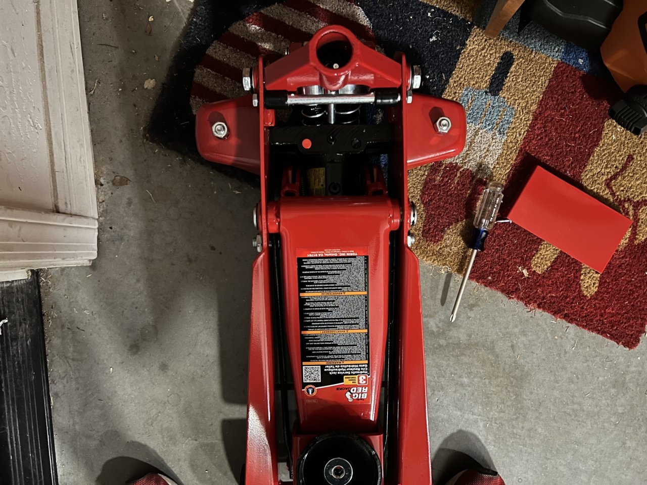

    So I bought this brand new jack for general maintenance on my truck. I added oil to it and it seemed to go up and down fine when cranking the handle on the ground with no resistance, just the jack on the floor.

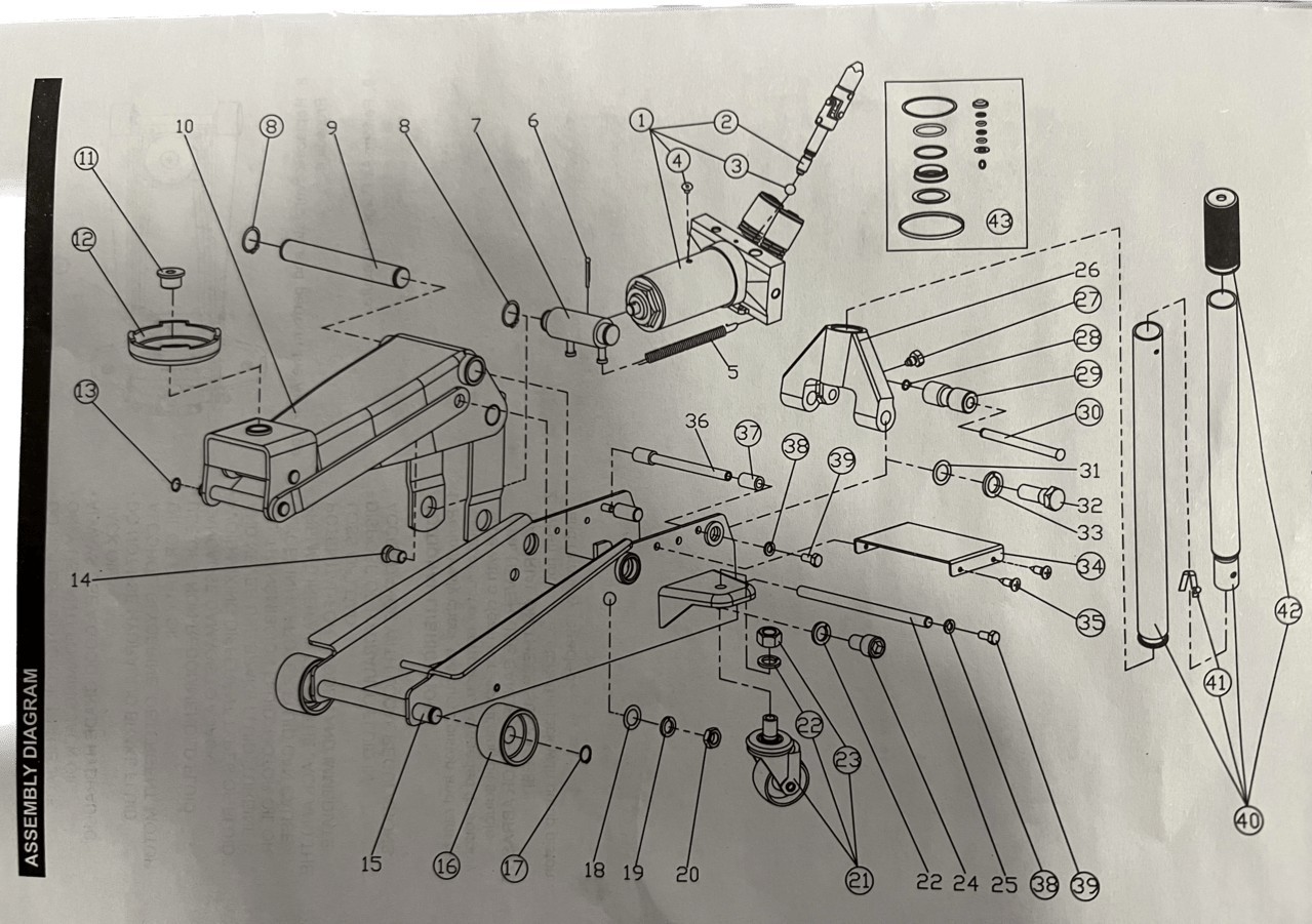

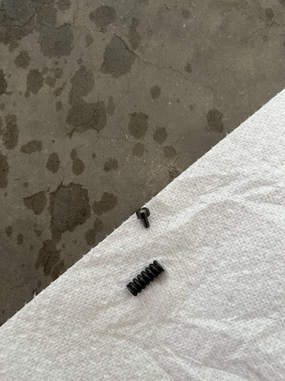

    So I was about to use the jack the red plug blew out and oil from the jack went everywhere (I may have over filled it). Anyways, two other parts flew out a spring and some kind of pin piece.

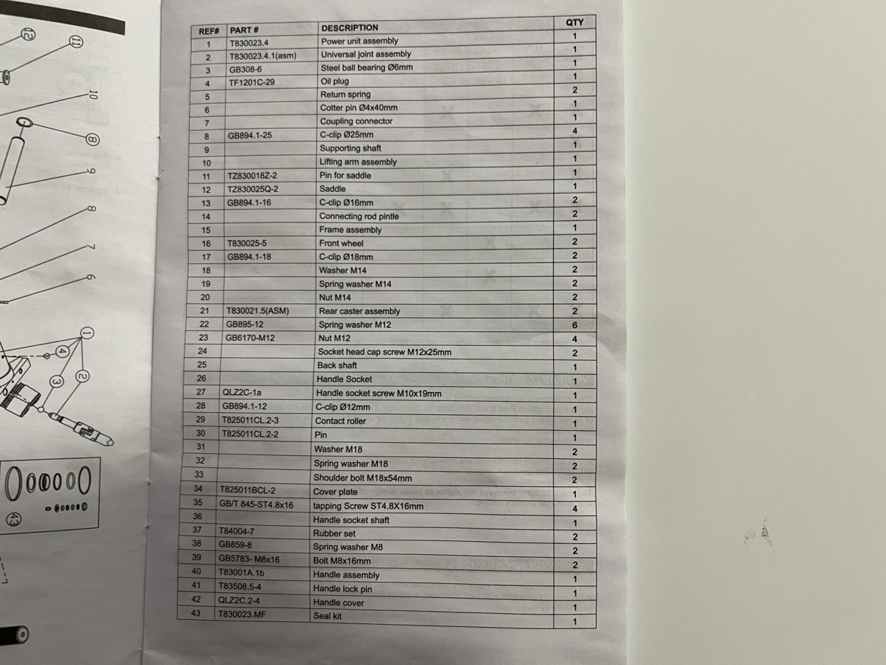

    My question is, did these all come from under the red plug? If so what is the order of putting these back in? The owners manual has a parts picture but nothing about this part of the jack for some reason.
    The other problem is the saddle goes up and down fine on the ground but when I place it under a vehicle it jacks the vehicle up but it eventually gets to a point where it stops and doesn’t jack the vehicle up anymore.

    Can you get us some better pics of the jack model number? Should be able to find a diagram.
    my guess would be there is a check ball in the hole, then the black insert goes in (stud up) and then the spring followed by the red part which assume screws in. Better pics of what you have would be a huge help

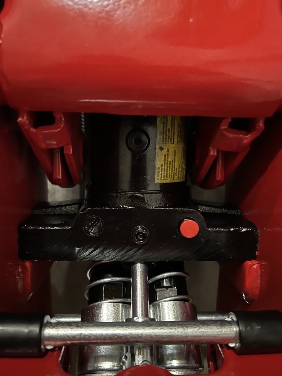

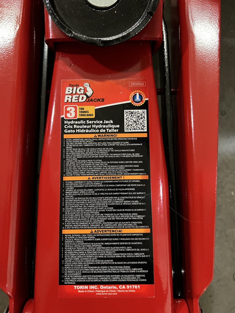

    Here’s some more pictures.
    The last two shows that tiny red plug with it inserted and with it out. But I’m not sure the spring and pin came from there since it looks like a screw of some sort. So I’m not sure where that spring and pin came out of. I can’t seem to find them in the manual.
    I’m thinking I didn’t need to add oil. I overfilled it. The oil contents were too much pressure and it essentially blew part of the jack out. But now I’m concerned about the safety of this thing and it doesn’t jack a vehicle up all the way either. But the saddle will go up all the way on the floor after cranking the handle up and down. I did purge the air earlier.

    There is supposed to be air space if it's over full it's going to blow the vent plug out of the jack when you let the jack down. I would not use that jack until some one has a look at it. If it does not go all the way up you have lost enough oil that it won't. The little red plug is just a cover.

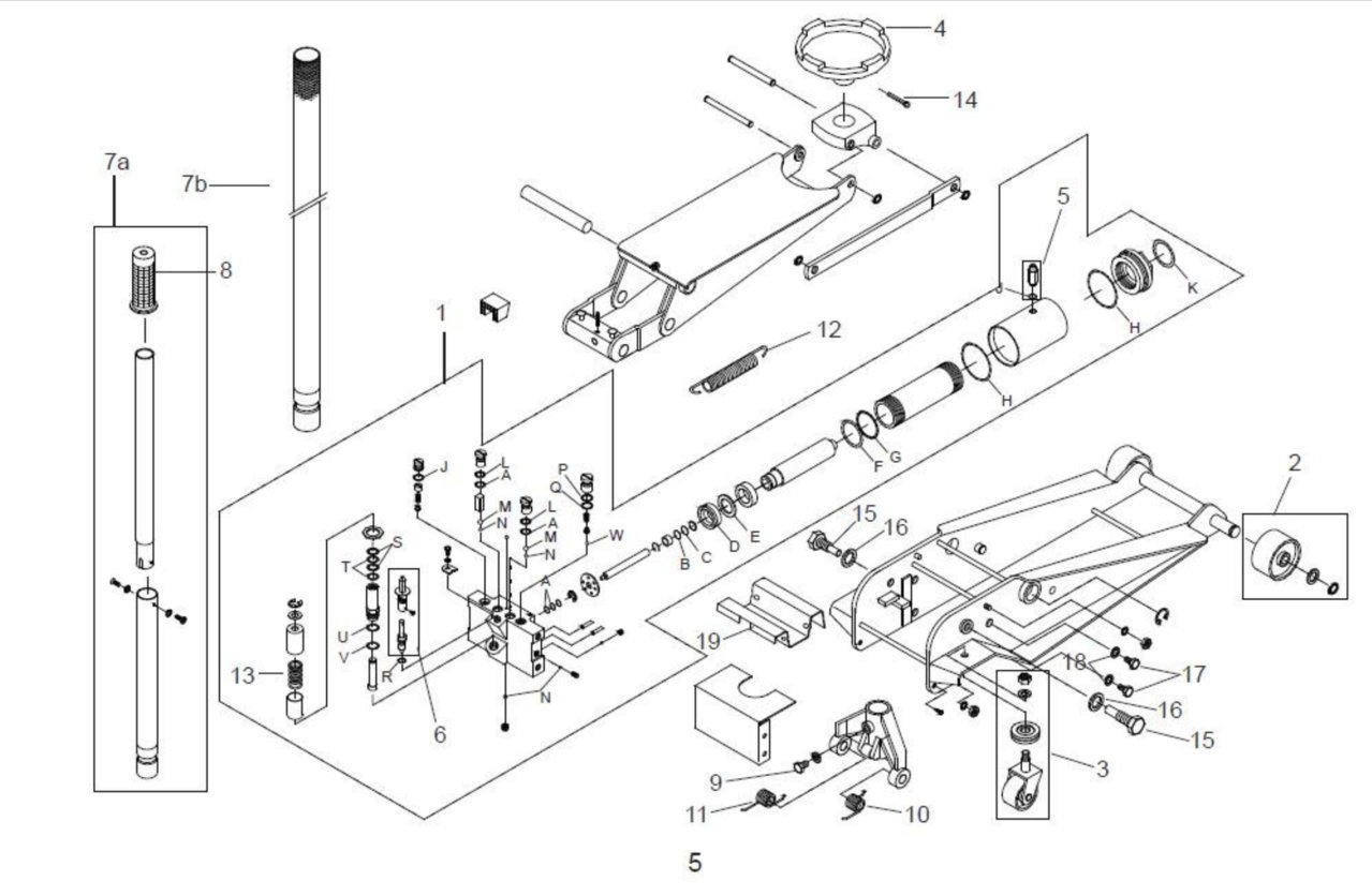

    Thanks for the pics - looks like that red cap was for a vent which was needed due to the additional hydraulic fluid you added. Not sure where the spring and insert came from but they do look like parts that go in a jack. May be worth calling the manufacturer to see what they say…
    Edit… best I can find on a legit parts diagram. You can see where that small spring and component may go… beneath those large diameter screws. Perhaps it was an extra, or came out when you filled it?
