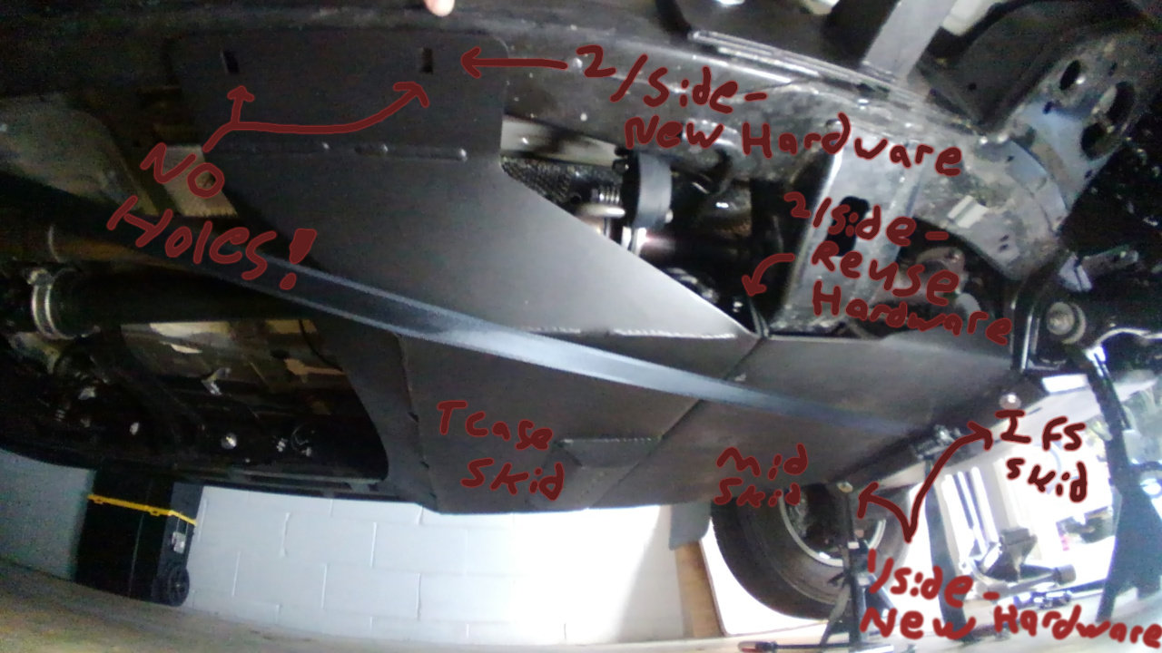

    Do you have a picture of the mid and tcase skid from SOS? I am trying to find a third gen owner that has all three but can only ever find pics of second gens. I have the IFS already and wanted to pull the trigger on the rest.

    This pic I put up showing install gives you an idea, it's a bit crappy though:

    Did you have to drill new holes? Also did you need an exhaust reroute?

    No reroute, the skid has an option to select "no reroute" and has that little dropdown you see in the middle of the last skid.
    I had to drill 4 holes on my SR5 where it says "no holes." Those took a bit, the frame metal is tough and each hole took ~10 minutes.
