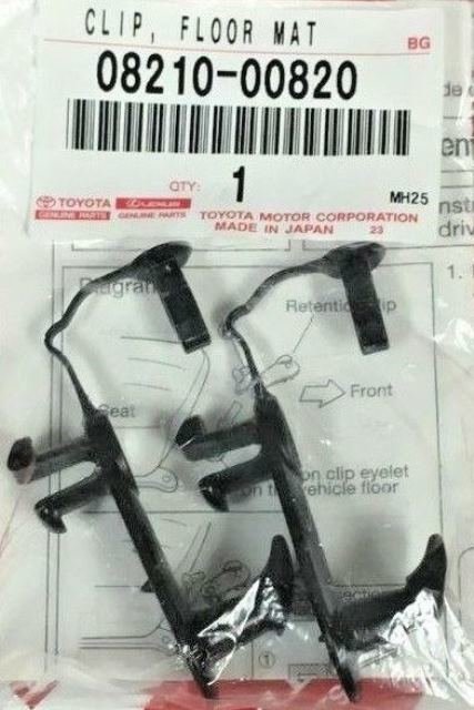

    My solution:
    Clip, Floor Mat  08210-00820.jpg <<<---Clip Comes with instructions. This is the NEW design. In the photo, the UPPER part inserts into the MIDDLE part after the MIDDLE part is inserted into the hole in the FLOOR, to keep it spread and secure. The LOWEST piece sticks up through the CARPET and the FLOOR MAT, with the hook facing the rear of the vehicle.

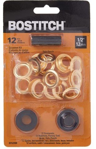

    Bostitch Grommet Kit.jpg<<<---Grommet kit comes with tools and instructions

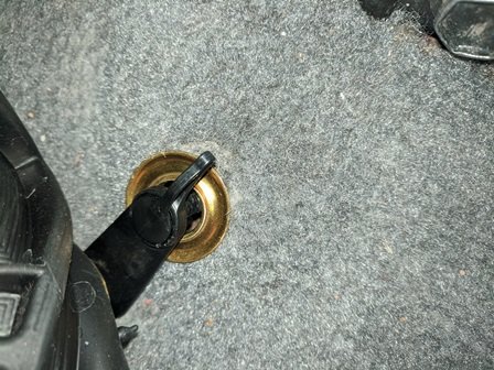

    Clip, Floor Mat, Installed in CARPET (5).jpg <<<---Grommet installed in CARPET, Floor Mat Clip secured in "hole" in floor UNDER carpet.

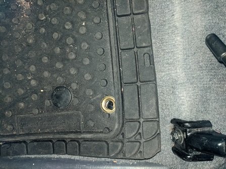

    Clip, Floor Mat, Installed in generic WeatherTech Floor Mat (2).jpg<<<--- Second grommet installed in ANY Floor Mat, aligned to the grommet in the carpet.
    This is the generic, trim to fit, WeatherTech Floor Mat sold at Costco and Auto Parts Stores.

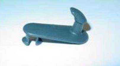

    Clip, Floor Mat, OLD STYLE.jpg <<<---This is the OLD style clip, and looks like the one supplied by WeatherTech. DO NOT USE THIS STYLE!
