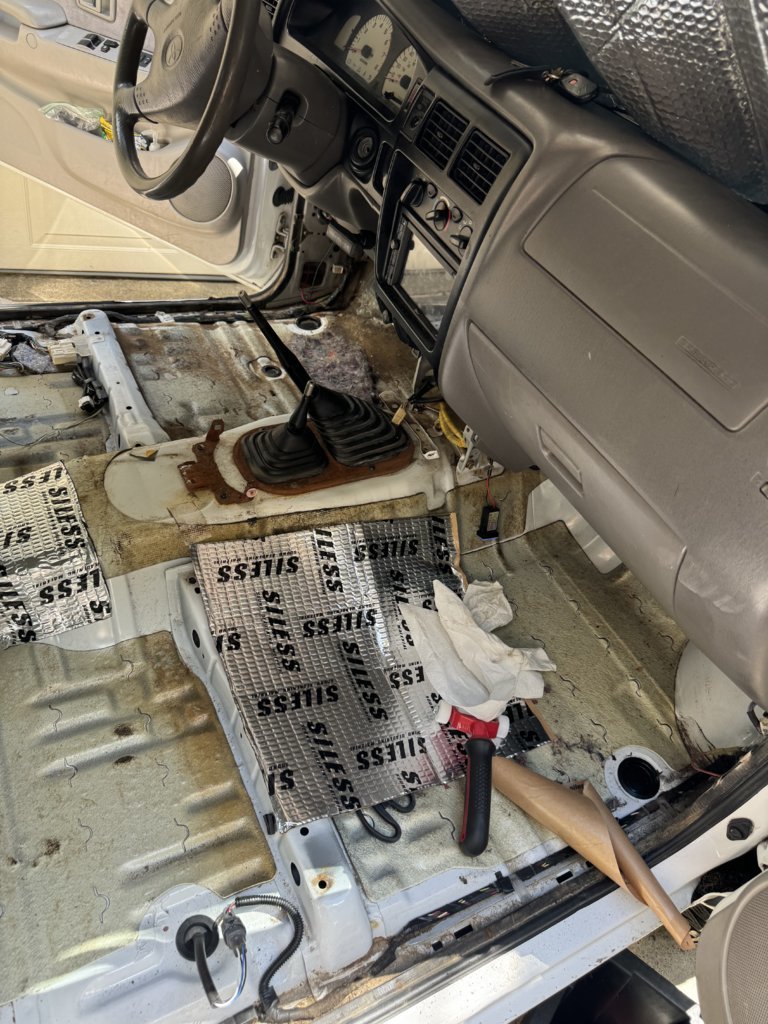

    Love this floorboard insulation so wanting to share.
    Pulled my original, super worn out carpet and replaced with less worn out (clean) salvage yard carpet.
    While the seats and carpet were out I added this insulation from Amazon. Well worth money and the hour it took me to install. The truck is noticeably quieter. I might even be able to use the speaker phone now. Sadly I didn’t get an after pic.

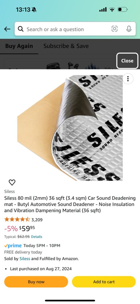

    Was that 36sf enough for entire floor?

    36 sf was plenty. Did the rear cubbies too. Doubled up near the transmission. And a few pieces left over to add to the inside walls of the doors when I have the time. You’ll figure it out. Make sure to have the little carpet/linoleum roller device from Home Depot. That’s a must. And be careful of the sharp edges in a few places.

    And I covered up the drain hole plugs. Too much effort to cut in and just more of an opportunity for noise to ‘leak’ through.

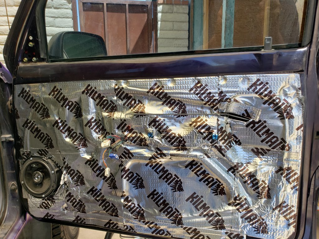

    Did my door panels with similar stuff, works very well and holds up to the Tucson heat. Made quite a difference sound wise.

    I like that. I’ve heard some people stick some on the interior of the door while the glass is up to deaden vibration. I’ll probably order more and do like you did. Love these trucks but man it’s tough to make phone calls at 70mph.

    I've done this to every surface as I remove pieces. Makes a huge difference. Especially in the doors, just a loud thud when you knock on it versus the hollow sound. Whenever I send the seatbelts off for new webbing I'll be knocking out the rear panel area. Did it when installing new carpet too.

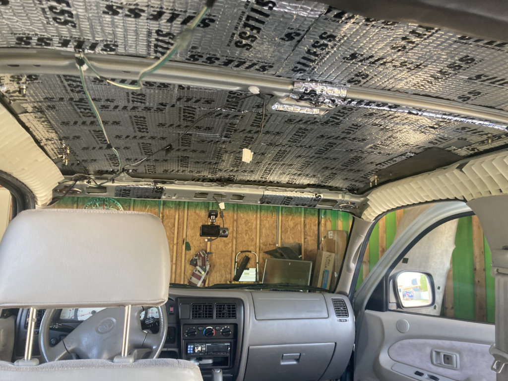

    About 20 years ago I did my entire truck except the roof (I used Raammat), because I was convinced that I would crease the headliner during removal. I'm thinking of finally doing the roof, now that the mod list is short. Assuming no issues doing the roof, or issues with creasing the headliner?

    I did all of this on my 2002 Taco a few years ago and it did make a difference but not as much as putting new tires on the truck did! I think i would do it again but i would not be as hell bent on covering every square inch like it did the first time. Looks good!!

    You have to fold the headliner quasi hotdog style to get it out of the cab, but I was able to get it out/in with patience and that was with seats and console taken out already. One person was enough but it was a handful. No creases exist. The greasy handmarks remain.

    I have popped out the rear window and the headliner can come out that way with just a little bit of flexin
