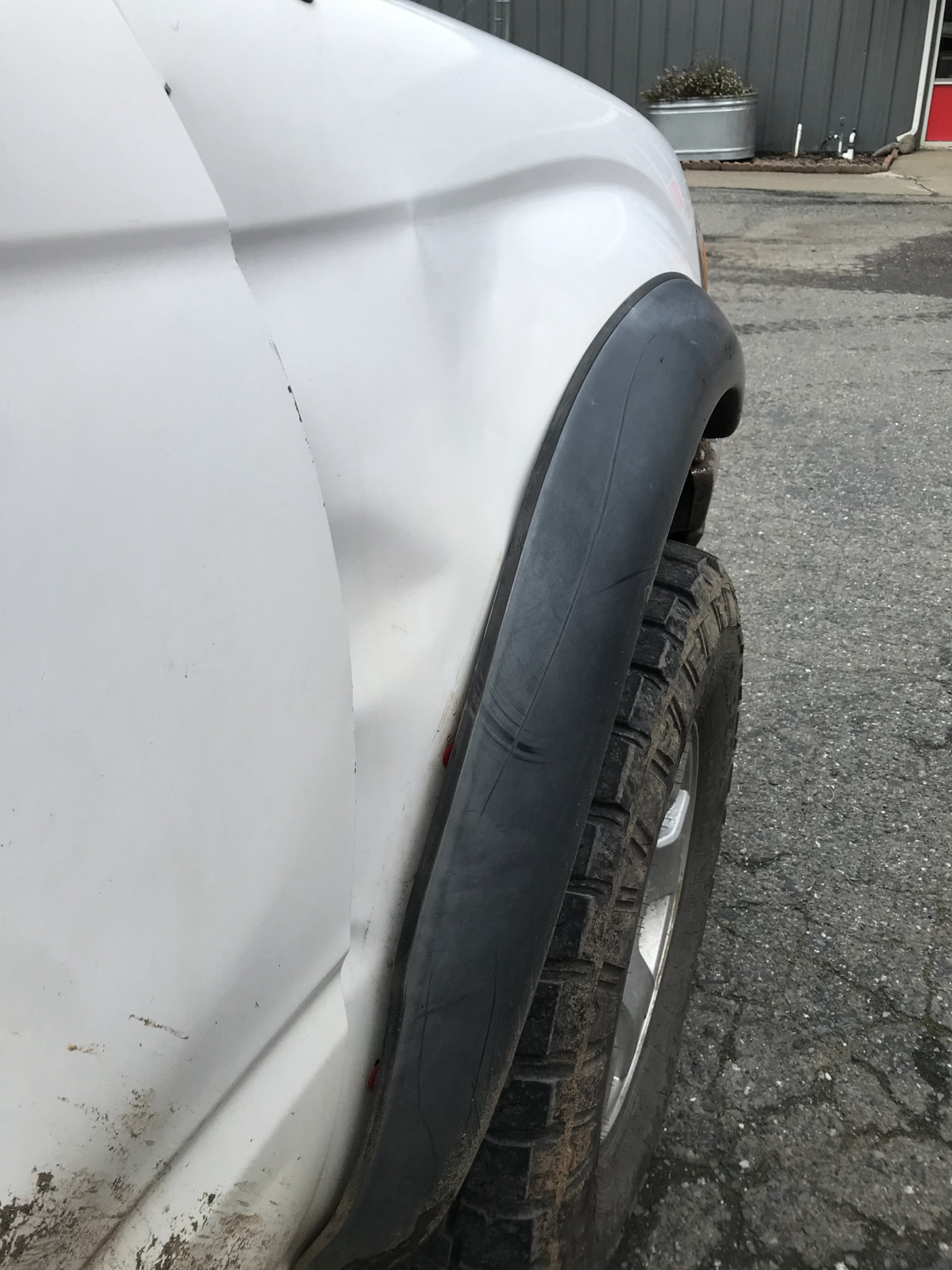

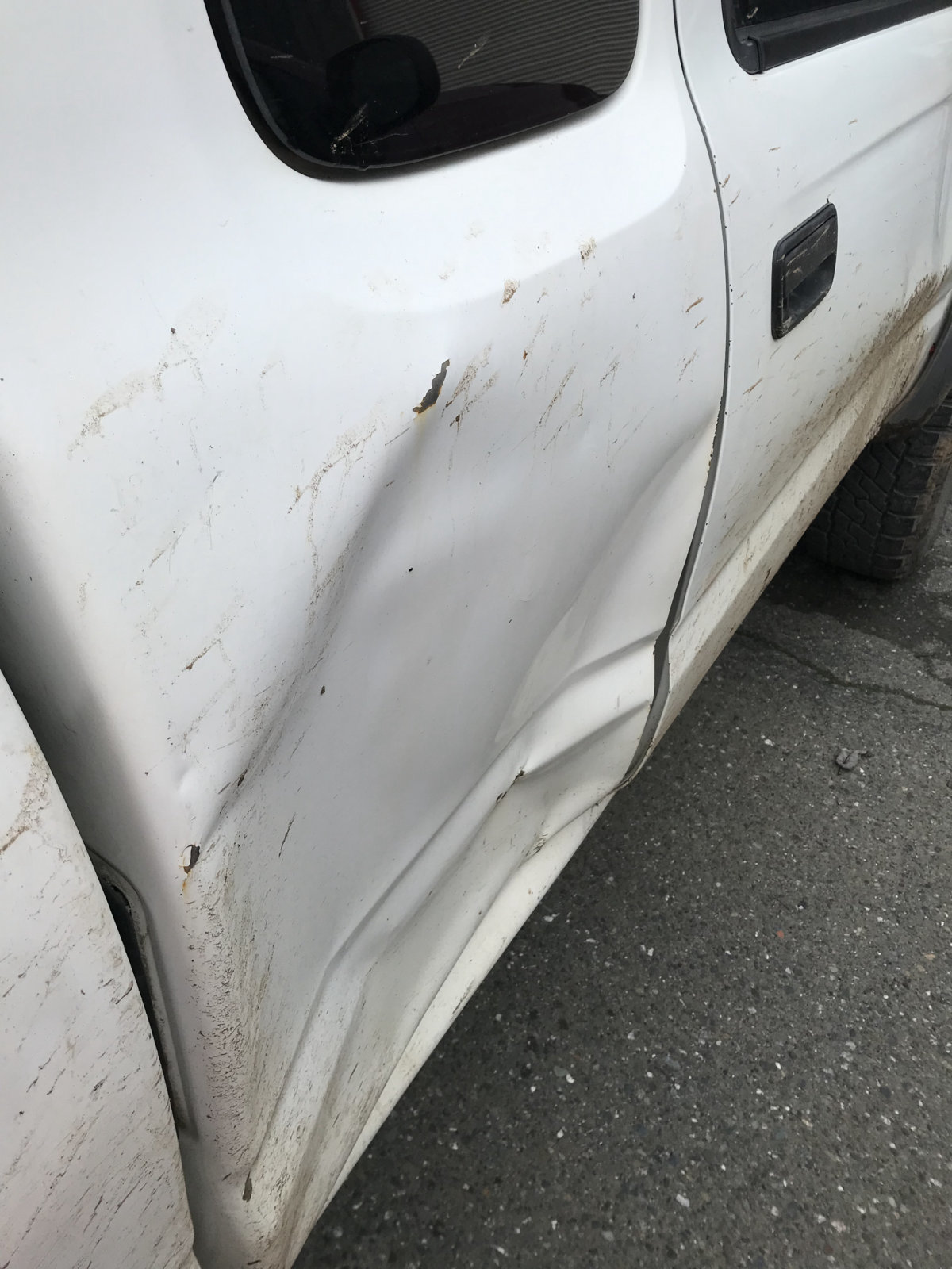

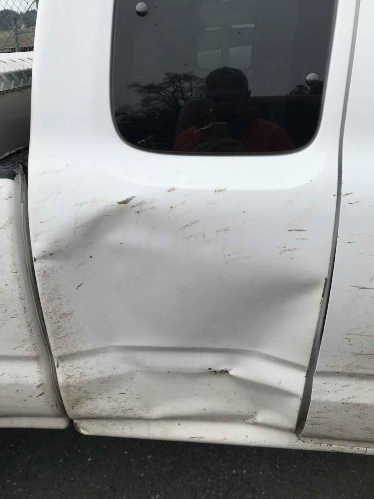

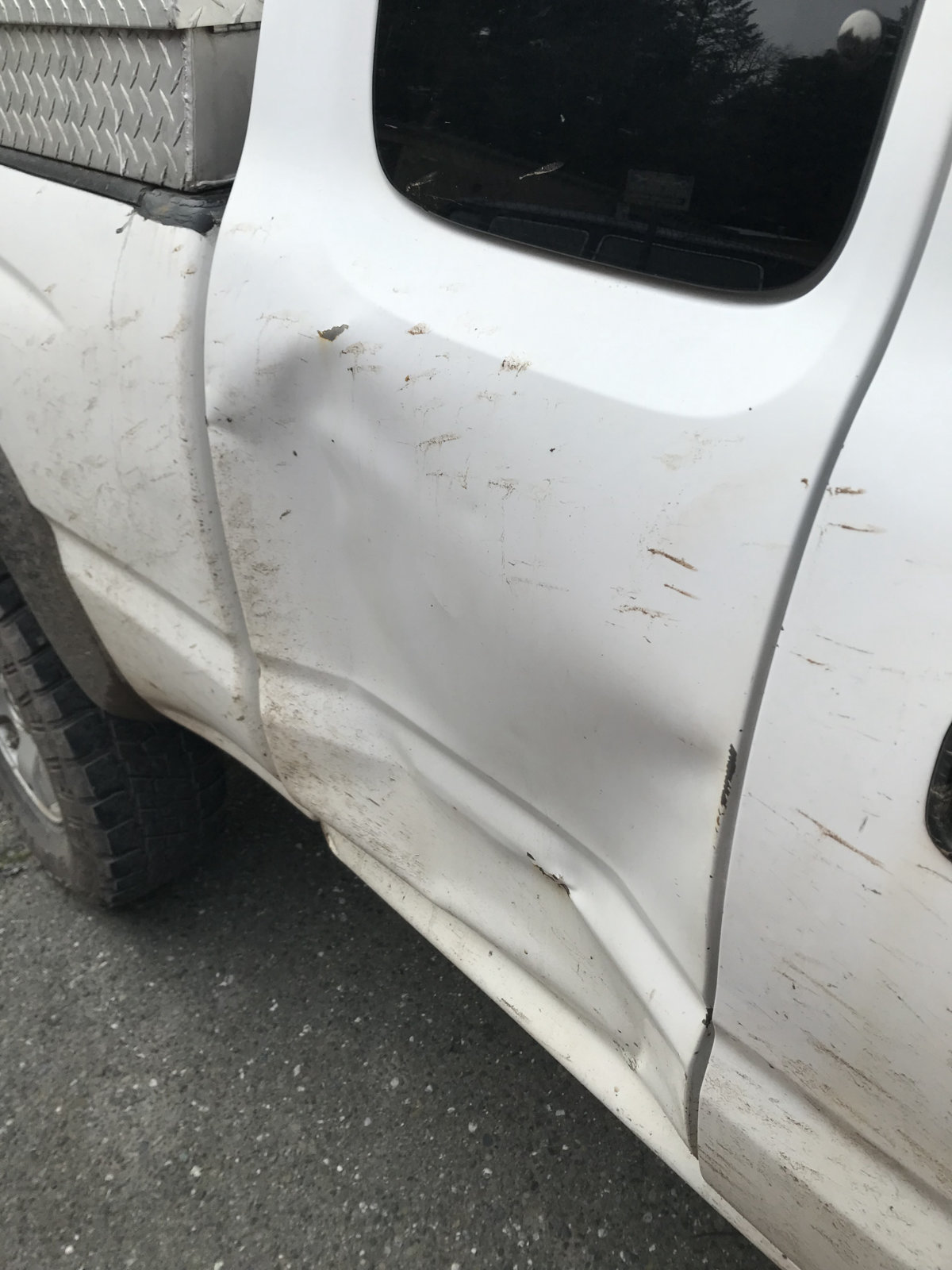

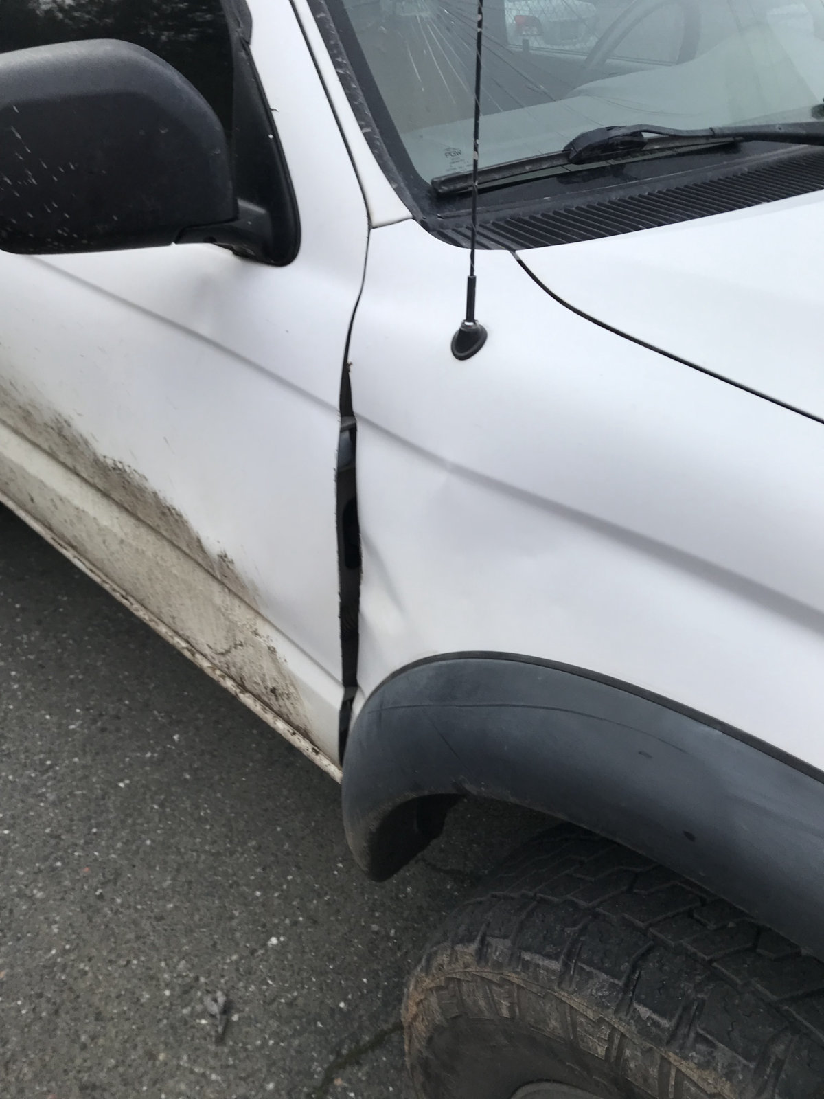

    Hey folks, I flopped my truck on its side a couple weeks ago. Got her rolled back over and she's fine mechanically but theres some ugly body damage. I live in the mountains and my trucks got plenty of cosmetic flaws but nothing like this. Ive got an insurance claim going and it's at the body shop getting an estimate. With 300k miles I won't be surprised if they total it. From there it depends how much they want to pay out, but I'll either cancel the claim or total it and buy it back and try to get it looking better, I dont need it perfect. Anybody ever deal with this kind of cab dent? Im hoping I could just take the interior panels out and push out the dent from in the truck. Any insurance or body work advice?

    Maybe try a paintless dent repair tech? Probably won't look perfect, but I'd guess they can get most of it out for cheap money.

    Paintless dent repair has come a long way and might be the call for the cab. Lots of body parts on the Tacomaworld buy/sell/trade to swap out that fender. If you have a solid frame id say its worth keeping the truck on the road.

    Yea. pull on that all you can before hitting it from inside. You'll get it mostly. It'll always be wavy so learn to love it.

    IMO, you might be able to pull out the dent from the fender, but the part behind the door is toast because it has been stretched.

    New fender and paint it.
    Use some suction cups to remove the other dents as much as possible.

    creases dont come out. Needs professional body work..I could be wrong

    you should be able to find a door and fender used cheap. And bedside if needed.
    but that rear quarter panel of the cab is probably welded on and not easily replaceable with bolts. Therefore would be a good idea to consult with a quality PDR person.

    New fender and just pop the dent in the cab out from the back. It's pushed so far in suction cups probably wont cut it. It will never look "great" because the metal is stretched so much and PDR will have the same issue. I'd just pocket the cash get a new fender fix the cab at home and call it good. I've popped the door dents out multiple times from the inside.

    You are not wrong. The cab needs a conventional repair, not PDR. PDR would get some of it, out, but not all.
