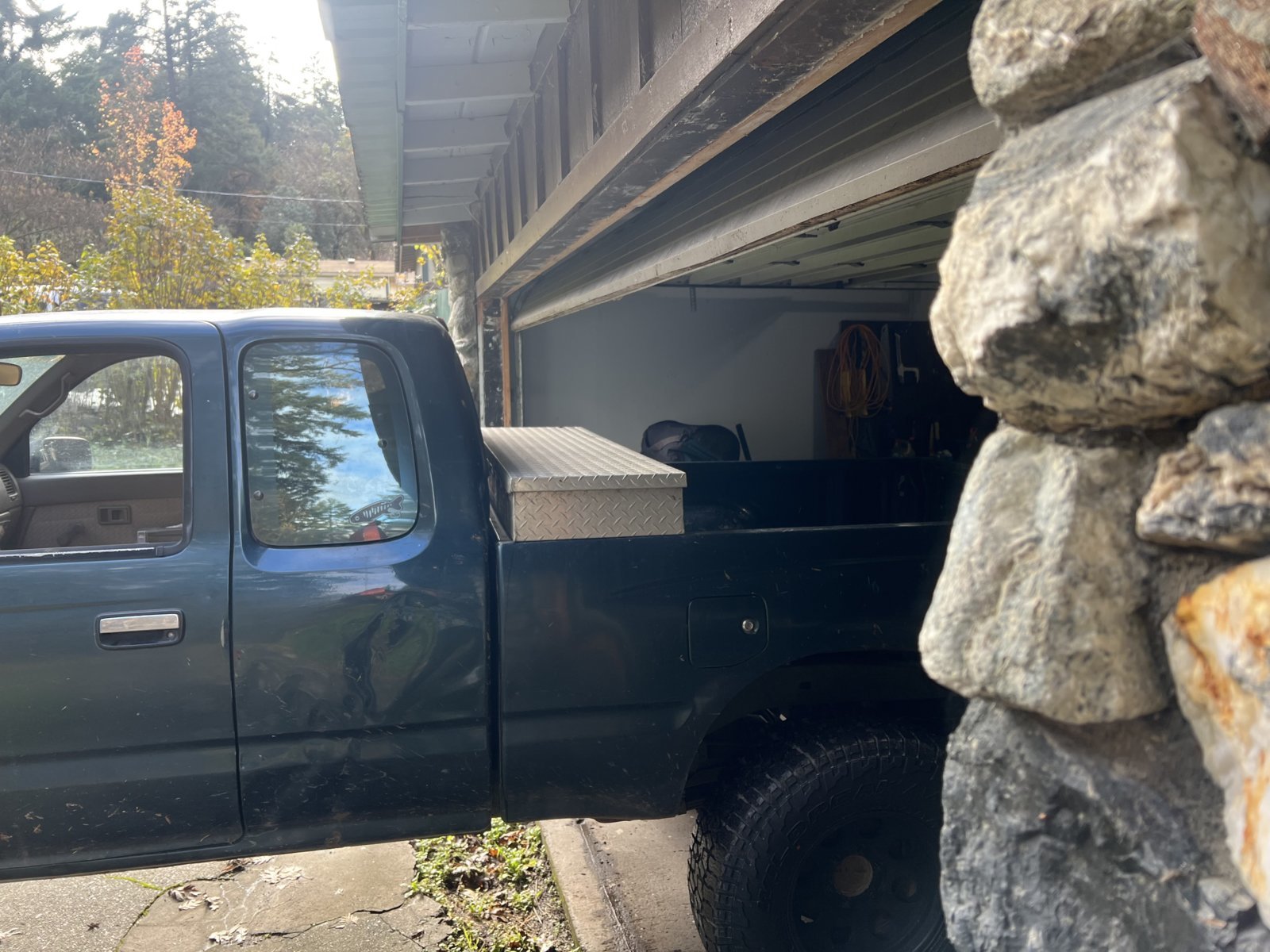

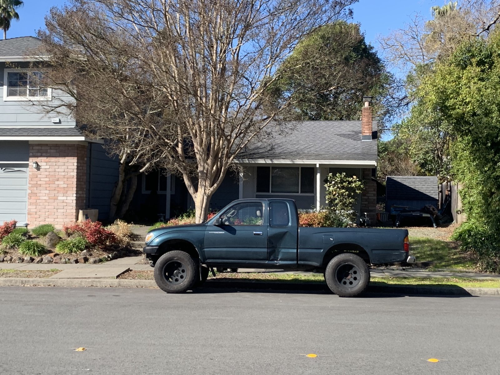

    I agree that if you still have damage on the cab when you get it back- you can probably get it in better shape yourself without too much pain. And replace the fender.
    I had a similar dent. I got this far and was happy with it although I’ll probably do some more work on it myself soon.
    In some lighting I really can’t tell it’s there.
    Spent $$ on tabs to glue (pdr hot glue) to perimeter of dent then used a ratchet strap to hook on and pry out slowly. It has a crown in a few places that I can touch up by tapping it back down with a soft ended tool. But for not damaging the paint, I’m satisfied with the progress. I figured to take a break while I was ahead. White
    does have the advantage that it’s easier to paint/ camoflauge.

    @beaverdamland , they ended up doing a great job on the body work, covered under insurance. But yours would have been my route if they hadn't covered it. Good looking truck!
