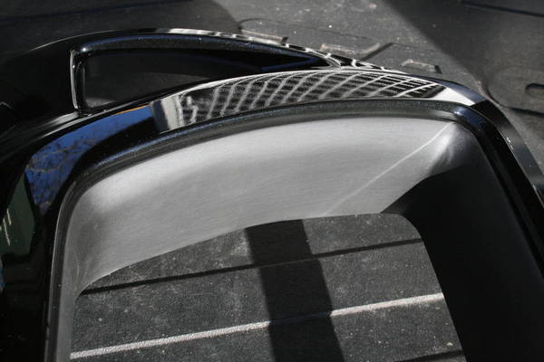

    I AM!!! lol, ive been working on this for the past 4 hours lol, its better than it looked before. I had just painted over the fiberglass originally and now I just got to the bondo, it looks a hell of a lot better than it did

    You need to fill in the gap on the left side also you should sand the back side a little more so that it is even other then that it's looking good:thumbsup:

    This is ready to paint ,,,It looks like you were not even in there[​IMG]

    Getting stuff like that to look good can be frustrating if you're not experienced with it, or lack the patience. I pretty much suck at it myself. I'm too impatient. However, 4banger4x4's advice was dead on--especially about the going back over it with 220 grit after you get it close to where you want it. The good thing about it is that if you have the patience and don't sand a hole in the material you're working with, you can keep doing it over until you get a result close to Jim's.
    Good luck on the second attempt! Try not to get impatient and call it good before it is. I know it's easier to say than it is to do, but it is what it is. :cool:

    ok, sorry about that outburst by me a minute ago, just not a good day mostly. hows this, I really honestly dont see how I cant get it any better, I used the 80 grit most of it, then used the 220 grit to smooth it out

    All of those straight edges will show up when painted. The bondo needs to be "feathered" in for a smooth, uninterrupted look.

    I hit it off & on ,,Its about a hr. on each side.Took me a long time to get block sanding down.. :)

    That's much better than the first attempt. Now hit it with that 220 grit to feather the edges in like Ckeene was saying and to get the grooves out left by the coarser sandpaper and you should be close. If you want it to look really good though, you should probably try to fill in that hole in the top inside corner of the first one.
