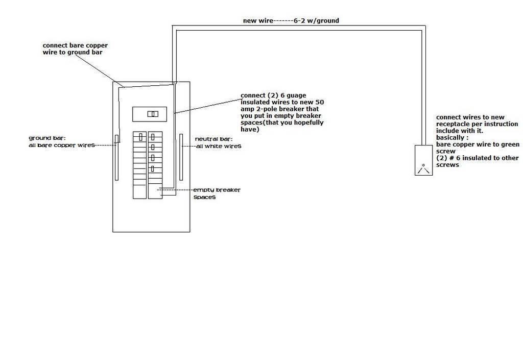

    I figured the cord would be comparable to what would be needed to route it. My parents seem hesitant with doing it ourselves. I think we'll just get an estimate from my moms coworkers husband and if it's too much I'll report back. Thanks for the help.

    jason,
    [​IMG] here is a really rough drawing of what you would need to do for a 50amp 220 outlet. if you have any other specific questions pm me.

    I'm printing it and going to show my dad. Thanks a ton.
