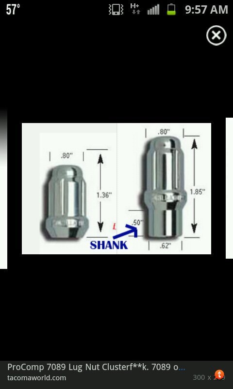

    Not that I'm against the idea of longer studs, but couldn't you have gotten some of these lug nuts with the extended shanks to grab the stud more securely? Just have to make sure they aren't so long they they bottom out before hitting the wheel. I believe Wes can vouch for that one if i remember correctly.

    my rims are so thick, there isn't too much thread to grab onto as it is, but yea i'll def need to make sure they don't bottom out before the wheel, thanks for the advice!

    Hmm...I didn't know about those. They might have worked if the shank fit though the hole in the wheel, but then, I'm only running .25" spacers with steel wheels so that shank might have been too long like you were saying. They would probably be trick in an aluminum wheel though.

    hmm, just realized what these are for, yea, as long as they fit through the hole, i guess that would work too. damn, this way is A LOT easier

    They'd probably be a nice option for your wheels anyway, Nam. They were made for thick wheels like yours. Even so, with a .5" spacer, you'll probably still end up doing the wheel studs.

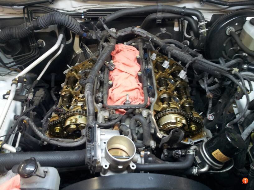

    My fun just started. Resealing the timing cover on this one.
    I posted that picture on the fb tw with the comment "there's got to be an easier way to change the spark plugs on one of these 4.0 motors." Lets see what responses i get from that.
