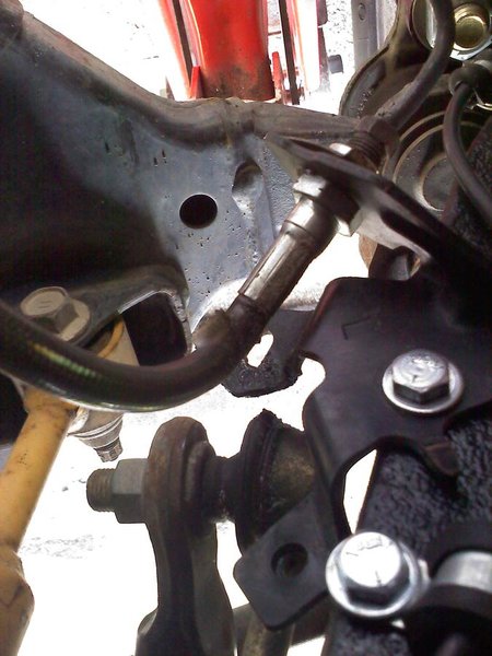

    while you interwebs bullies are picking on jesse's brother, i'm wrenchin like a real man, so the brackets on the spindles are hitting this boot, one of the boots is ripped, and tons of grease, the other one is showing contact, but no biggie, how imp is this boot? and what's the rod that it's connected to called?
    also, some miraculous way, i found out i don't need spacers in the front, guess I wasn't seeing where it was really hitting during install, but i took it off, and it clears, so i took alfuh's advice and not running spacers :D

    Looks like the sway bar end link & you were supposed to cut or bend that tab. Which side is that? I think we bent the one on the drivers side.

    that one is the driver's side, it was bent toward the front
    the passenger side was bent toward the rear
    both were bent intentionally (left by u, right by me :)), not by driving
    they're both problematic
    also on full lock it crunches the brake line, so i'm gonna have to do some bending adjusting tomorrow

    good call on sway bar end link, how imp is that boot and grease?

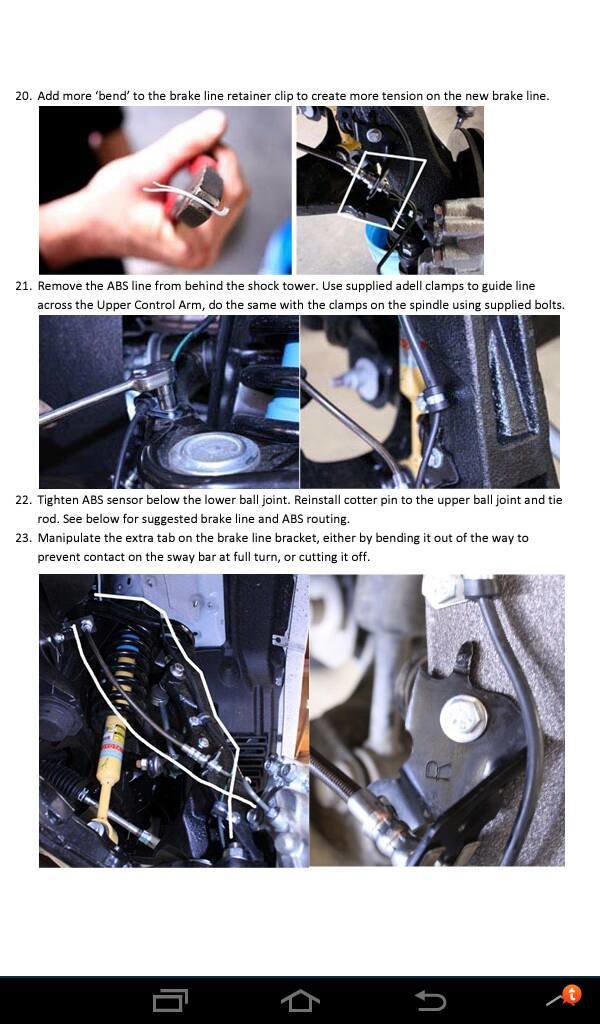

    Well its a ball joint so eventually it will start grinding & making noise with no grease & possibly break.
    From the maxtrac instructions. Step 23
    What was the wheel hitting? I thought the tire was hitting the spindle & thats why we put on the spacers.
