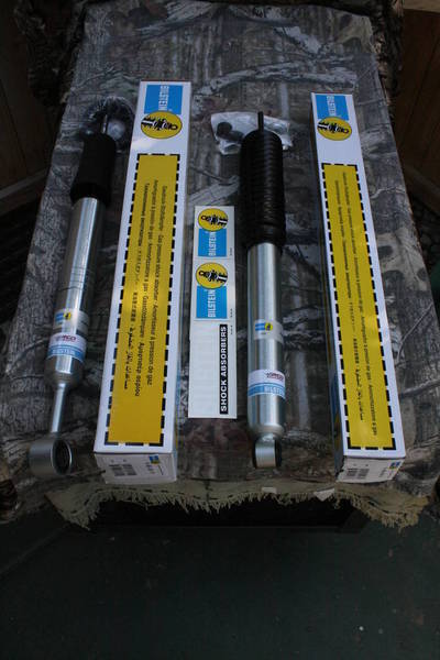

    ===========:bananadance::bananadance::bananadance::bananadance:===[​IMG]

    Did you get rears too or just fronts? What setting?

    Fronts are the big ones rears are the small ones . set on (oem) no lift . was thinking of adding the 1in. what do you think ??? top of the well in rear is 32 in.. front is 29in. as it sits:)

    yeah level it.
    All the cool kids are doing it.

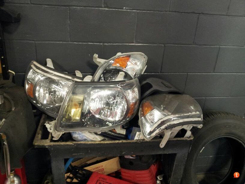

    Got headlights? They just keep showing up.

    p.m.ed ^^^^^^^
