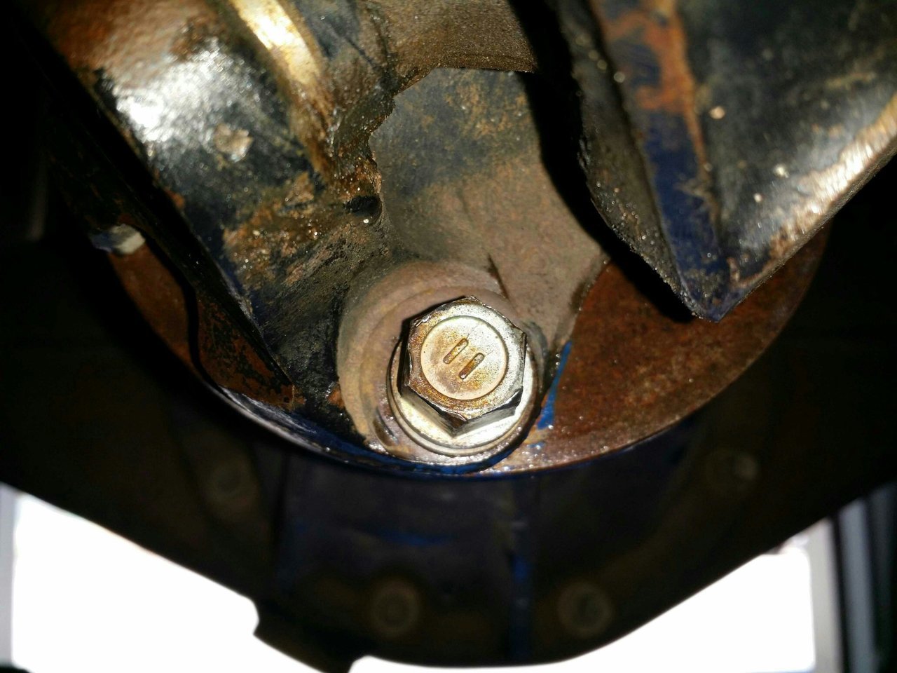

    Most of the Tacomas are 65x65 (10mm) but there are some that are 66 x 66 (11mm). I believe there should and 11 stamped on your bolt or on the flange somewhere.

    Some tacos have 65x65 & some have 66x66.
    From their site:
    Take care in measuring as the 65mm x 65mm x 10mm pattern is very close in size to the 66mm x 66mm x 11mm pattern, the big difference will be the flange bolts. The 10mm and 11mm bolts often have "11" stamped on the heads and the wrenching size is the same 14mm head/nut on the 10mm and 11mm factory hardware. Also, these flanges are often in the 4.5" - 5" outer diameter size. Aside from careful measuring of the bolt pattern spacing, you can usually get a pair of calipers on the exposed end of the bolt sticking out past the nut. The end of the bolt is slightly tapered, but the 11mm bolt will measure about 10.6mm in dia. while the 10mm bolt will measure something like 9.6mm in dia. If you actually remove a bolt and check, the unthreaded shank will measure out quite close to the 10mm or 11mm measurement.
    If you are sure you have 11mm bolts, order the larger 66mm x 66mm x 11mm spacer.
    If you are not sure of your measurements, (it can be difficult to get accurate measurements in the confined space of the installed drive shaft), you can use the 65mm x 65mm x 10mm spacer with the 66mm x 66mm x 11mm flange. How can this be? Well, the holes in the spacer are drilled about 0.5mm oversized as are the holes in the factory flanges. The difference between the 65mm and 66mm bolt patterns are 0.5mm wider on each half, so with the bolt hole sizes, there is enough overlap to fit a 10mm bolt through all the holes. The reverse is not true, however. That is if you actually have a flange with 10mm bolts, the 11mm bolts will not fit in the 10mm hole.

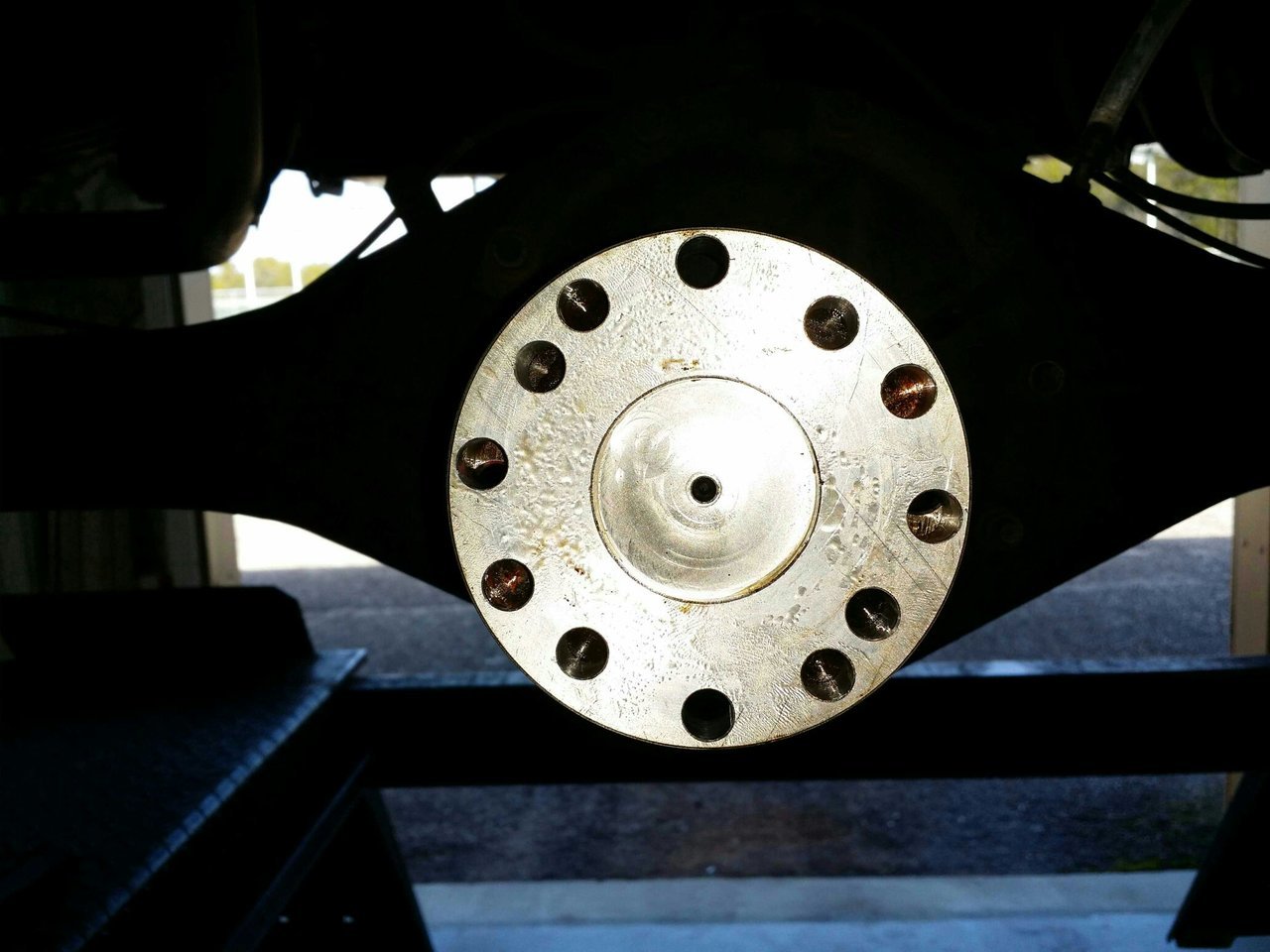

    Ok wait I'm confused now...so the 65x65 fits both of the flanges?? The triple drilled one I bought has the 65x65 pattern on it but doesn't fit mine. So I would have to get the 66x66 then?

    Yeah that doesn't make any since.
    If you have a 66x66 flange the 65x65 should work but only with 10mm bolts.

    well....................i am a complete retard............................lol :eek: now I actually looked at what sizes the triple drilled offers.......it doesnt even have the 65x65 on it........no wonder it didnt fit lol.
    it has the 60x60, 60x68.5, and the 61.5x70
    thats what I get for rushing to buy the spacer and not looking at what size was what and assuming the 65x65 was on it...oh well...lesson learned...READ before buying lol

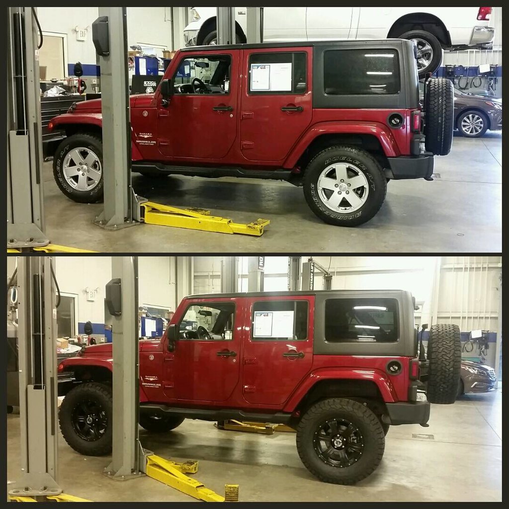

    My project for today. I am so over these damn jeeps. But gotta say, it turned out really good.
