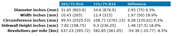

    so with my size its about 18.8% increase then from what I originally had. going from 265s to 315s is 50 then / by 265 is 18.879 or 18.88 rounded up

    You need to do it based on 265's even if your truck came with 245's.

    ya thats what I was doing, taking that number from the 265s and thats where I got 18.88% from

    Need to recheck your calcs, should be right around 10% difference.

    I was going off of what frank posted, 315-265 = 50, 50/265 = 18.88%....im assuming in not doing something right

    :facepalm: you're comparing width.

    10% is close enough to the 9.3% of the stock difference.

    Use 10%, it's close enough.
