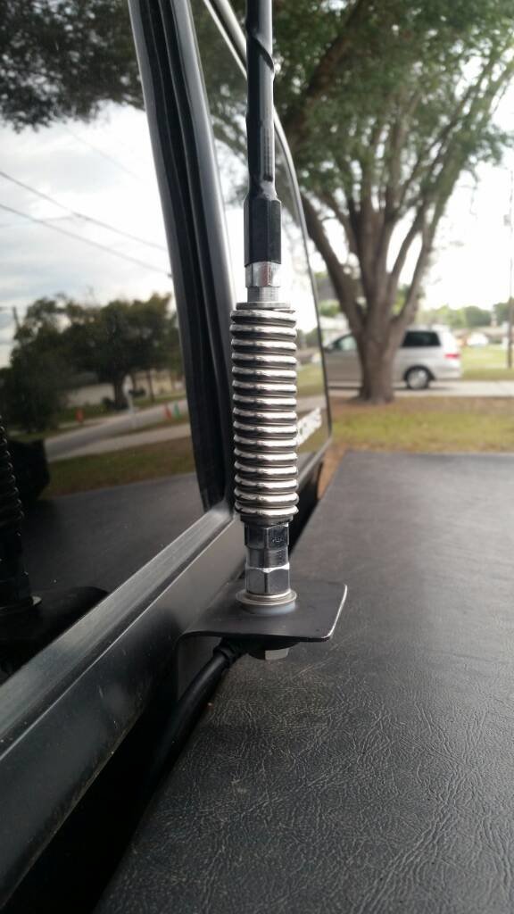

    Well yeah the one screw went in fine and the other sheared off as I was tightening it. Then mounted the antenna and the mount just rotates under the high speed I guess

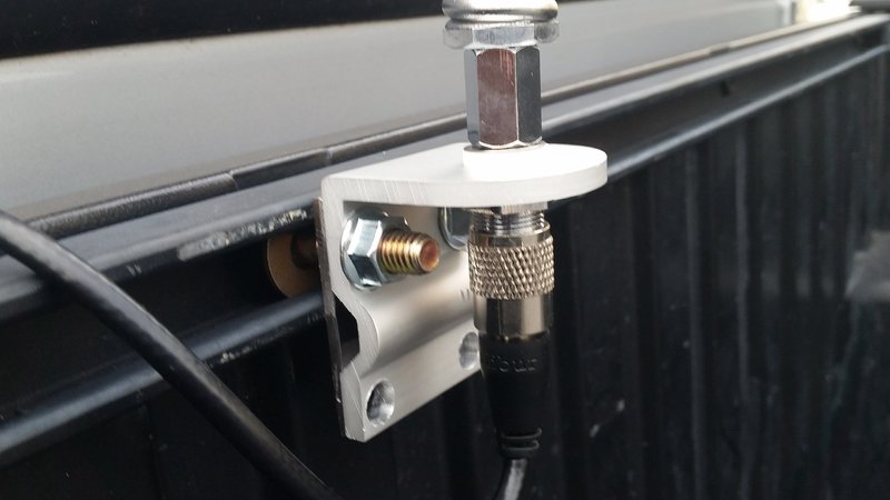

    I've got a aluminum mount backed by a metal plate so it sits right on the track. I'll run a ground wire to the mounting bolt

    get some washers or t-slot nuts and bolt it to the bed rail

    @TAZ2014Taco get some 3/8 bolts and washers to slide through track. How I mounted mine

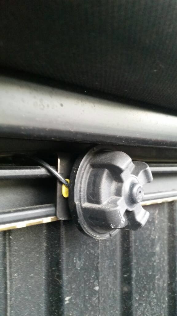

    I used the bolt & knob from one of my tie downs. You can see my ground wire behind the knob. I had to make my own mount so I could use it with the bed cover.

    that looks good!
