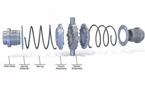

    No, it is sealed within the rear end housing. The design has two ratchet "plates", these are pushed against a center spider with mating teeth for the outside ratchets. A left and right spring keep it clamped or locked all the time, unless the tire force is sufficient to unseat and ratchet the plates and spider. That's why sometimes these locker will either chirp tires like a spool or you can hear them clacking away.

    Detroit Locker
