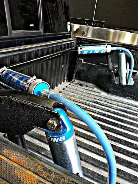

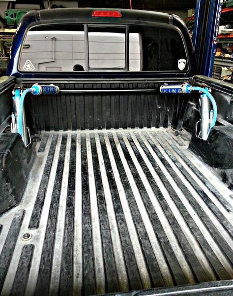

    Out of curiosity do you guys think this would rub with chevy 63s sua? 0_o
    asking for a friend :anonymous:

    IMHO, it depends on the tire size, but I'd say: hell yes, probably worse than Frank and Paul with all the tubing hanging off the sides of those shocks. Might even be bad enough to destroy the shock by ripping one of those tubes off. Of course, I don't think it would be limited to having 63s either. It would probably happen with any other type of leaf spring as well if he fully articulates it much.

    Yea those shocks are 2.5” in diameter so also wider than what im running not to mention the bypasses

    I'd also feel compelled to add, I'm not sure what's going on there, but it looks like those towers are mounted to the composite bed directly. Unless they are attached to the frame somehow underneath, it looks dangerous as hell.

    I think they're attached to the frame too. I just like how it takes up space in front of the tires and you can keep the bed. Anyone got pictures of the inny?
