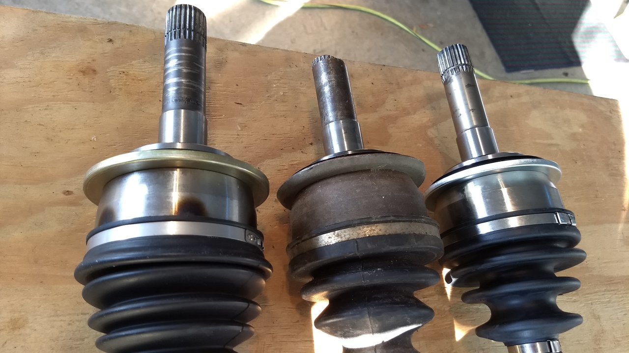

    Well, the OGT is officially 4WD again. Got a NAPA Max Drive CV axle for it this time for those that weren't following the Annual Meet thread. On first blush, it looks a lot more like the factory axle than the Autozone ones I was using, so I was cautioualy hopeful that it might hold up better...but then I did a side-by-side comparison between a new Autozone DL Gold axle, the OEM Axle, and the NAPA axle. Frankly, the NAPA axle scares the shit out of me. I still put it in and I'll see how it holds up, but I have a feeling I'm going to regret it.

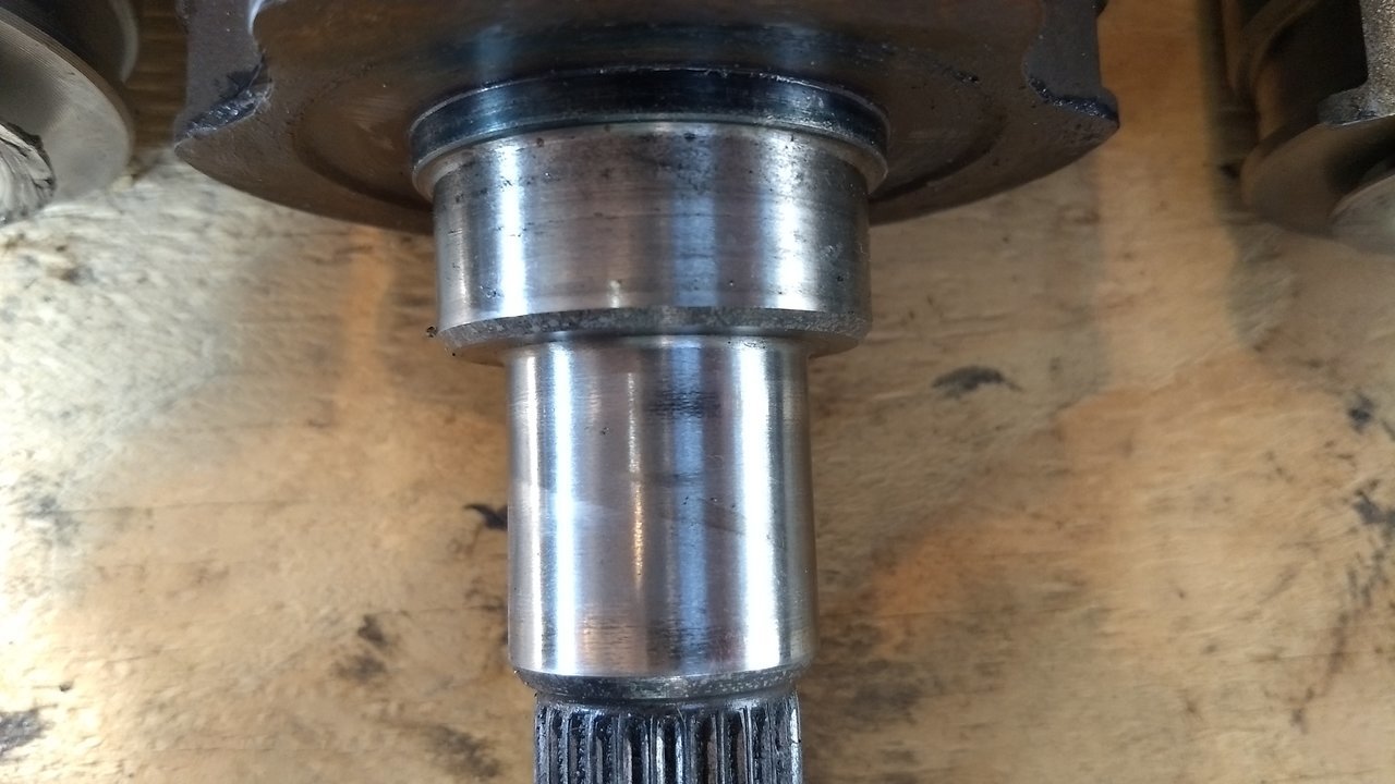

    OEM inner stub...

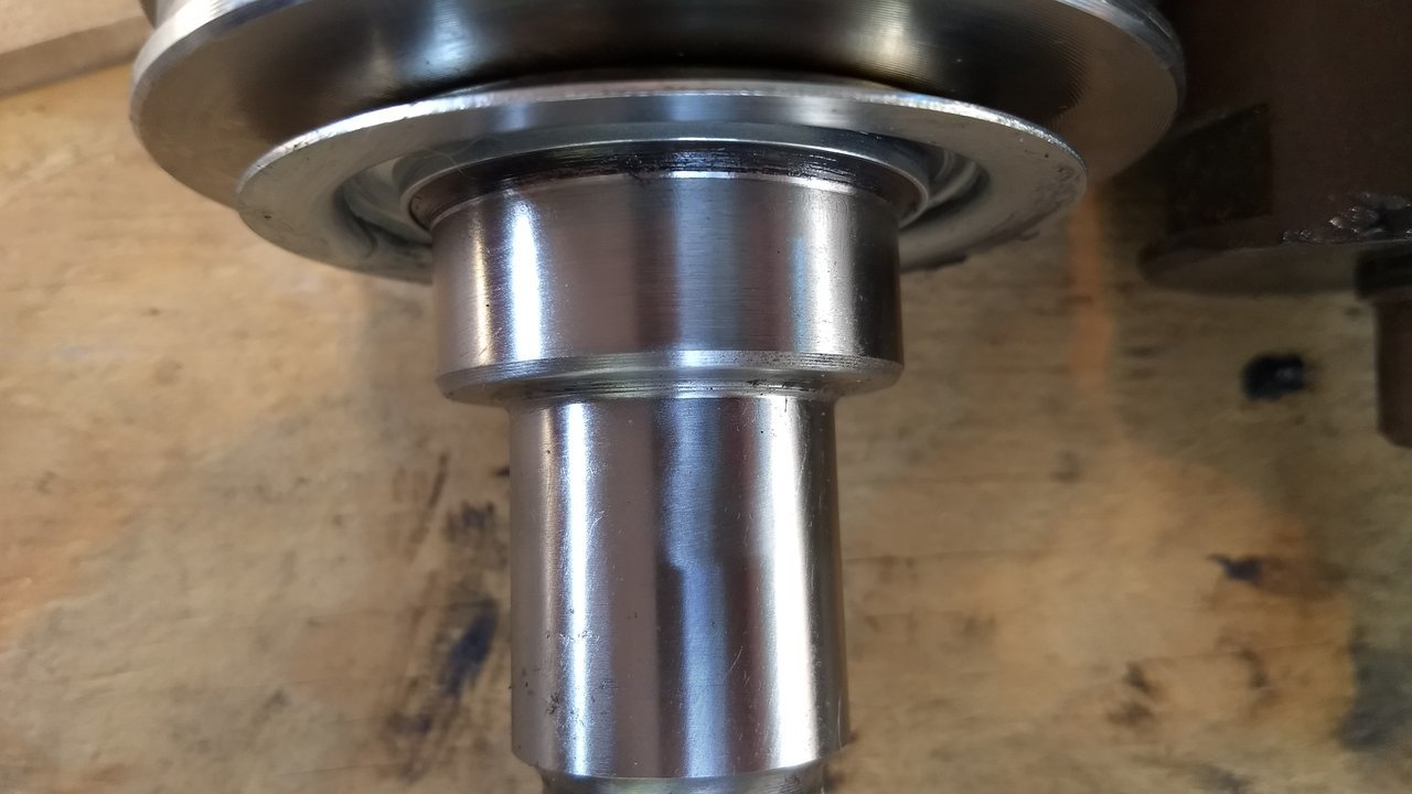

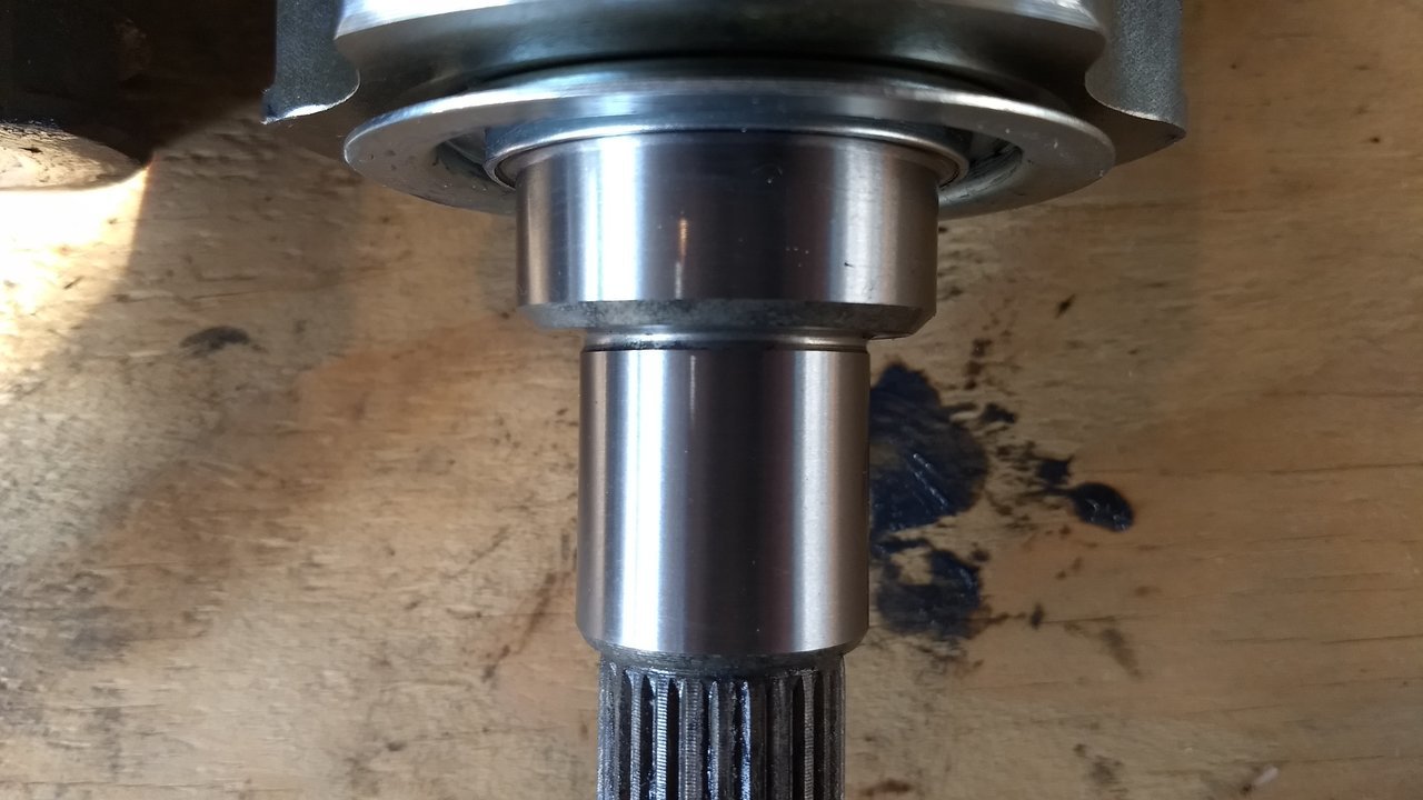

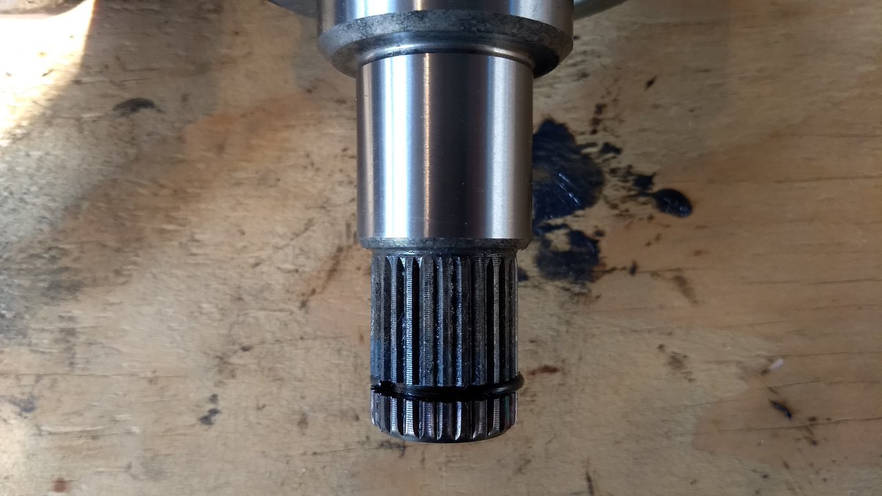

    NAPA inner stub...
    Note the groove cut between the bearing and sealing surfaces. Failure point. Also note the lack of radius between the bearing surface and the splines. Failure point. This is some scary shit. If it snaps those splines off, the only way to get it out of the intermediate shaft would be to drill and tap the broken end so you could thread in a slide hammer to try to yank it out. If that doesn't work...well, I'd be screwed.

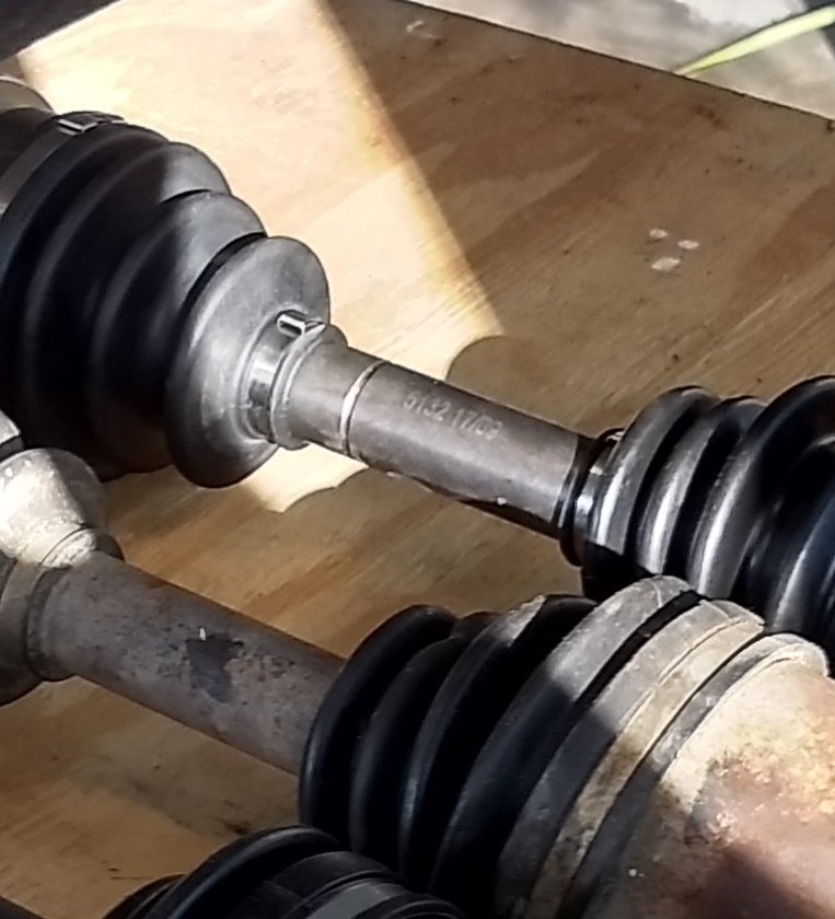

    Then there's this...
    It kinda parallels my idea of the half shaft having an engineered failure point, but fails to address what happens when it does fail (the broken ends slaming around into your suspension and steering components).
