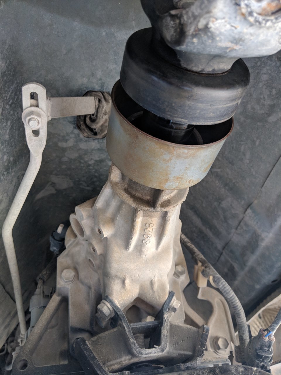

    I have a very small leak of transmission fluid and while I'm hoping it's just the seal....does my drive shaft look short?

    Yes, it looks short. @Hugopreston had the same issue with his 3rd Gen T4R when he got a different drive shaft for it. You might need to get a driveshaft spacer because I'm pretty sure those cups should be inside each other, but you also need to check and make sure they don't bottom out when your rear suspension is compressed. Best thing to do, although I'm not sure how you'd do it without getting a transfer case, would be to get a driveshaft with a slip yoke on the driveshaft itself like 4WDs have.

    I should note that i have a one piece drive shaft. Im about to go measure the diffs to see if there's a difference (im sure the is). Would this cause a slow leak or do you think the seals gone?

    It did with Hugo's 3rd Gen T4R (also a 2WD with a one piece shaft). Your lift could cause it too, although I'm not sure how lifted you are. The guys running Max Tracs had to get driveshaft spacers to get the driveshaft back in the cup. I know most of them have two piece shafts though. @Timbo's Customs would probably know more about this than me to be honest though. :thumbsup:

    I ordered a 1.5" spacer which should fix it. Only problem is it comes in a week :annoyed:

    I have a spacer sitting on my shelf. It’s a inch and a quarter. I removed it completely when I did the 63s

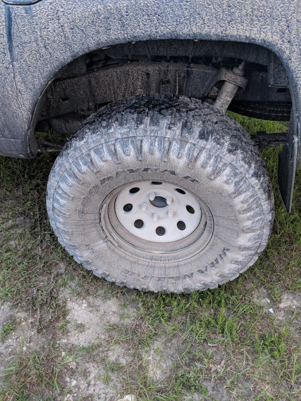

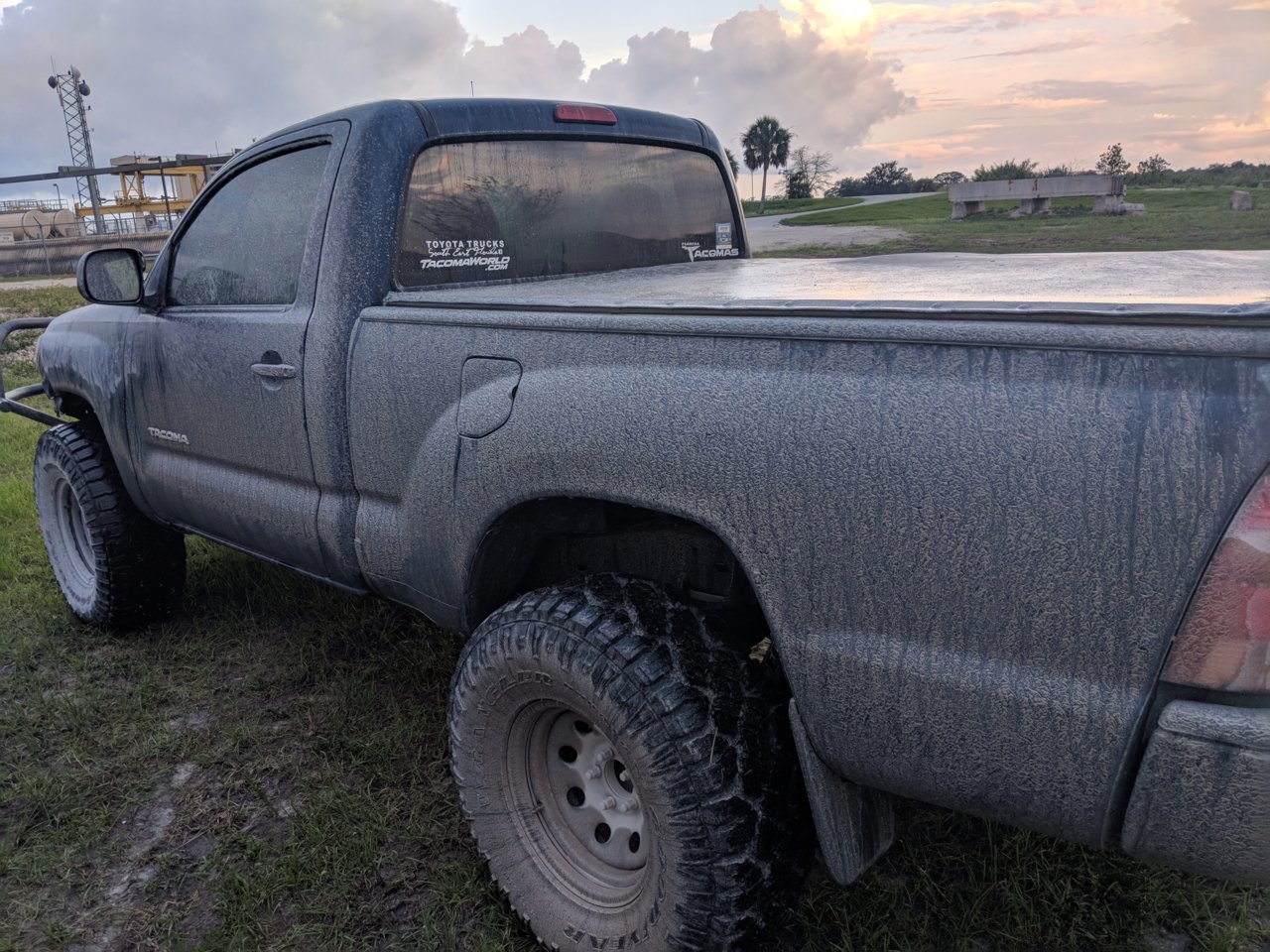

    Got to get the tires dirty this weekend. Bonfire meet out at holey land.

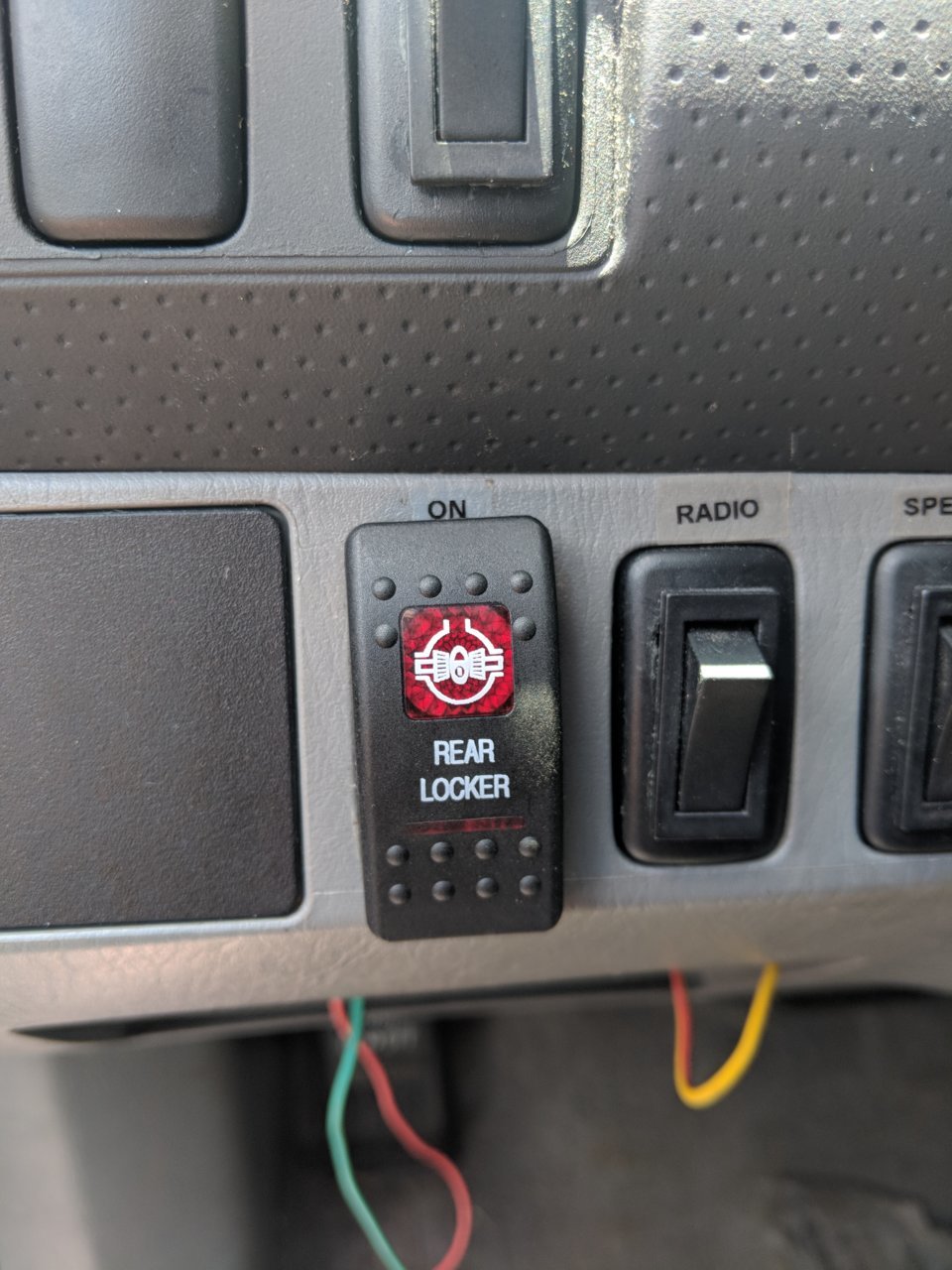

    Also got my fun switch finally wired (didn't use it or need it this weekend lol)
