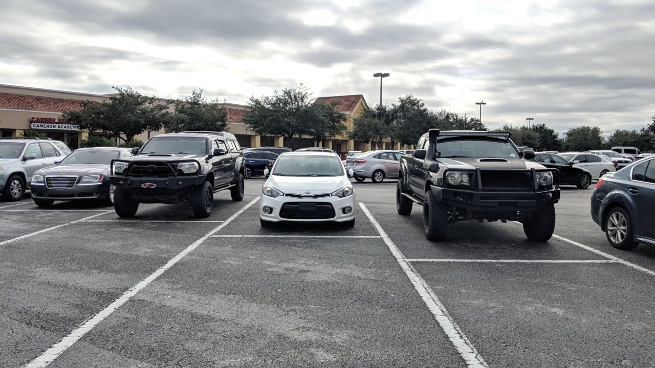

    Anybody recognize the truck on the left?
    Fab Fours front and rear bumpers, Zeon winch, high rise shell, bolt on sliders, had USMC vet tag on it. On stock suspension no less. :notsure:

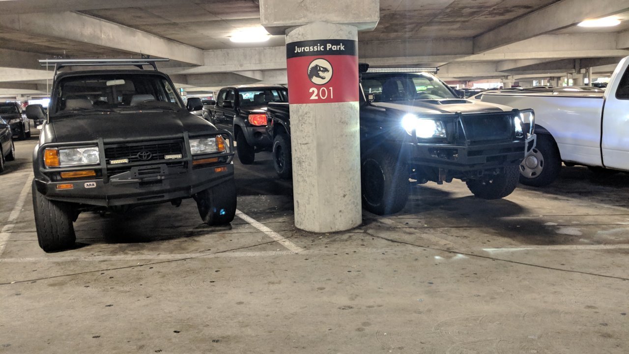

    Saw a cool 80 who parked next to me the other day too.
