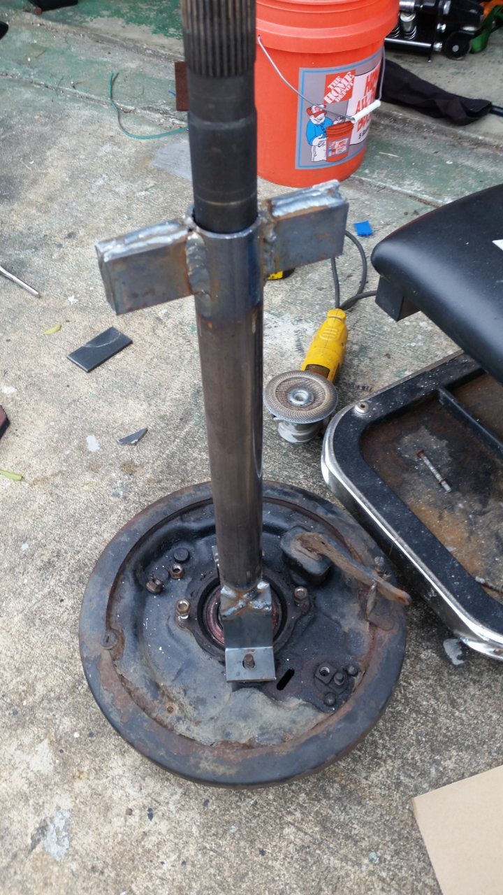

    Thanks Manwho and Lee!
    I'm in the process of making the SST, just need to gusset the bottom that bolts to the backing plate and I should be good to go.20181228_140447 (1).jpg

    Yup, I've got one (cut in half axle housing). One thing I would recommend on your setup, is making it so all 4 of those studs can be bolted to the SST... I'd hate to see the threads on the two of them that are being used be stripped clean off.... as you probably already know, it take a lot of pressure to pop that bearing and collar loose
