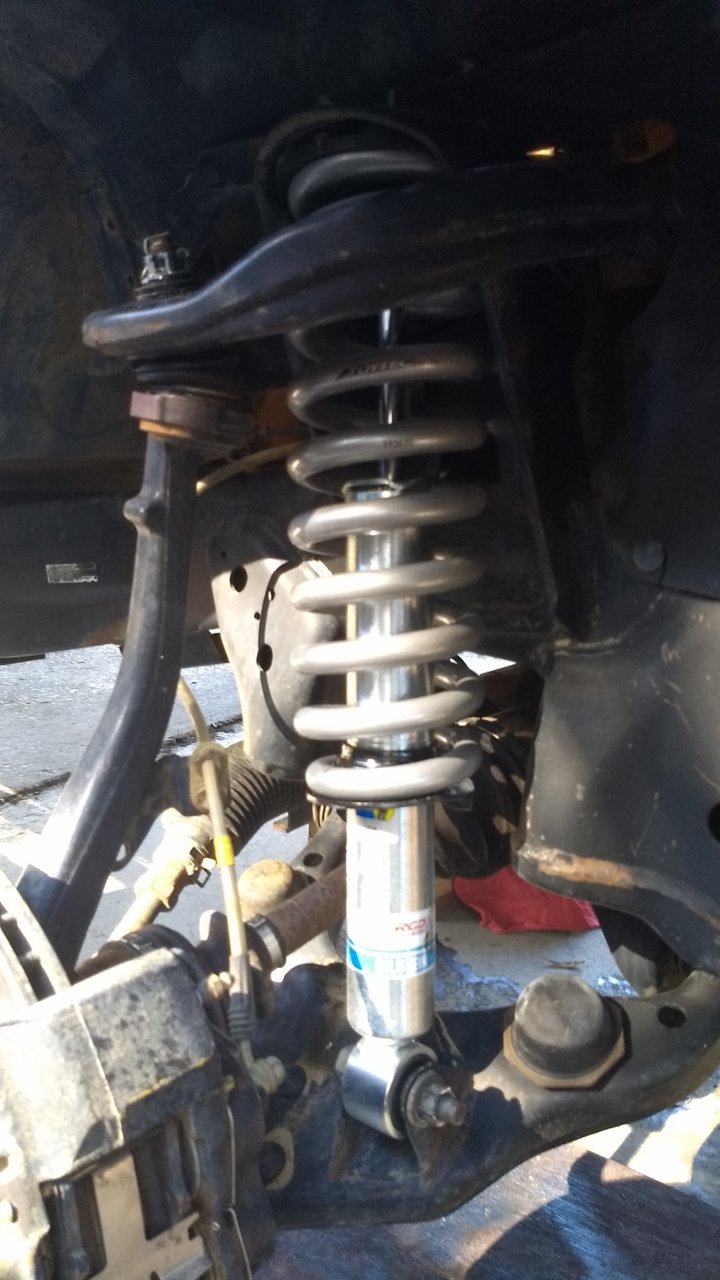

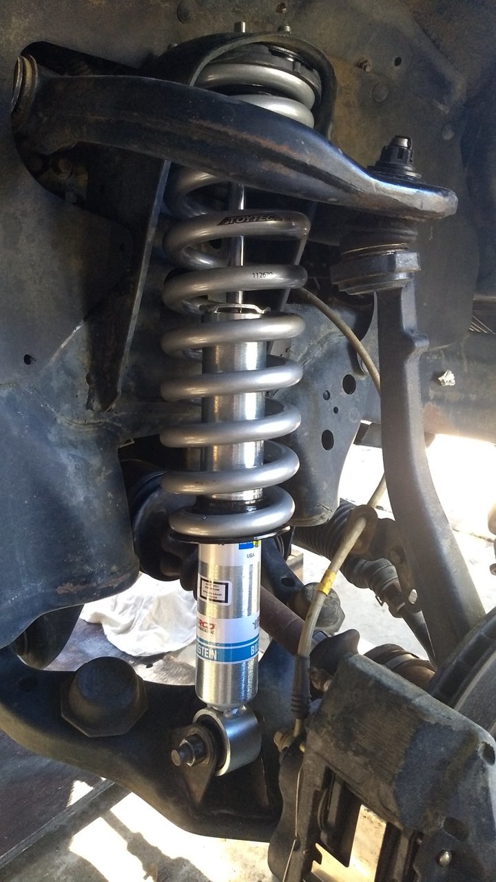

    Well, this is done...I think they are a little stiff, but that will probably be a good thing in the long run. Of course they could soften up after they get some wear on them, but either way, I guess.

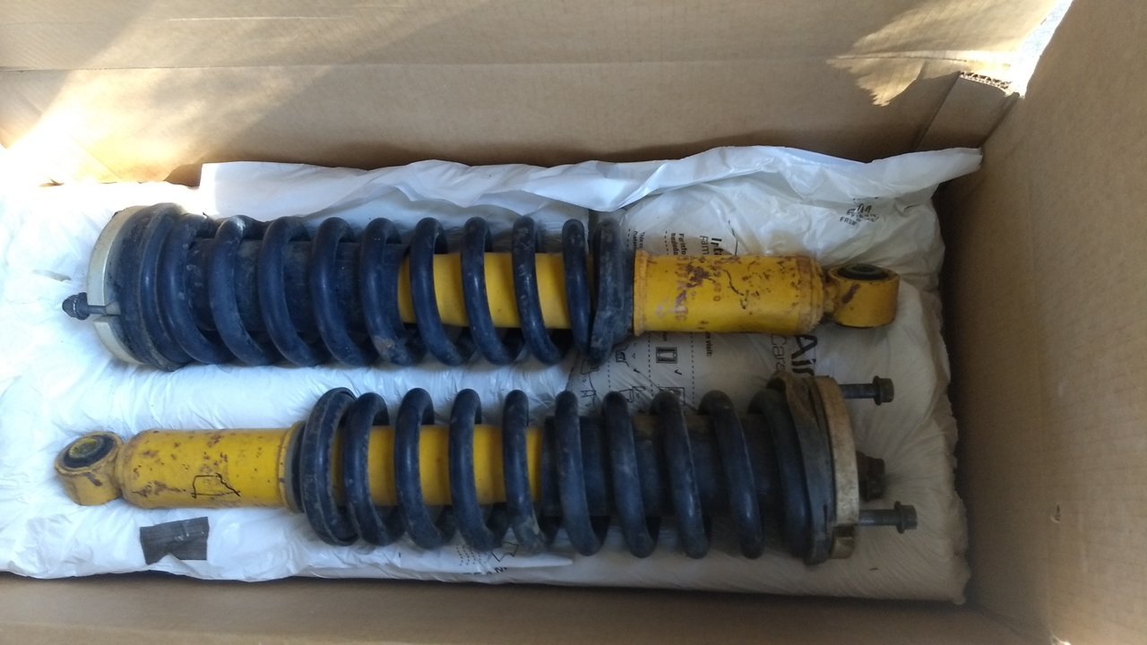

    Poor Natty gets the OGT's cast offs...
    Edit: The interesting part of those first two pics is that I've actually had a non-factory set of CV axles long enough for them to get all rusty looking. o_O

    I've been thinking about it and it occurs to me that it may not be that the new coilovers are too stiff. It might be the opposite. I think they might not be stiff enough and are slamming down on the front bump stops pretty hard. I'm gonna put some grease on the bump stops tomorrow and hit a few speed bumps and see if there's any grease on the pads. If that turns out to be the case, then Natty might just be getting those shiny new coilovers after all and I'll be seeing if OME 883 springs will work with 5100s.
