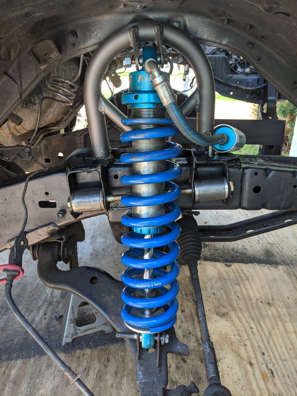

    Got a lot of stuff lol
    Now onto remaking control arms that fit properly.

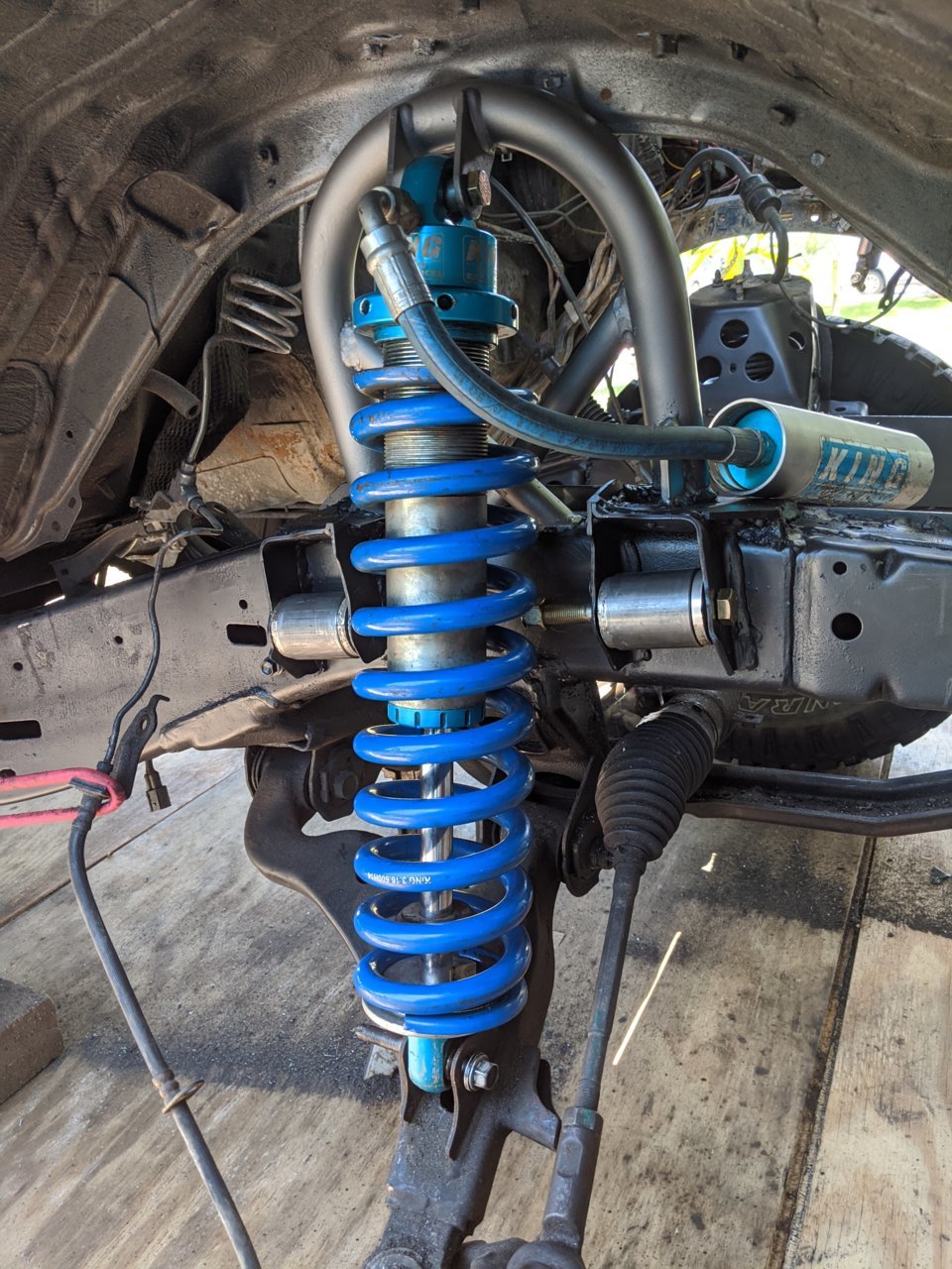

    Upper shock mount needs to be parallel to the lower.

    It is. I just didn't take the photo square

    See what I’m seeing?

    The shock is straight and the uniballs on both ends have plenty of room to move. What would the ends being slightly off do?

    It can cause binding. Also under movement can cause the shock to twist up.

    Will is correct. The bolts need to be parallel with each other in order for the shock eyes to have full ROM.

    Ok that shouldn't be too bad to change out the top shock mount. I'm actually really stuck on my upper control arm right now.

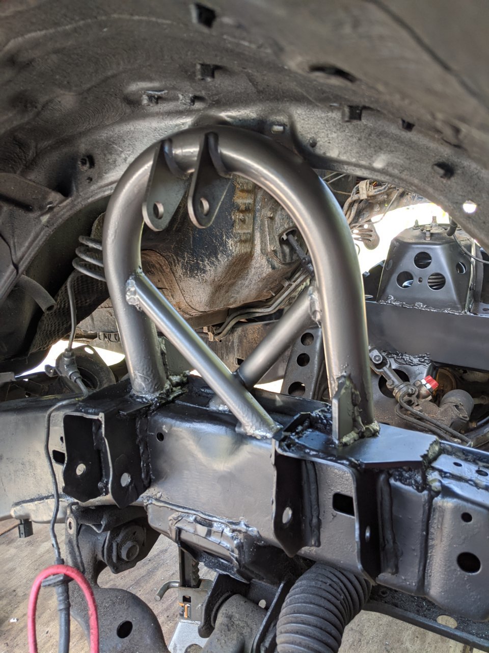

    I’d make sure those welds are solid and have good penetration.

    This. And more bracing ifs outs a huge load on shock points

    I've added some extra gussets and when I'm done with everything I'm going to do a crossbar between the hoops.

    For the application you are trying to do I think you need to run some shock hoops that are more trapezoidal shape rather than the standard U-shape so that they mount to the sides of the frame rails beyond the upper a-arm tabs and run your braces from the tube to the top of the frame rail. The braces you added arent going to do much in the way of distributing forces and brace the hoop on how the forces would be acting on it. There may be other options out there but a hoop similar to this style would be better for your application.

    The more I've been looking into it I think I may cut out the hoops and go to a tower instead. I need to check a few more measurements but It looks like the ruff stuff 9.25 tower would fit.
