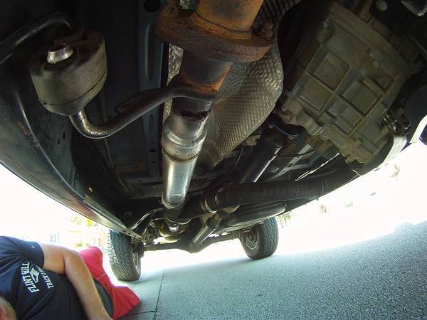

    crossmember is the part of the frame that links both sides. the part of the exhaust is called the crossover, y-pipe, etc.
    i did exactly that a couple weeks ago. i'll go snap some pictures for ya

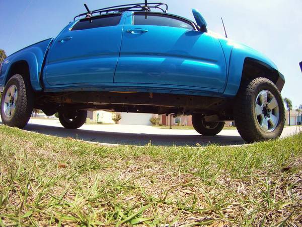

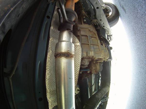

    here ya go......
    bumped it up to 2.5 inch pipe
    all tucked up under the frame

    I wonder if this mod will interfer with a 1 peice driveline? Is it true if you switch to a 1 peice you get less vibes and its better? I just heard guys swithcing to them after lifts and shit.

    btw clean work and nice truck!

    it's better and worse.
    pros:
    -no more vibes from lifting
    -stronger (this is a maybe, because tacoma drive shafts are already huge compared to most other vehicles in our weight and power bracket.
    cons:
    -you lose some ground clearance off road
    -you create an angle where the shaft meets the transfer case (or transmission for 2wd) that wasn't there before.
    axle shims may still be a good idea with a 1-piece, not for vibes, but to help the angle of the differential and the shaft
