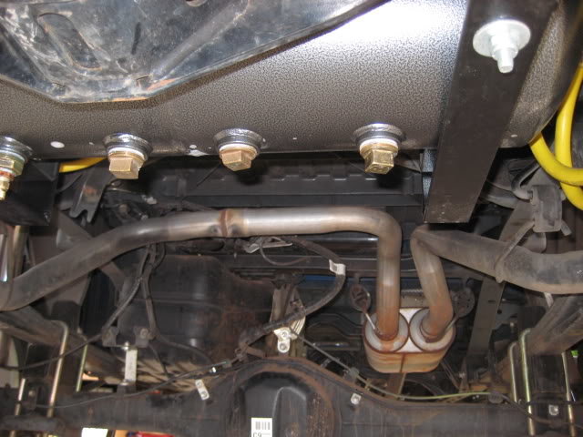

    Is this how yours looks?
    How can that be good? The piping is the same level as the rear end?:confused:

    Yeah, that's about right.
    That picture doesn't have the spare tire in there. Again, not a lot of room to work with. I'll have to take some picts sometime tomorrow.

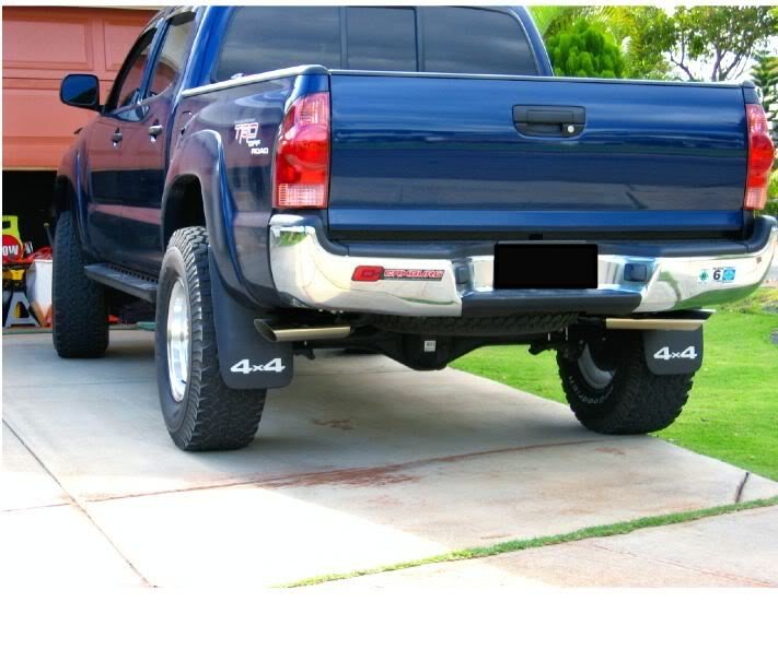

    I had a local shop custom install mine and the pipes run around the spare.
    I can take better pictures later but you can see my spare in this picture.

    No I got the Flowmaster off the Summit racing website. The stainless tips I got off EBay.
    Total including the custom install came out to $420.00
    This is what it looks like, sorry it's dirty.
    The spare would still fit but I have since installed an on-board air system.;)
