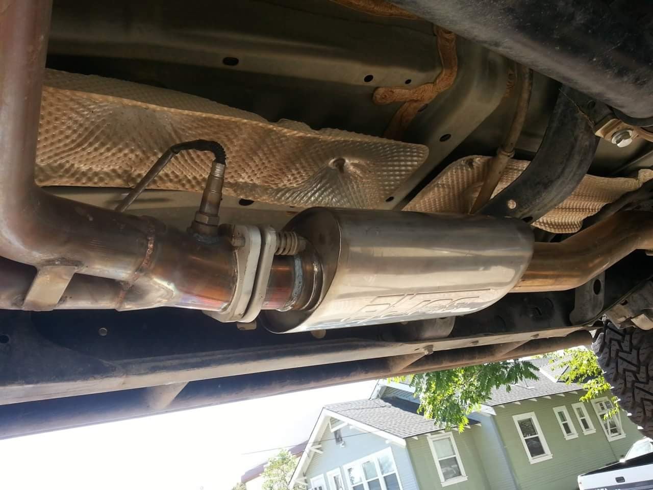

    Add a small muffler after the ypipe, like a borla xr1. Kills the drone, thats the answer people in your situation have used for years on these trucks.
