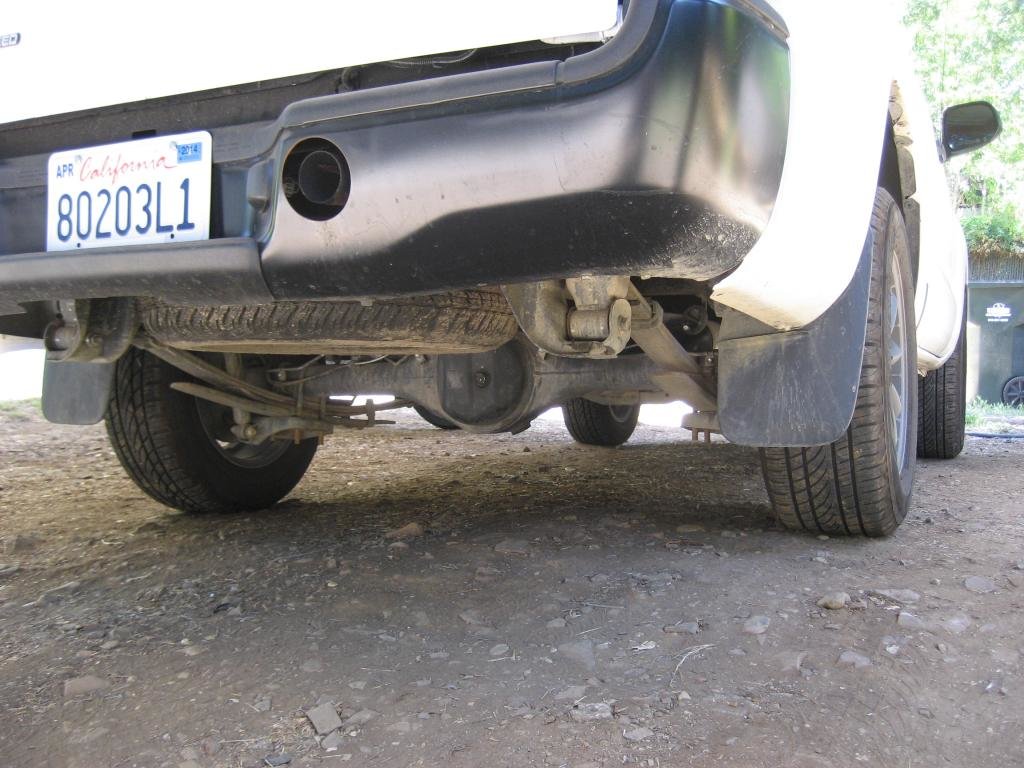

    My approach is exactly the opposite of a high performance car like yours. The Tacoma 2TR FE 2.7 is a very slow turning industrial engine with a redline of only 5,600rpm. It's designed for low end torque and not for top end horsepower. Mine hits its peak torque at only 2,900 rpm. And at that low rpm the exhaust system is underutilized and needs to provide enough backpressure to retain torque..
    Since I already discovered by experiment that opening up the exhaust on this engine killed the low end torque, I don't need to go there again.
    Right now I have a large 22 inch straight through MagnaFlow with a small 2.25" diameter exhaust pipe run out the rear bumper...
    ...so that will be the "before" dyno test.
    Then I'll have the Flowmaster installed with no other changes, and do an "after" dyno test. Then I'll overlay the two tests to see what the actual difference is. I really don't have the slightest idea which muffler will produce more low end torque...
    ...so the fun will be in finding out. :)

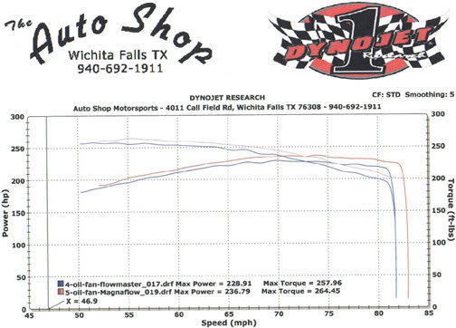

    I've been reading MagnaFlow versus Flowmaster threads for hours, and did happen to find this one dyno comparison which gives the nod to Magnaflow. I don't know what truck engine it is because it was posted by a second party.
    The consensus seems to be that Magnaflow's straight through design is what gives it the performance edge.
    I'll make the dyno tests as equal as I can so the results will be reliable.

    Whichever muffler ends up coming out on top.. You should send the results to the co. They might reimburse your dyno costs for marketing purposes.. Since flowmaster and magna are the two big competitors

    My theory proved. One thing I can say is I did have some drone with the Magnaflo. Sounded great on a V8 but that low end drone would tire me sometimes. Maybe it's not as bad on a truck since the muffler sits under the bed and not the cab.
    Bottom line either one should make you happy

    Yes, the old tried and true straight through has an obvious physical advantage, and my "muffler shootout" experiment will likely confirm that.
    But the newer Flowmaster 50 series has two Helmholz resonators to cancel the unwanted sound frequencies instead of sound deadening packing. It also has three angled flow plates which create low pressure areas to scavenge the exhaust. It also has a cleverly designed internal "funnel" that the exhaust passes through. This funnel acts as a one way valve to prevent reversion of the exhaust pulses leaving the muffler which keeps the exhaust flowing in one direction.
    I also had cab drone with the 18 inch Magnaflow on my Taco and the stock metric 2 3/8" diameter pipe. But there's absolutely no drone with the larger 22 inch muffler and a slightly smaller diameter 2 1/4" exhaust pipe. So it's just a matter of pairing the right muffler to the right size of exhaust pipe.
