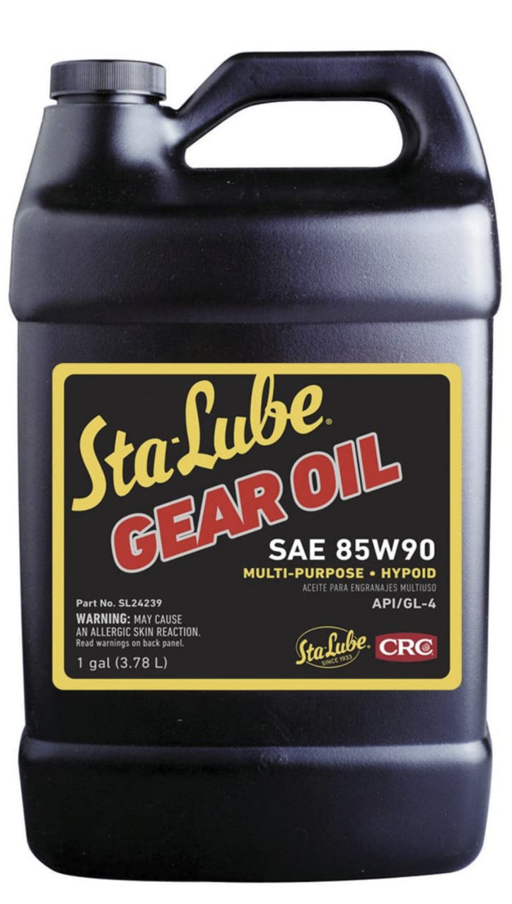

    This is what I use. I have tried MT90 and honestly felt no difference between the two with shifts. It’s usually available at NAPA stores.

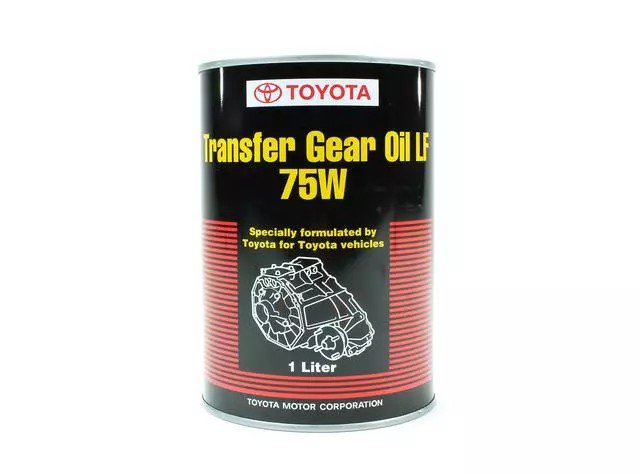

    Extract from the 2015 the manual mentions
    Gear oil capacity (Reference)
    2.7 L 4-cylinder (2TR-FE) engine
    4.0 L V6 (1GR-FE) engine
    2WD models
    2.7 qt. (2.6 L, 2.3 Imp.qt.)
    4WD models
    2.3 qt. (2.2 L, 1.9 Imp.qt.)
    1.9 qt. (1.8 L, 1.6 Imp.qt.)
    Gear oil type Gear oil API GL-3 (GL-4)
    Recommended gear oil viscosity SAE 75W-90
    Not that to say there isn't one but I have never come across a single manual trans that specified GL-5. My old mustang 5.0 used Dexron ATF in the manual trans so that doesn't count...
    Would stick to GL-4 for trans.
    Now in the beginning I was adamant that transfer cases have no synchro's but someone showed me i was indeed incorrect and there was indeed one synchro ring and yet they specify GL-5 for my transfer case. Is it maybe a different material that the ones on manual transmissions I have no clue. I just went by the manual and changed everything to 75W90 Gl-5 Amsoil severe gear (I have an automatic trans).
    And all this is particular to 2nd gen of course.

    Thats what is specified for the current transfer case not the 2013. And its ridiculously expensive. Everyone here with a 2nd gen is running normal 75W90 Gl-5 (or possibly GL4).
    You only need 1.1 quarts and a quart of 75W90 Amsoil GL-5 is $23. Once again. Refer to the manual.
    Its interesting. On amsoil website it list both the GL-4 and GL-5 lube for your transfer case but only the GL-5 for my 2015
    These show the 2013 as having transfer case model U/K - TRC and for my 2015 VF2BM so it appears they are different
    Black97v6MT[QUOTED] likes this.

    thanks for the info!
    can it (the 75W) still be used on a 2011 transfer case with no issues?
    i picked a liter up when it was almost half off MSRP for a 2nd gen regular cab with AT i am looking after
    that truck has factory transfer oil still at 94k miles and 13+ years
