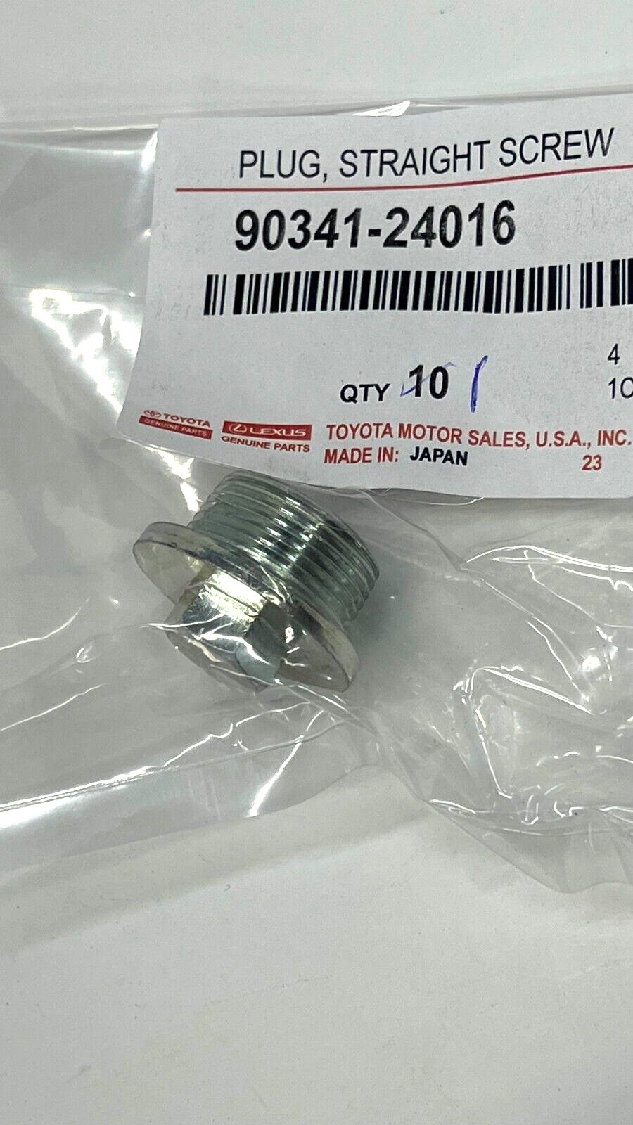

    And given a nice warm days and at most 90 minutes you can do this all yourself and save the $500. And every one would agree the front diff drain plug is a royal pain and many have gone to the lexus version that uses a hex head vs allen key for that reason

    is that lexus plug Less Tight on there?
    i was breaking a factory 13yr installed plug with a 1/2" breaker and very little clearance to the concrete below with the driver wheel off for close access

    Its not that its less tight. Its that you can use an actual 6 sided hex socket instead of the so easy to strip 10 mm allen key. They both use same torque settings.
