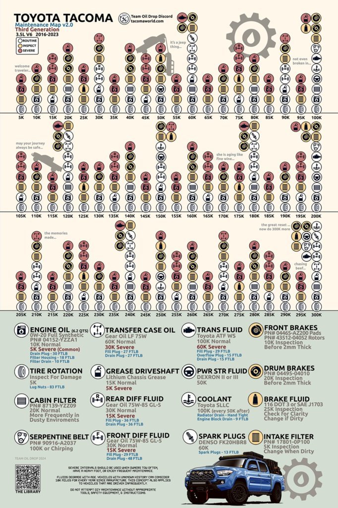

    Search for the "3rd Gen maintenance map."
    60k is going to be the big one. I would start budgeting and stocking up on fluids/filters/plugs/socket extensions as that one approaches, and be thankful that it's only at 50k today. Other people prefer to split it up and do some things early.
    I chose to wait and do it all at 60. I made a nice weekend out of it, with a full supply of coffee for the AM work and beer for the PM.
