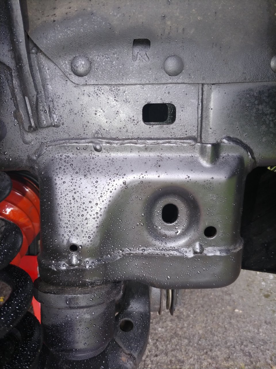

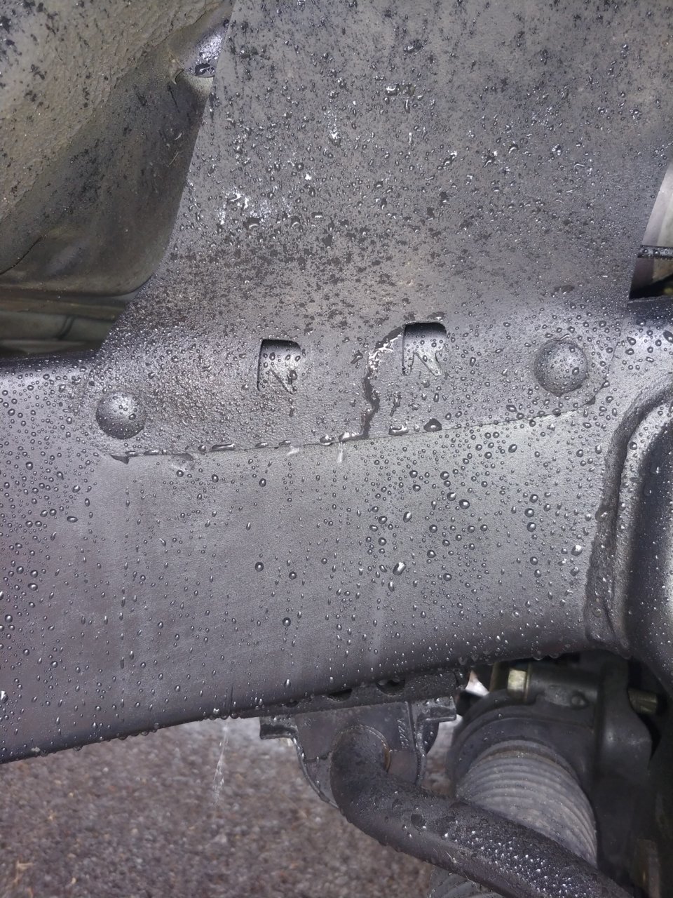

    It may not have actually washed off. Just because you can't see it doesn't mean it's not working.
    Here is my frame after applying fluid film in November. We've had 37 inches of rain in 2020 alone. It still beads up like it's been waxed.
