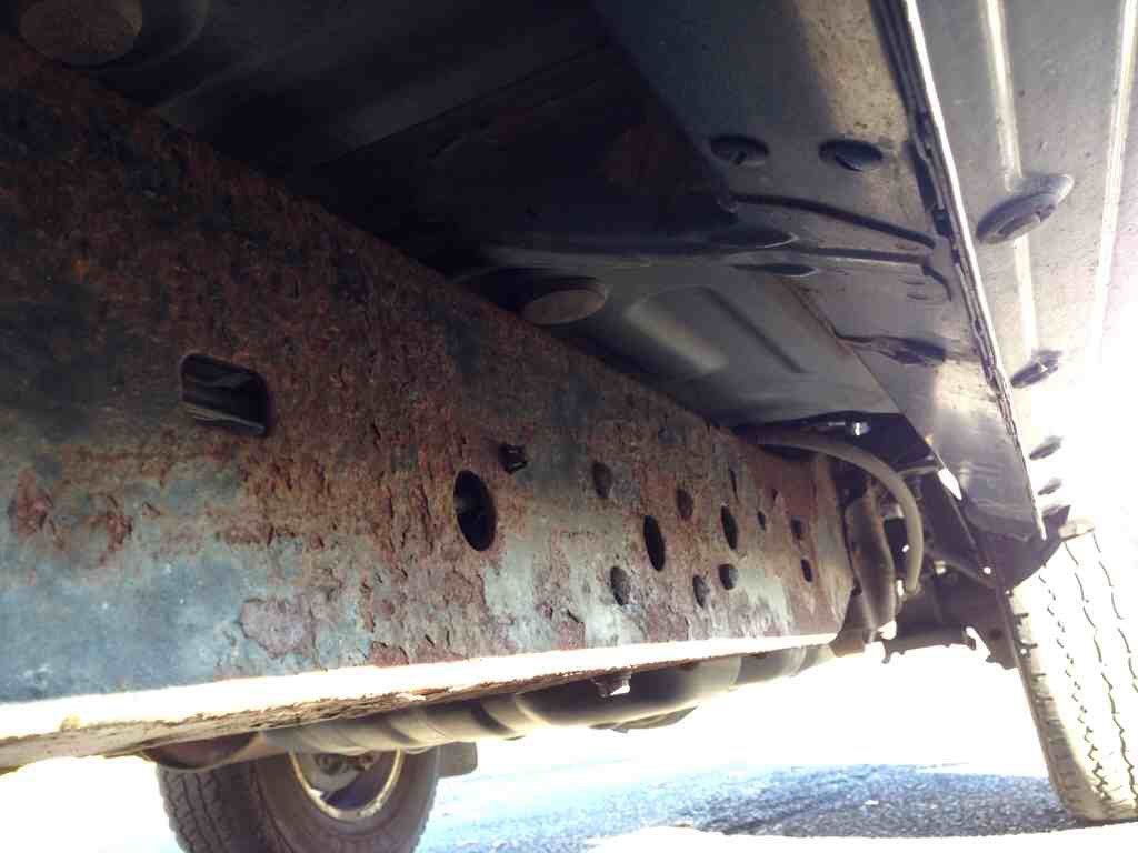

    I think I need to get on the ball with the rust...
    Will the fluid film help with active/live rust?

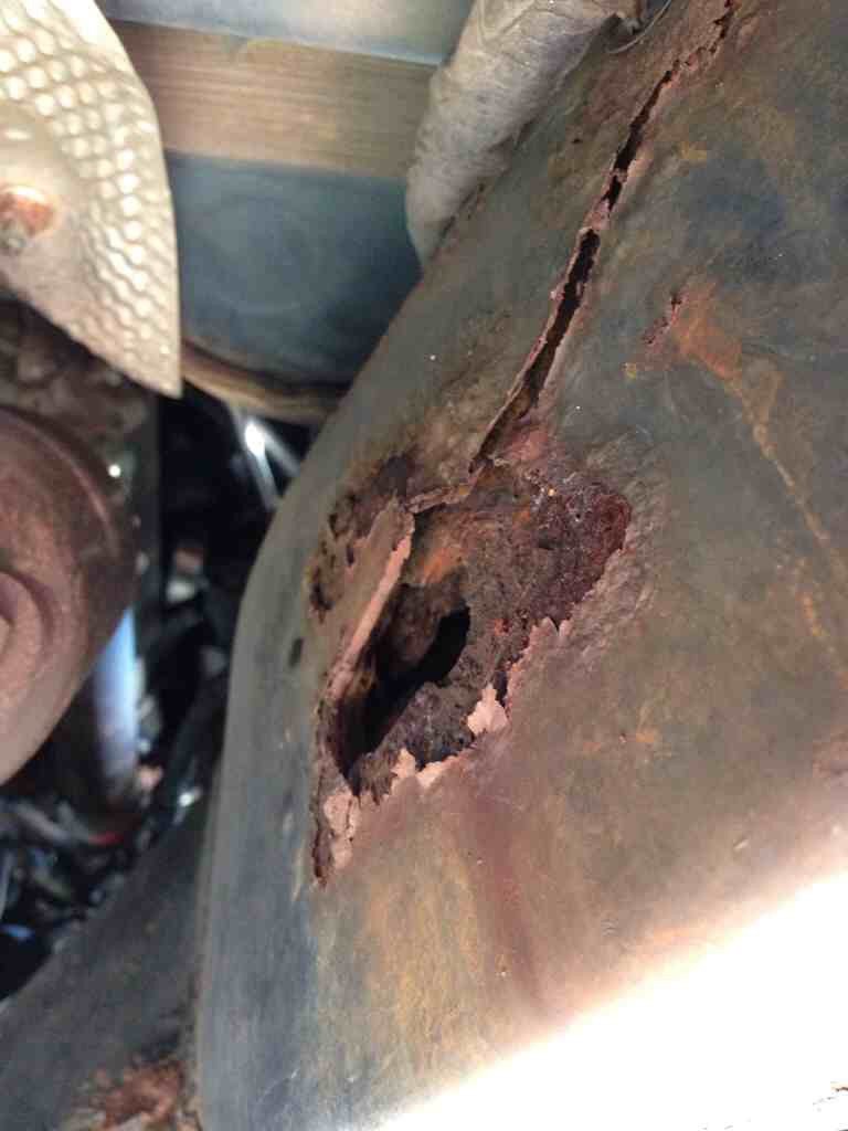

    It may help slow it's process, but it's not going to fix that hole.

    My '05 in the salty north looks waaaayyy better than that! I'd start scraping and wire brushing that rust pronto, paint then put FF on.

    My 03 was that bad or worse! I achieved success with rust converter (the milky stuff) and then rustoleum after the converter cures. You want to remove loose rust scale but not down to shiny steel. The converter chemically reacts to the rust and the topcoat seals it. Eastwood internal frame coating is a must. Easy and fast, best investment you can make in your frame. I made it with one can but two would be choice. Nobody wants to do the prep work but this is the only way before spraying fluid film or any protectant

    Before you do anything yourself, you need to make an appointment with a dealer and get your frame rot documented. Especially that hole. There have been a couple reports of individuals getting frame replacements from the factory/dealer.
