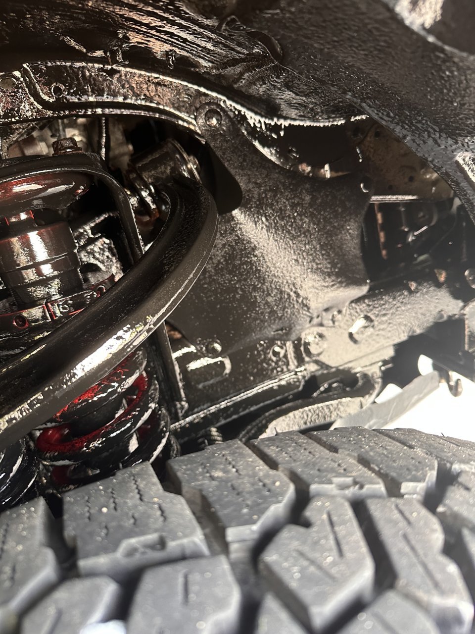

    I had fluid film applied a weak ago. It smelled awful, but gradually dissipated.
    This morning I drove it and no smell, but now my truck squeaks and creaks over every little bump.
    WTF? Is that from the FF? It never made any noise before now.

    Do they spray every nook and cranny of the shocks too?

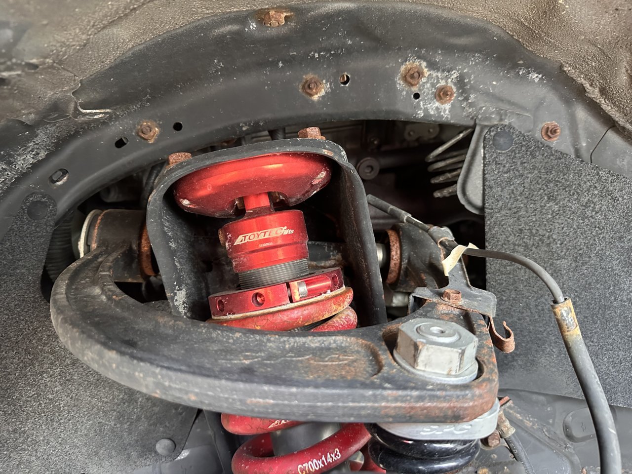

    That’s how mine looks after. But they don’t use the same coating, it isn’t red, so there may be something to your suspensions.

    Toytec shocks are red from the factory.Here’s how it looks pre application. :)
