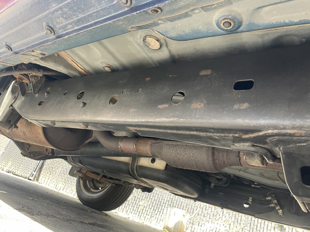

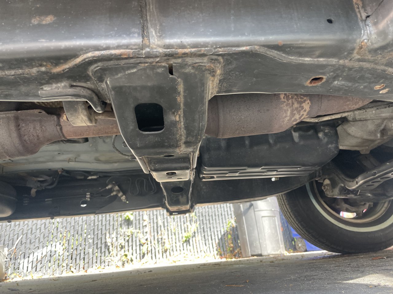

    Hi I am looking for more info on fluid film undercoating what do people think of the product my frame is still in good shape am hoping to keep it that way what do you think of product are there any downsides to using fluid film on a truck frame are there better products and what do you think of my trucks frame?

    Just coat it, you will get alot of opinions on what is best. As long as you steer clear of rubberized undercoats and stick to something oil based you will be good.

    It works. But its a messy pain in the ass and needs to be applied every year. Your frame looks good. I wouldnt bother , but that is just me.

    If you have an air compressor to apply fluid film then ok. I tried fluid film early days into ownership and found that it washes away to easily. That one picture posted does show some rust the proper way would be to wire wheel the rust off and use hand wire brush, Ospho rust neutralizer , Eastwood primer, Eastwood black Chassis paint and then Amsoil heavy duty metal protector. This procedure should be applied x2 i.e. 2 coats of primer letting dry between coats then 2 coats of chassis paint 2 coats etc. I would use Eastwood internal frame protector with the 360 degree spray nozzle attachment.
    This is my procedure for frame maintenance its worked for me.The trick to having a solid frame is still build a layer of coatings over the years. I would not just apply fluid film over rust. USN adage ( 7P) Proper Prior Planning Prevents Piss Poor Performance. GL Winter is coming.
