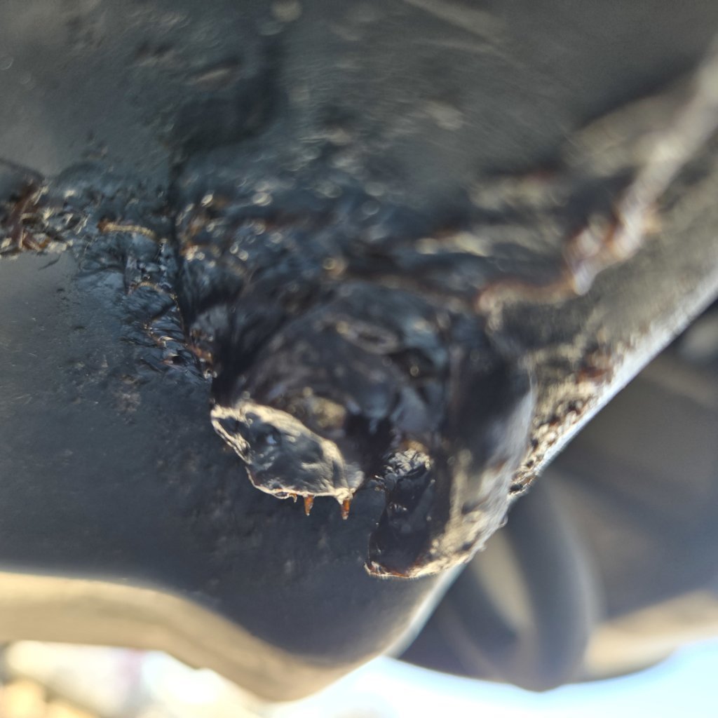

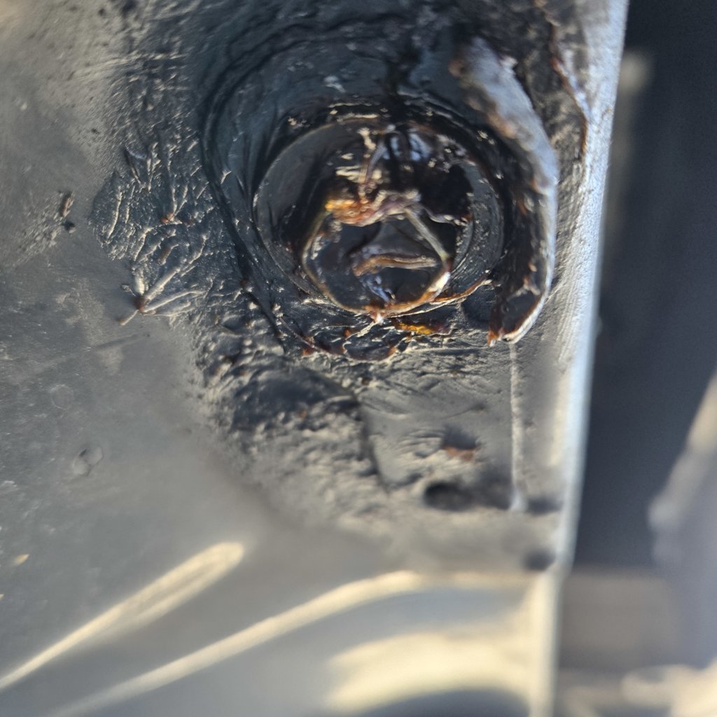

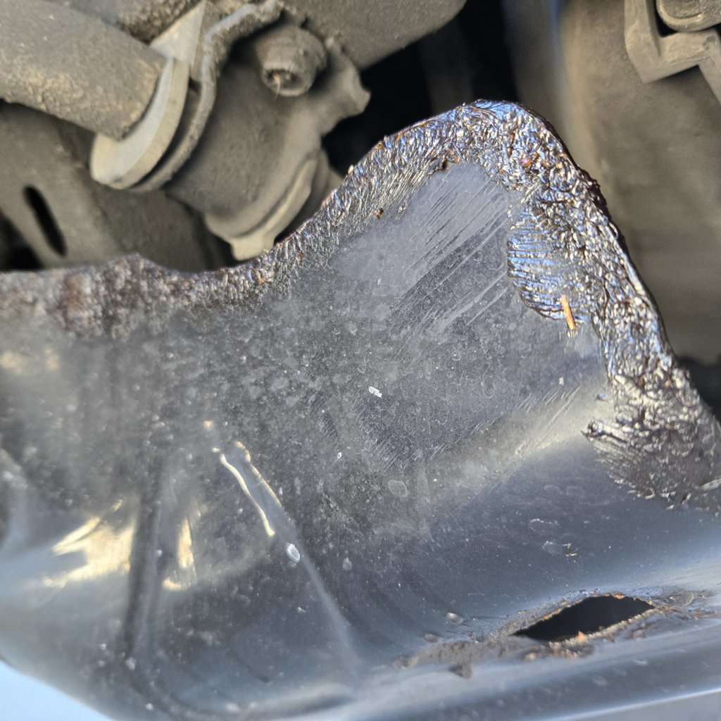

    Did you try the WW HV greasy paste in a bucket you have to literally brush on a very hot sunny day? Or dip your bolts and nuts into before refastening?
    I had issues on a gen2 I look after and a front undercover skid plate with severe rusted bolts and welded nuts that broke off some subframe part by the radiator. I coated the all new parts in that HV grease and other than turning to a liquid from the engine heat that blows off and a mild drip it appears to remain fluid on the bolts and threads so no salt water can penetrative and rott away

    Some pics...
    On the outer edges of new undercover plate

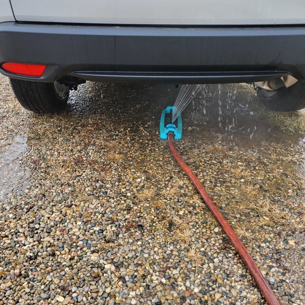

    I'm old and lazy but I hate rust. I do this multiple times a winter when it warms up and 99% of the time I'm in the comfort of my house while letting the vehicle underside rinse itself of salt. The pressure isn't so great that it blasts off the protective FF coating which many pressure washers, especially with a strong soap solution will do.

    fwiw, the WW HV product did not noticeably appear to be drippy like that because to turn it into that fluid of a liquid it pretty much has to be near boiling lol, i put it in a saucepan on the stove for a bit to see how it flows, as soon as removed from the flame it starts to thicken back up
