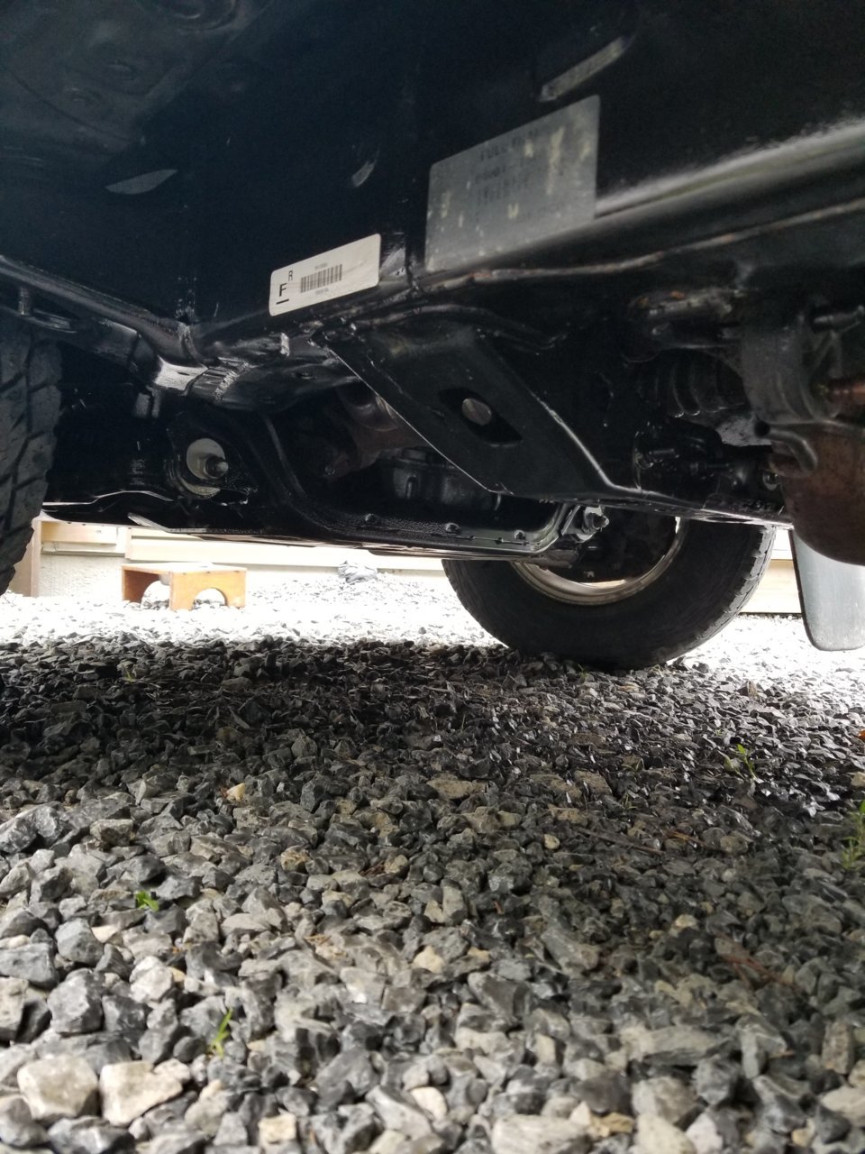

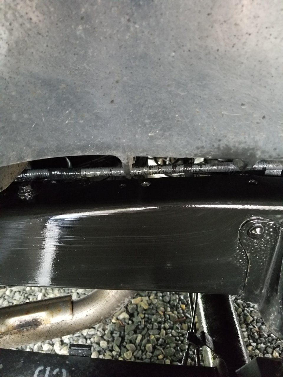

    So just for fun, I picked up two cans of fluid film on my way home today. I applied liberally.. lol the frame was mostly clean, but not spotless. I dont think spraying over a little dust here and there will be an issue. Got everything thing I could reach by just crawling around. This is mostly a test run to see how it sticks/spreads. Surprised me how thick it was, so I just used a paper towel to wipe up some excess. I'm told all the exposed rubber under new vehicles is oil resistant and shouldn't be affected by any over spray. 20180531_160844.jpg 20180531_160907.jpg 20180531_160844.jpg 20180531_160907.jpg

    A little dirty won't be a problem, it will encapsulate that. Leave it all on, won't hurt plastic or rubber. It is basically paraffin wax and linseed oil.

    Don’t worry about the rubber parts, there’s no petroleum in FF. It’s lanolin based.

    Eventually it will wear off,along with the grime,sand or whatever sticks to it. Thats why it’s not a one time application. Areas that get a lot of road spray from the tires will wear even quicker.

    I sprayed the undercarriage of my truck a few weeks back. Impressed so far how well it has stuck (even after multiple rains and a few car washes), and the shine it gives makes the frame and components look new.
