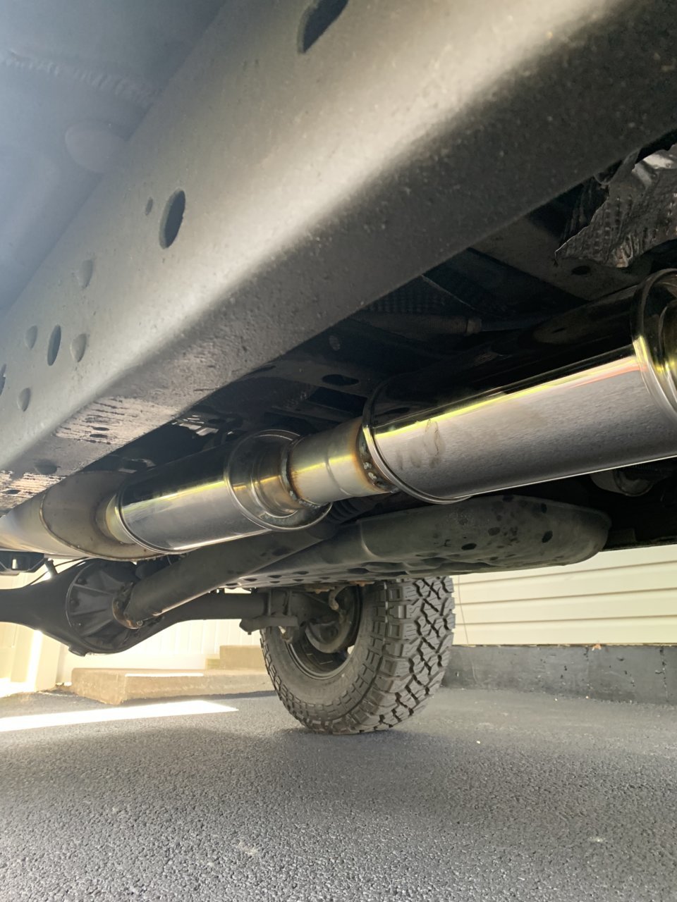

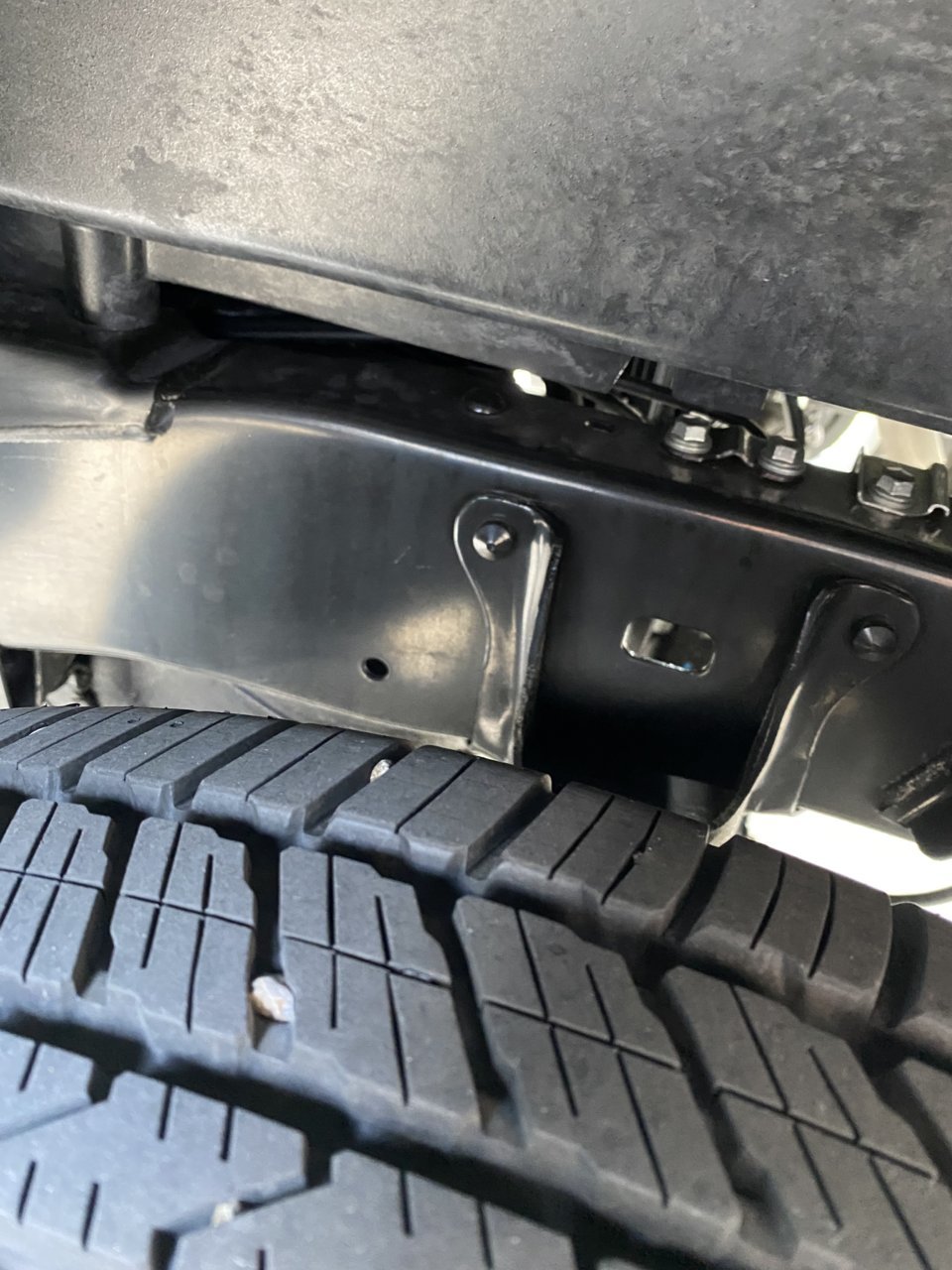

    The greasy tanish color goes away with time, these pics are 2 weeks apart.

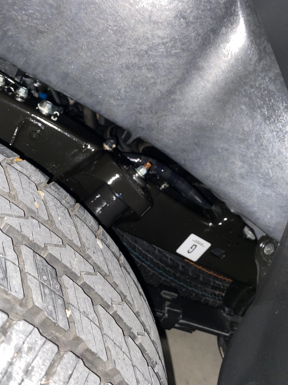

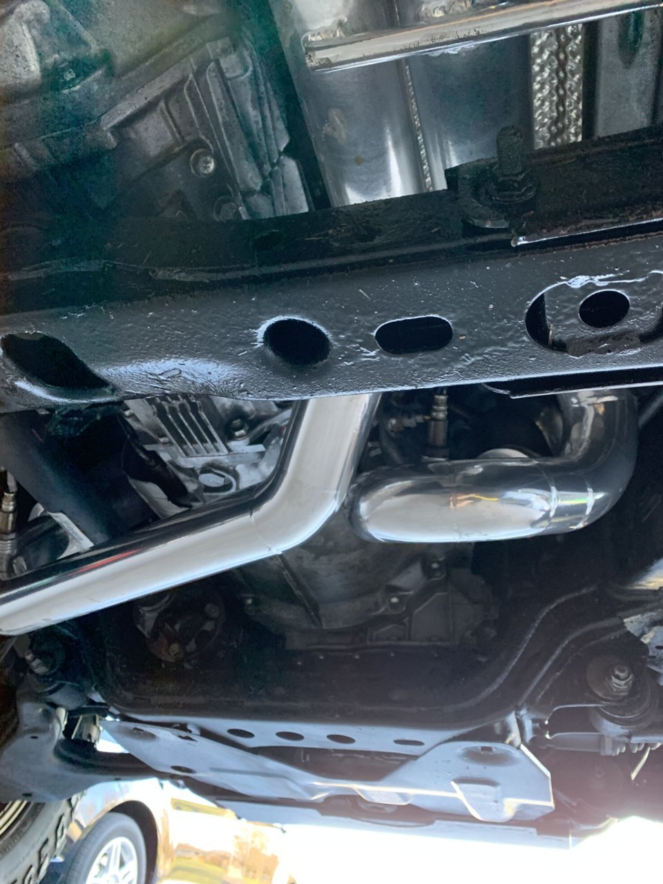

    First time I used fluid film I did 6 cans. Since then I do 3-4 cans. I do it every fall in October or November but definitely before the first snow. I live in the Midwest and we use a lot of salt. It stinks because of the lanolin but I don’t care because the pros outweigh the cons. I spray it on everything except my brakes and exhaust. I believe my pics speak for themselves.

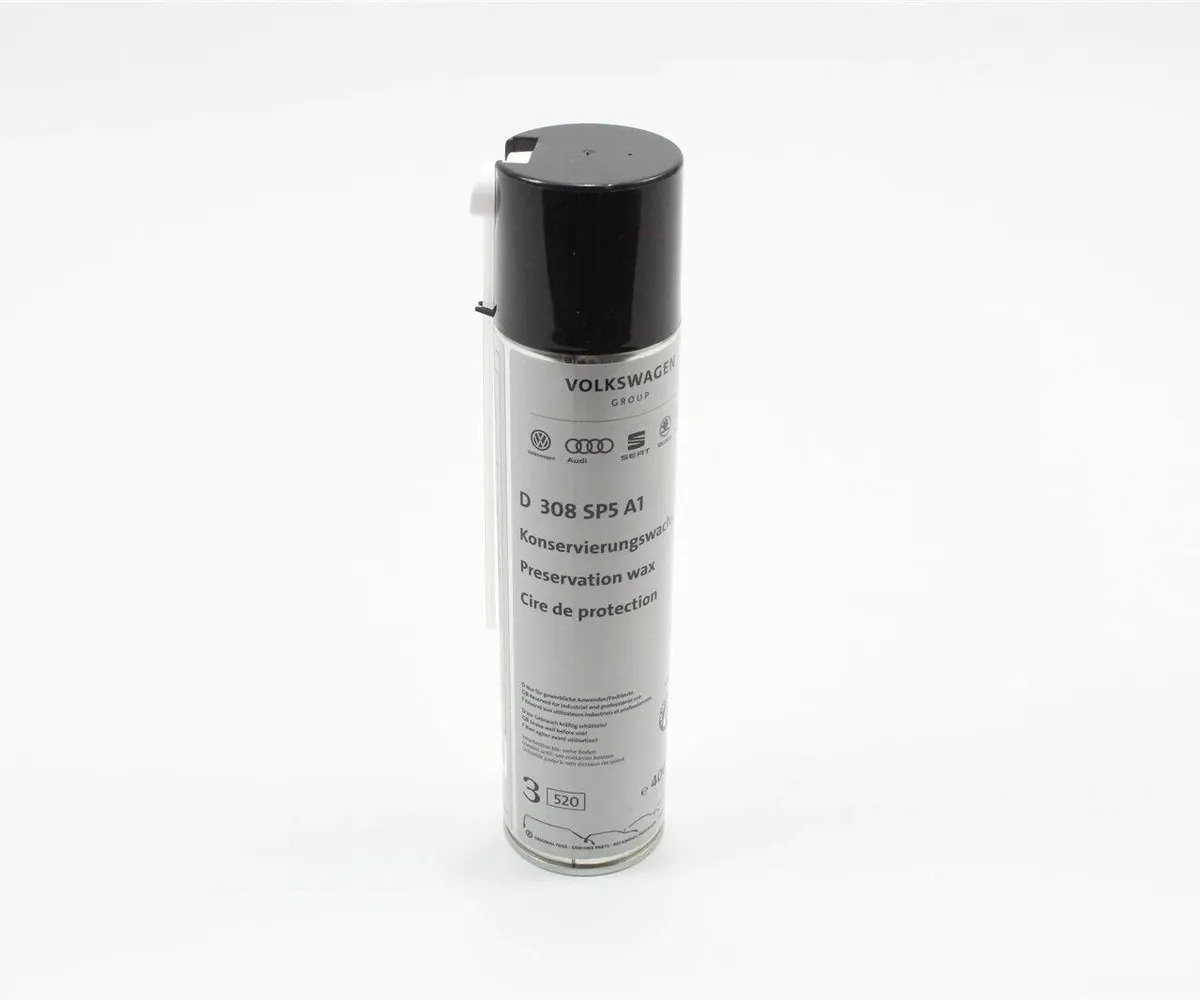

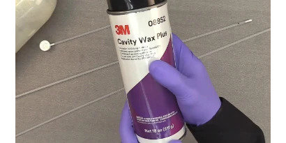

    has anyone figured out what German cars use
    Maybe 3M cavity wax
    in my experience,
    -only high heat over a long time makes it drip off
    -it does a good job protecting corrosion
    -it’s clear, thick, and dries. So it does not collect dirt, get you dirty, or make wrenching dirty
    fluid film in theory is good. But in use,
    -it doesn’t last that long
    -it emits a lot of fumes and smells like piss
    -it stays wet and collects dirt, so touching your truck for a short amount of time to do minor work on it means your whole arm turns black in about 5 seconds
    I’d think if German brands, who are proud of their 12yr anti corrosion perforation warranties that actually work and don’t have as much problem with rust -
    If they found Fluid Film good they’d be using it….
