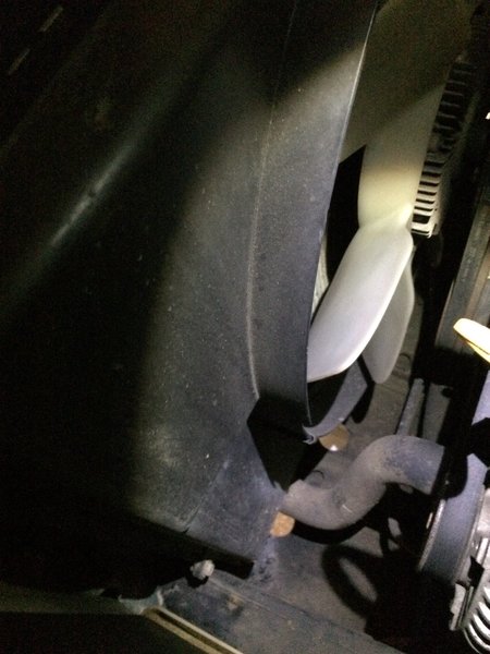

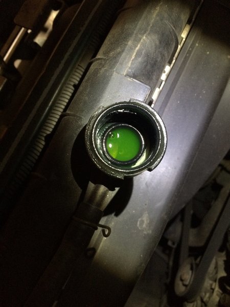

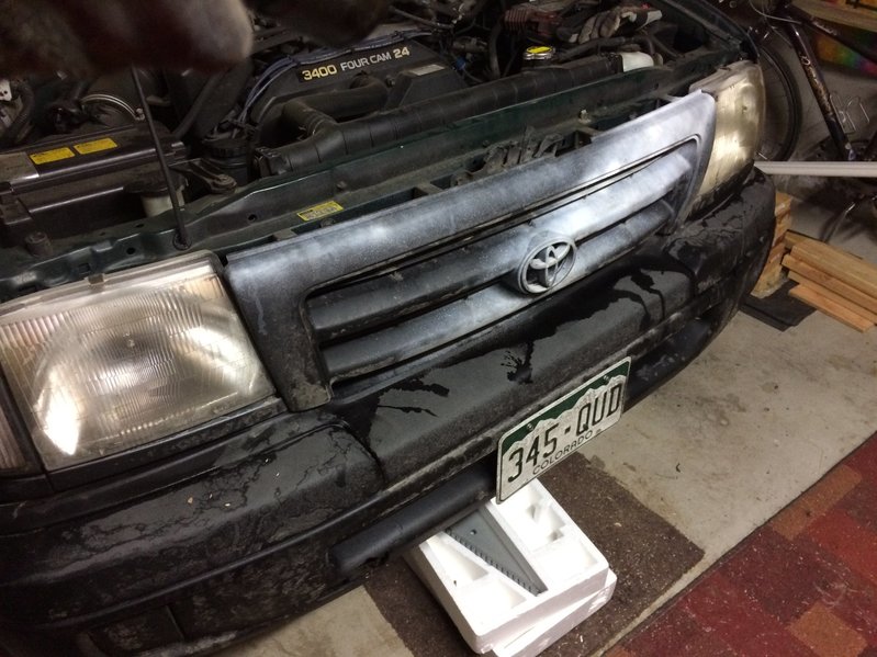

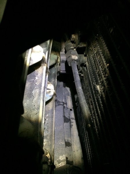

    Last night after unloading 1/2 ton of gravel when I pulled in the garage I noticed fluid all over the top of the front bumper. It appears to be coming from under the grill and I suspect a leak in hoses/clamps on the front passenger side of the radiator. I've only noticed this one other time (last week after driving ~30 miles on the interstate, but didn't mind it much since the roads were somewhat wet from recent snowmelt), but not the other day after a quick trip to the local home depot. Truck hasn't been running hot, coolant levels seem ok, I haven't noticed any coolant burning and wasn't really able to tell the color/smell/flavor of the fluid on the bumper. I have yet to pull the grill off to really dig in, and get better pictures, but it looks like the leak is maybe coming from the hoses/clamps connected to the small pump/resevoir (?) on the front passenger side of the radiator. The radiator itself didn't appear wet and I didn't see any other wet spots inside the engine bay or along the backside of the radiator. Any hypothesis are helpful, thanks. Could it at all possibly be condensation (crazy i know) from our large temperature swings lately?

    I'll be pulling off the grill this evening after dinner to inspect further.
