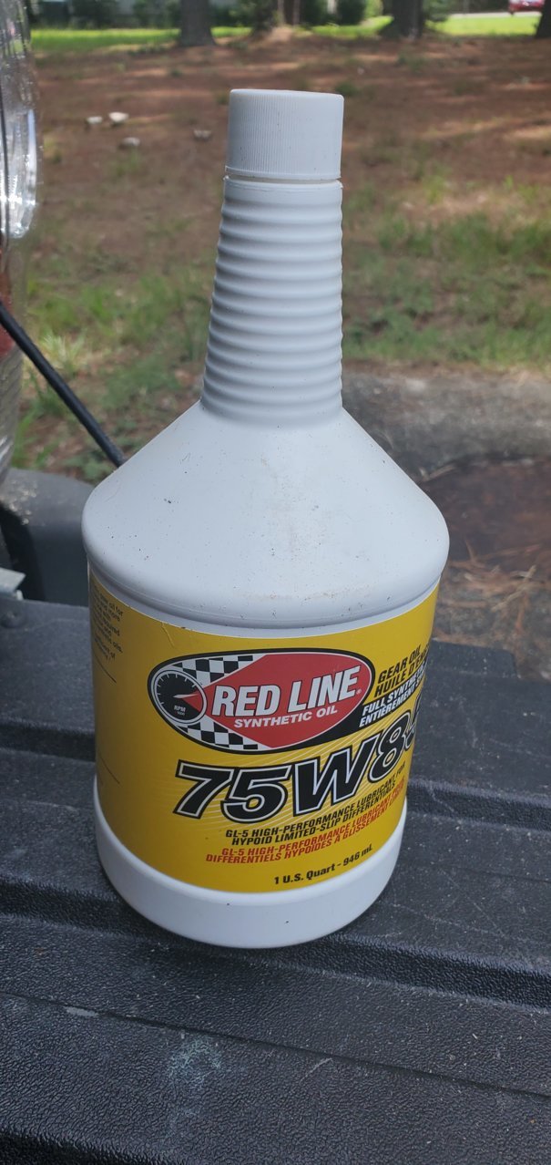

    anyone have any
    good hand pump suggestions for the quart size redline gear oil bottles. Ive got a few different kinds but none of them fit well. I thought about trying to get empty clean gallon sized and transfer my quart sized to that?
    Also is it a big deal to use same pump for different oils (ie diff fluid the transfer case then manual transmission oil)? I know there isn't that much residual but still.

    I use the slippery Pete pump off Amazon with the redline gallon jugs. I bought one for each weight. Yes it’s probably overkill and I have excess oil sitting in my garage, but it’s much easier and cleaner. I gave up on qt bottles, they just aren’t easy to work with. The slipper Pete pumps do a good job of getting most of the oil out of the jugs too.

    Yes, I have that fluid pump (doesn't fit well on quart) as well but unfortunately I already have all of my oil in quart bottles not the big ones. Next time I'll definitely go with the gallon jugs. I am with you though as in having different pumps for different weights... overkill as well probably.
    Hoping someone has a good solution figured out for the quart sized redline.

    I wasn't paying close attention and got a fluid pump for a gallon jug instead of the quart. I wasn't in a position to go out and get a gallon, or find a pump that fit.
    So I cut the threaded top off the fluid pump, cut a hole in the lid of the quart bottle, and pressure fit it to the pump mechanism. Wasn't the prettiest, but it worked as good as a hand pump can.

    Pick up some 5/16 clear vinyl tubing. Drill 2 5/16 holes into the cap. Push clear bundle tubing in all the way to the bottom of the container. Compress air goes into the other hole. I do 10 PSI and it will only take a few seconds to drain a quart

    This is the one I bought & used a few times. It’s nice that it has the odd double cap so it fits 2 different size bottles. Never fails, doesn’t fit the bottles you got. Luckily I had some bottles it did fit. Made a mess transferring even with a funnel. Pump away, bottle gets a suction & won’t pump. Unscrew some, try to pump, unscrew more and more and more, now it pumps, the bottom slips out and makes another mess. I think it took about 70 pumps to get a quart pumped. My attempt to not make a mess using half and full sheet pans helped a little but I still smelled like gear oil after.

    I have to change the oil on my Tacoma soon so I plan to save one of the empty quart oil bottles then clean it out very well. Then when I change my differential gear lube, I will just pour the Redline gear lube into the oil quart bottle and use the pump on that bottle. Easy solution.
