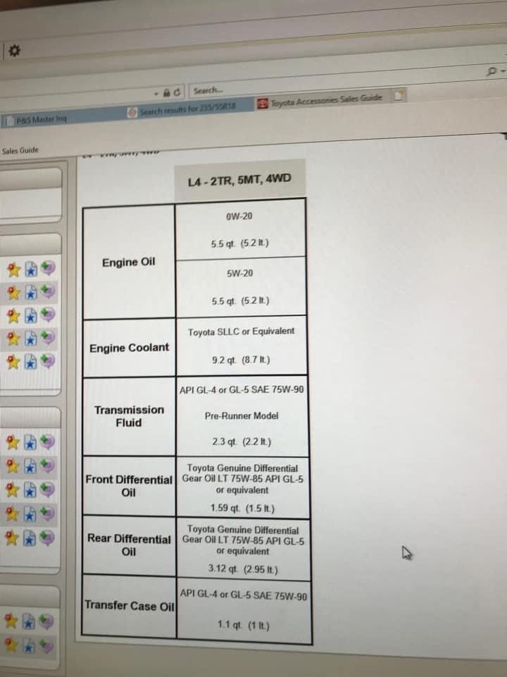

    I noticed in the chart, it recommended gl4 or gl5 for transmission oil, whats the difference please?
    Also for differential GL5
    This is an 06 tacoma manual transmission 238k miles, 4cyl, 4x2, rear differential.
    i am going to replace all the fluids and will be putting synthetic oil on the engine, regular mileage, not high mileage.
    Any specific recommendations i can use? The best of the best, no matter the price for manual transmission oil, rear differential? Do they sale trany and differential oil synthetic? Any better?

    The best “exact recommendations” are the ones in the owners manual.
    All the other recommendations you get are opinions.
    I don’t give my opinion on this subject any longer.
    Pick one, pour it in.

    Technically yes, but the gear oil is wild expensive and unnecessary. I work at Toyota and wouldn't use their gear oil.
    gl4 for trans gl5 for the tcase, and diffs.

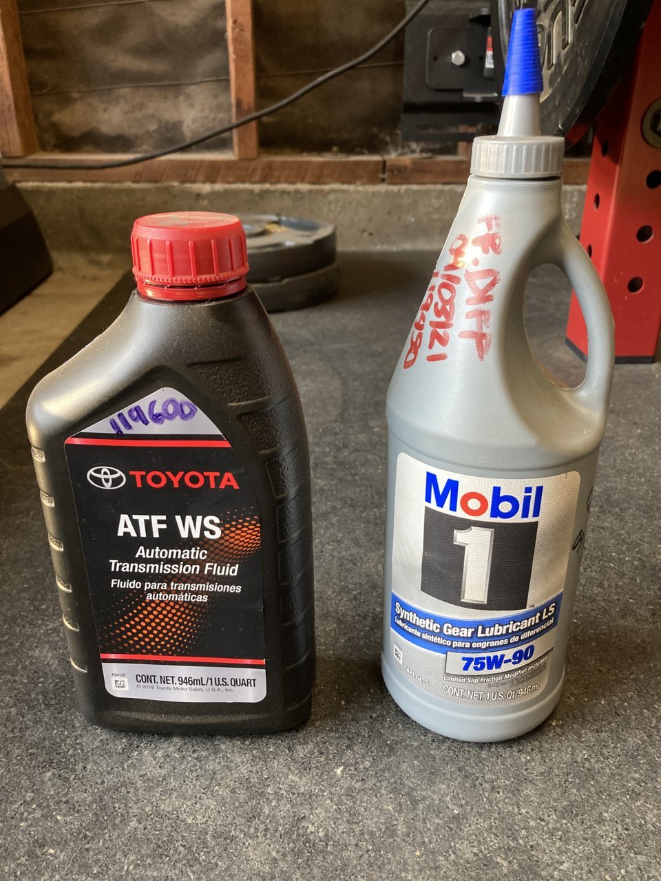

    The one on the left for transmission and the one on the right for diff’s and transfer case. My truck it’s automatic, so I’m not sure about your transmission oil.

    WS is for A750 5 speed automatic transmissions only, the OP has the R155 5 speed manual transmission which takes 75W-90 GL4 Gear oil.
    Ricardo13x[QUOTED] likes this.
