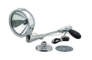

    NOT flush-mounted and maybe a bit too old school for you kids...

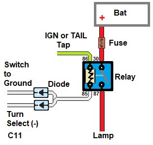

    I am going to use Diode Dynamics SSC1s for that. The SAE Fog ones. Those are a little brighter than the pros I am told. I went with the fog pattern so that I can keep them aimed appropriately and not blind people. I am not sure how the wide beam pattern from BD compares, but it is something to think about. The part where they come on with the turn signals isn't too hard to do, and you can still retain your switch option (I think, I just glanced at your switch panel, didn't read much). But if you relay is high side (+) switched, you could change the turn signal from a low side (-) to a high side with a relay. Of course, you probably have them wired to the same relay.... Hmm, that might make it more difficult. Sorry, I am thinking "out loud" as I type this. I guess you could do it where either turn signal triggers both lights, or get creative with some 3A diodes and a couple additional relays to have each side controlled by its respective turn signal. That would negate the need to convert from low to high side switching. I am sure @caribe makaira already has a diagram drawn up for it :rofl:
    Now, if you really want to get crazy, you can do something like this: Have the cornering lights controlled by the turn signal, as well as the Meso shifter buttons which will also control the ditch light and the side facing roof lights (as an option) on their respective sides. Or sub that for the side mounted lights in your case. Also retaining individual switching options for those as well. It gets... complex, but it will be nice to have that degree of control I think :D

    For turn signals, is there a constant signal somewhere when activated? Or would we need to build/buy a little logic circuit with a timer for a constant signal once the first blink happened?

    There is a constant signal in the stalk switch. It is a ground signal though. But using a timer would be a good solution too. These ones come in 5A or 10A, and can be programmed easily enough. Multi Functional Timers The nice thing about that for a solution is it could all be done under the hood, and the timer doubles as a relay.

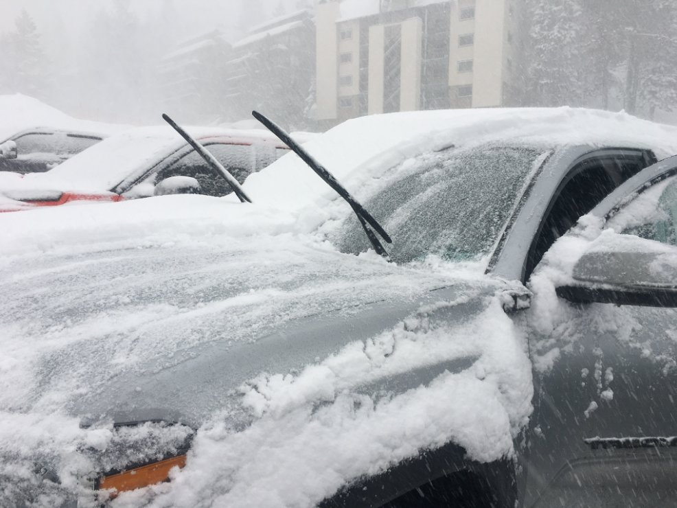

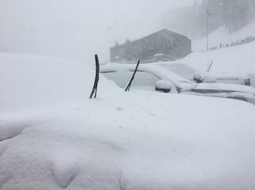

    This is just what accumulated on my Taco while I was skiing yesterday:
    This is just a few inches of heavy snow. I've had to clear off a foot or more. An A-pillar light is right in the channel where I drag all of the snow off the windshield.

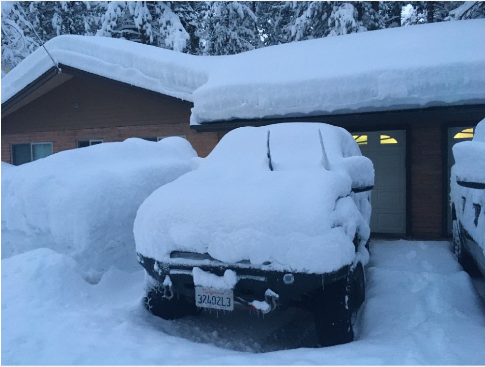

    And this is what I woke up to this morning:
    Which is why I don't want lights on A-pillar mounts or lights that are mounted on the end of brackets in general. Flush mounted lights won't trap snow between the light and what they are mounted to.
